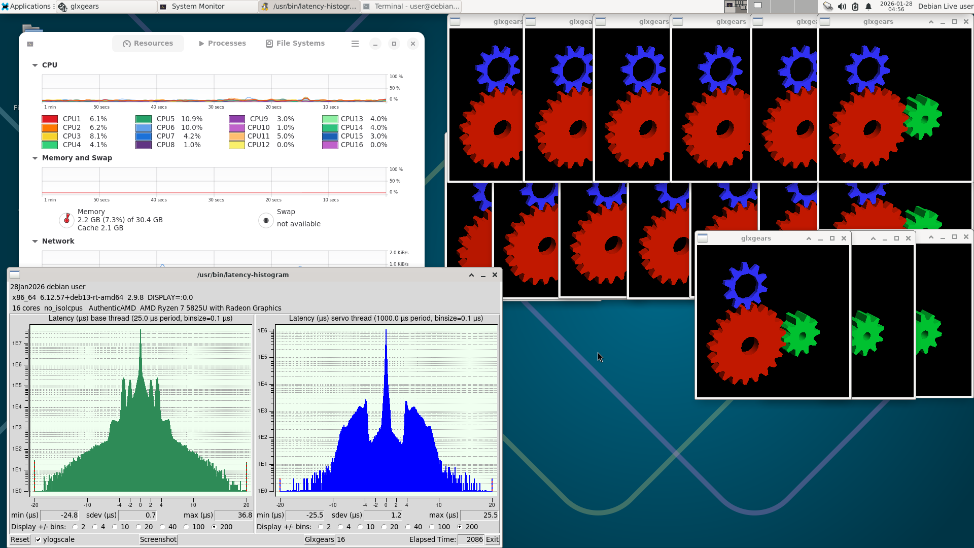

28 Jan 2026 05:00 #342062
by NWE
Replied by NWE on topic Mini PC for LinuxCNC/CPU Realtime Performance
Here it is. This is on a live boot without trying any latency optimization stuff. While this was running, I installed some software and ran glxgears.
