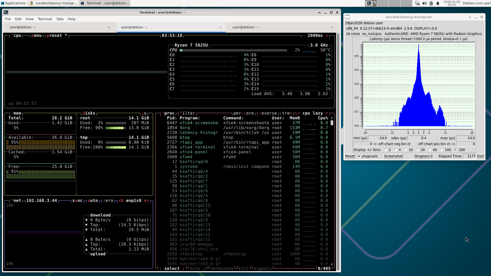

@NVE,
can you do the latency test with no base period and with added --show at the end as there are excursions on both periods on your screenshot, and base period is not used for Mesa boards.
Thank you.
Thank you.

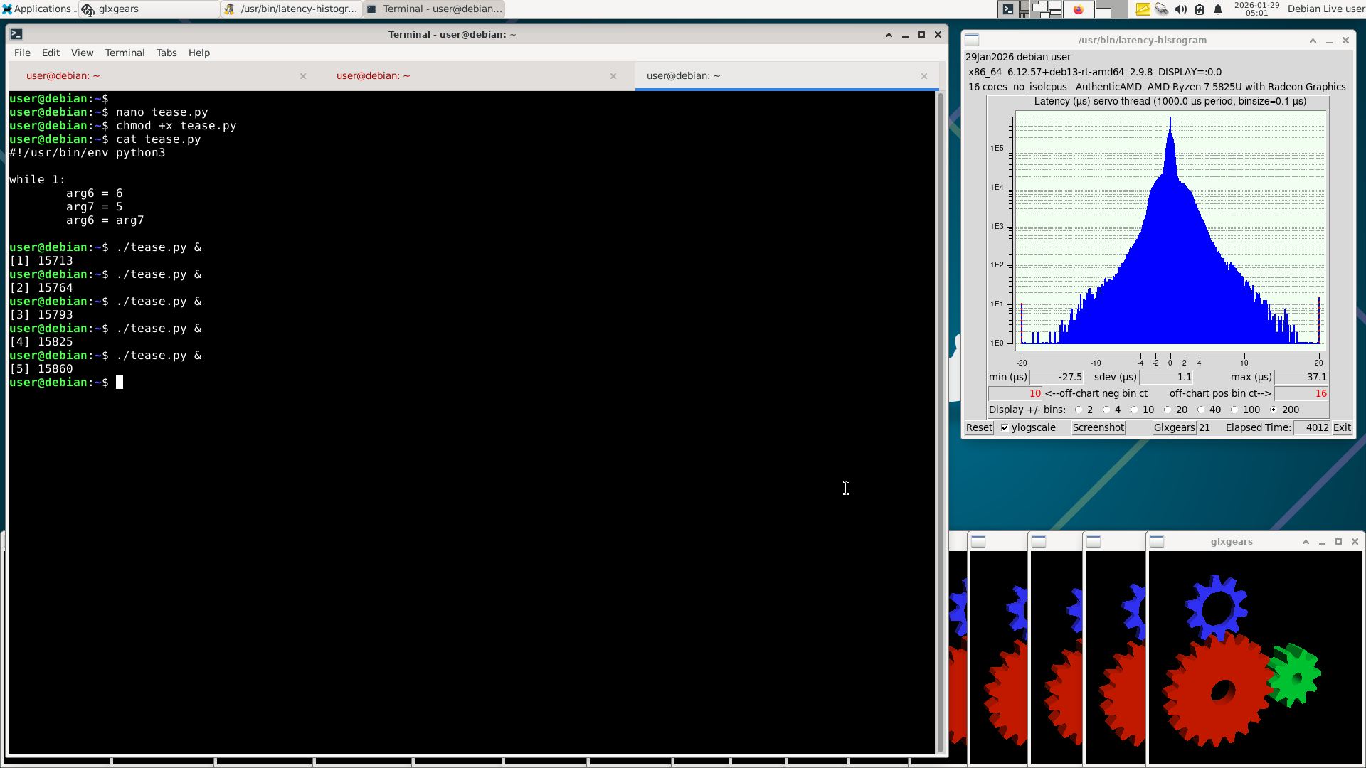

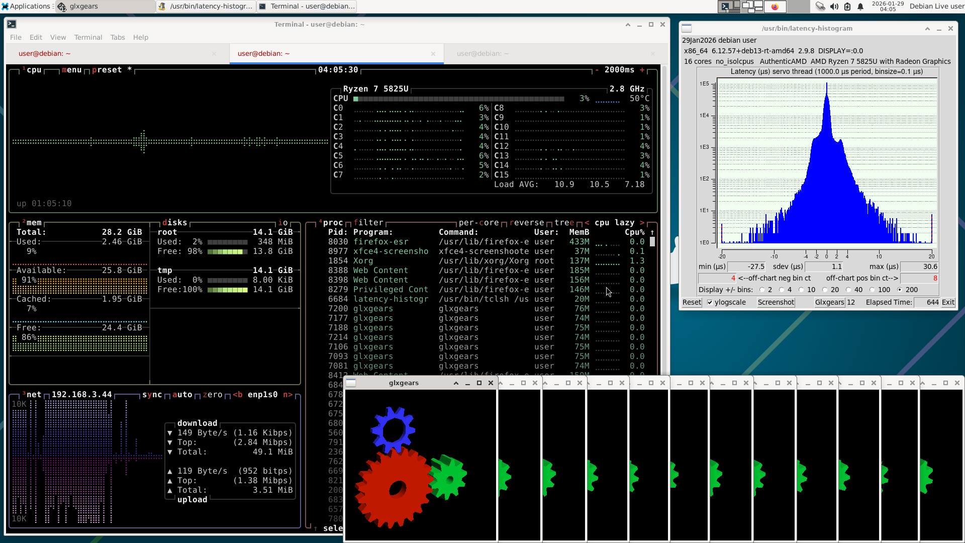

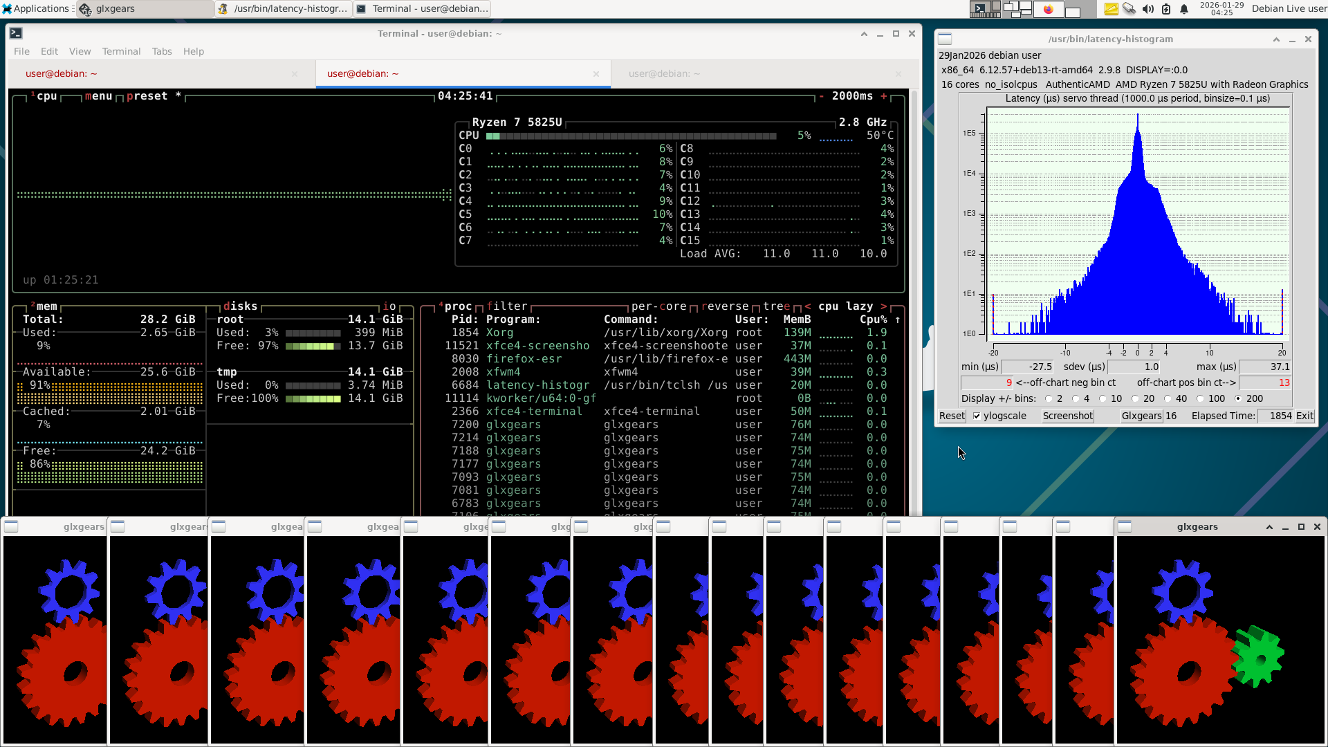

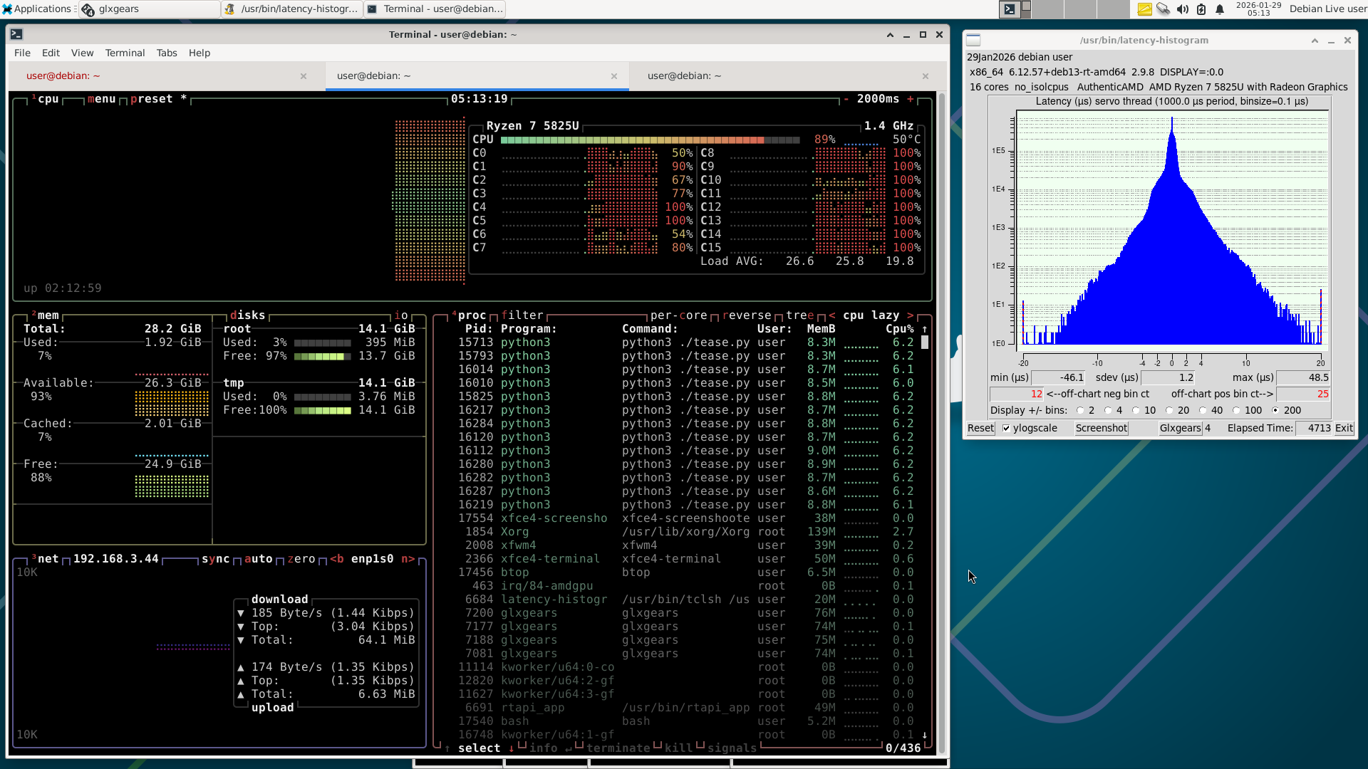

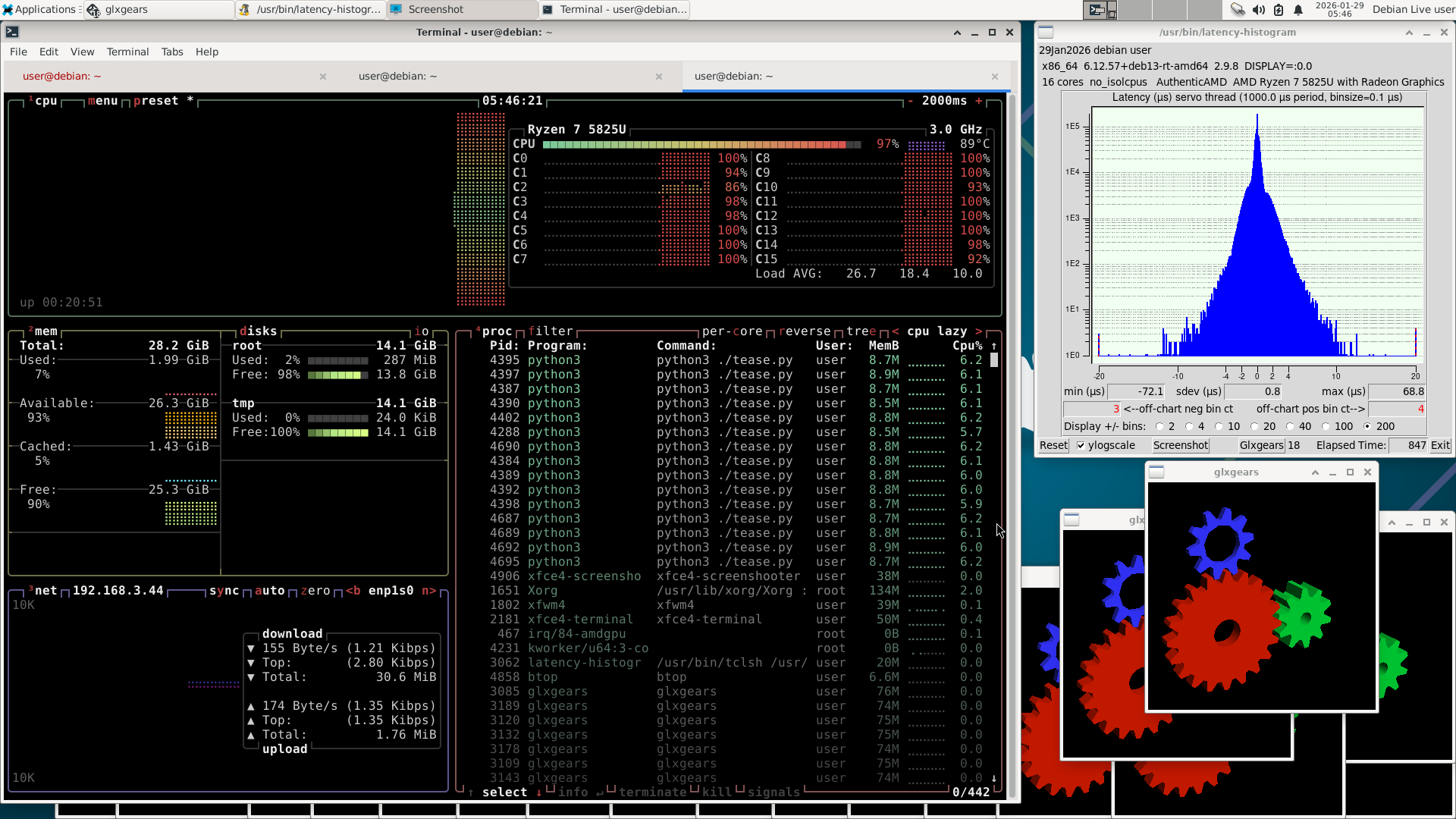

More screenshots; for the first run I left it running for a bit without teasing it much. Then I restarted the test and let it run a bit, occationally taking a screenshot, then opening more apps.
Wow, I just noticed the load average numbers in btop. I was noticing how glxgears is not showing a lot of cpu usage, now I notice it showing up in the load average. I will go back and find out what it takes to bump that load average over 16! I will post it.
When I'm building something like LinuxCNC from source I make sure I have the build terminal and btop open so I can watch it rip! Especially on the 10yr old server with two Xeon 14 core CPU's = 56 threads.

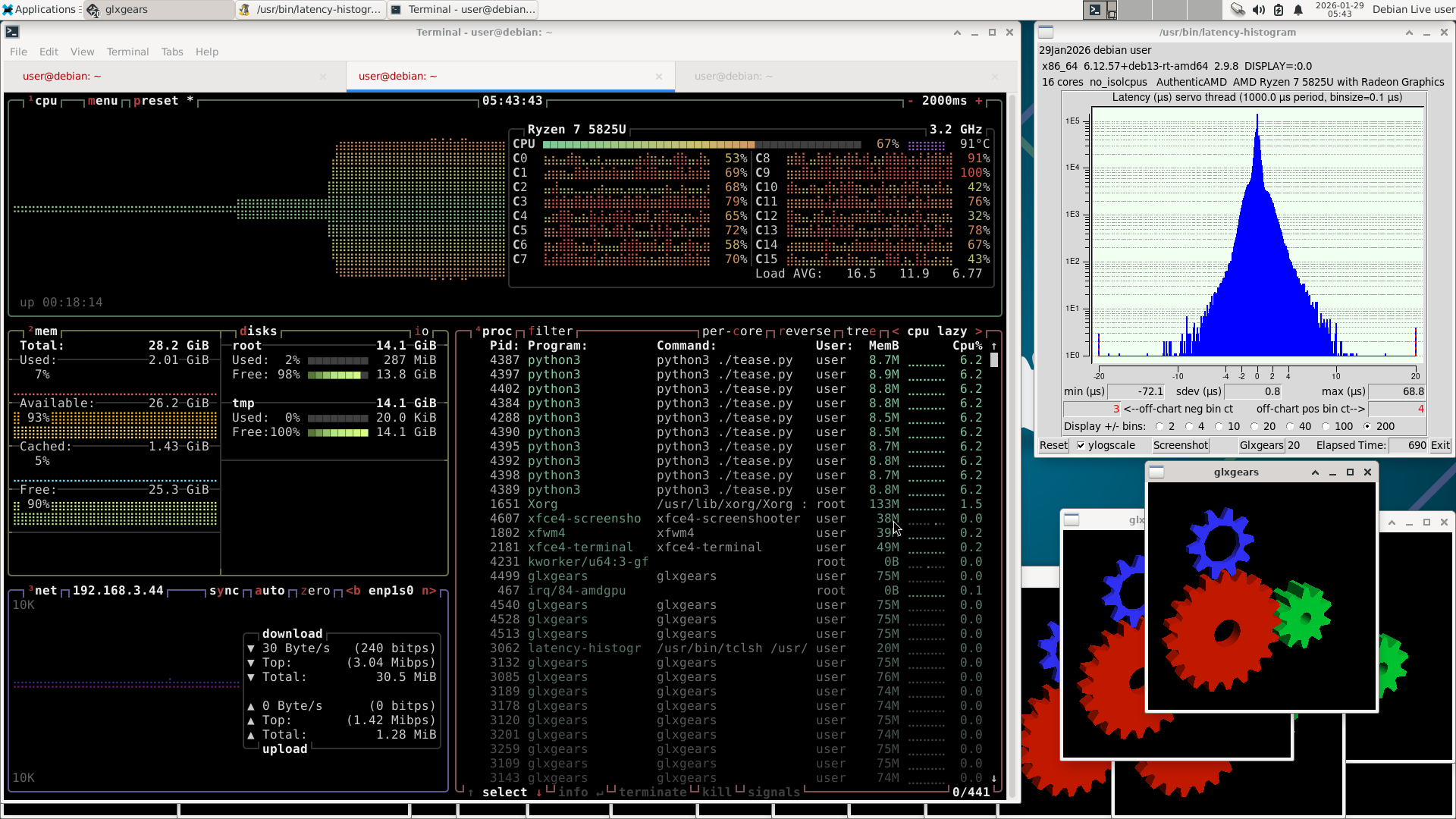

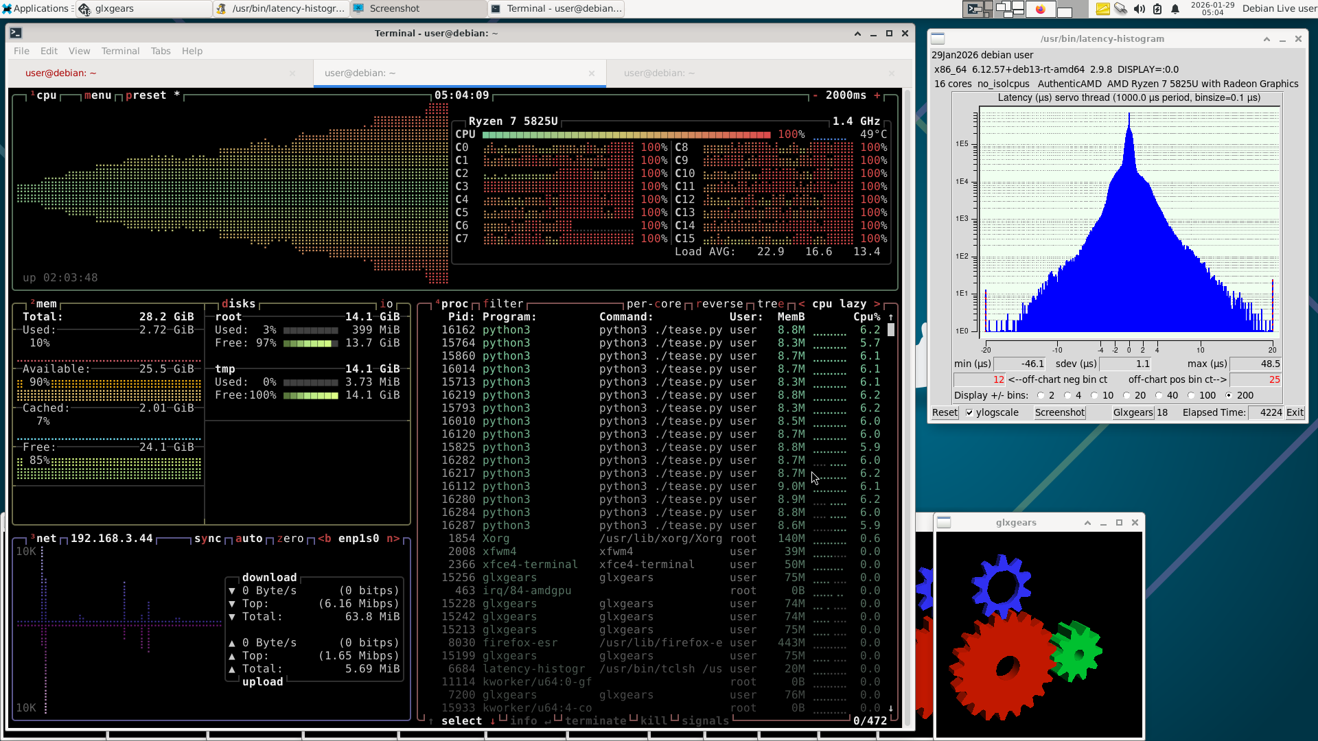

Now it's bogging down. Toward the end I had to close some stuff so I could get screenshot to open. Boy, this thing is really throttling down.
Oh No! now I remember, a bit ago I was running this thing on a power tool battery+inverter , so I had changed the power limit in bios as low as it can be set! I will try one more time.

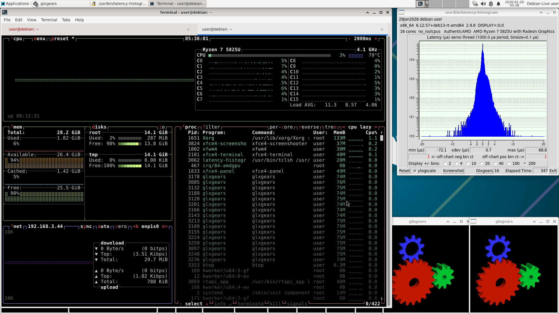

I like this better. I went in the bios and changed cpu power limit back from 10W to the default 35W "performance" setting.
