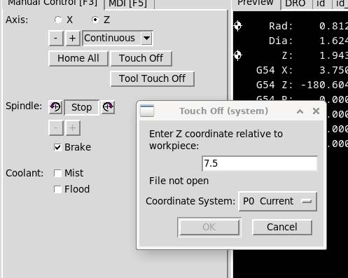

Touch off don`t work "file not open"

Replied by andypugh on topic Touch off don`t work "file not open"
If you start LinuxCNC from the command line (just type "linuxnc" do you see any mention of not being able to find the tool table (or possibly vars file) in the output?

28 Jul 2025 11:40 #332467
by dredivan
Replied by dredivan on topic Touch off don`t work "file not open"
no any errors.
it`s clean config for Lathe, generated by PNCCONFIG

30 Jul 2025 14:56 #332560
Which LinuxCNC version? Not that it probably matters as I don't see much difference in this area.
I think that the dialog box is created here:
github.com/LinuxCNC/linuxcnc/blob/master...cripts/axis.py#L1643
With some TkInter stuff in the backgorund that I don't really understand.
But, I don't see where "file not open" comes from. There isn't normally anything in that area of the dialog, I don't think? (unless you know better?) so I can't even find a hint of which file isn't open.

30 Jul 2025 16:46 #332564
Replied by Aciera on topic Touch off don`t work "file not open"
I did try to follow the trail:
The error string displayed in the pop up comes from here:
github.com/LinuxCNC/linuxcnc/blob/master...cripts/axis.py#L1715
which calls
github.com/LinuxCNC/linuxcnc/blob/master...cripts/axis.py#L1579
The actual error is returned from 'gcode.strerror(result)' which seems to be this c++ function:
github.com/LinuxCNC/linuxcnc/blob/master.../gcodemodule.cc#L964
Why a user entry for a float value would be passed through all of that, I have no idea.
which calls

31 Jul 2025 11:30 #332592
I have used it for simple things like 1234.5 / 2 but it also allows functions like SIN / COS / PI (?) and from looking at the code I think you can probably use the numeric parameters in the .vars file.
So, in this case the error seems to be caused by not finding the PARAMETER_FILE.
OP: does that entry appear in your INI? And does the referenced file exist? (and who does it belong to?)
linuxcnc.org/docs/stable/html/config/ini...sub:ini:sec:rs274ngc
That part I can explain. Axis allows you to enter any valid G-code expression (apparently including parameters) in the numeric entry box.Why a user entry for a float value would be passed through all of that, I have no idea.

01 Aug 2025 11:25 - 01 Aug 2025 11:39 #332622
by dredivan
I use clean configuration created by PNCCONF.
My linuxcnc version is 2.10
If I don't enter anything from the keyboard and just press the OK button in the window, the coordinates are reset.
but if I enter any number, the option to confirm with the OK button disappears.
After I click the OK button, I open the linuxcnc.var file and see that the values have been writtenBut if I enter any number from the keyboard, the option to confirm disappears, and I see the inscription "File not open"
[RS274NGC]
PARAMETER_FILE = linuxcnc.var
5221 37.000000
5222 0.000000
5223 -10.443750
linuxcnc.var
user@7i96s:~$ ls -l /home/user/linuxcnc/configs/lathe/linuxcnc.var -rw-r--r-- 1 user user 1669 сер 1 14:32 /home/user/linuxcnc/configs/lathe/linuxcnc.var
user@7i96s:~$

- Posts: 19902
03 Aug 2025 18:45 #332745
As an experiment, is it all OK until you enter a decimal separator?
Do you definitely have a linuxcnc.var file in the config directory (ie the directory that the INI file is in?)
If you "ls -al" the config folder, do all the files belong to the same user?
There is something funny going on here, and it's not something we have seen before.

04 Aug 2025 11:10 #332809
by dredivan
I did a clean install with Linux_Mint_22.1_LinuxCNC_2.10.iso
and now this problem is gone
Befor I did install clean debian 12 and linuxcnc 2.10
