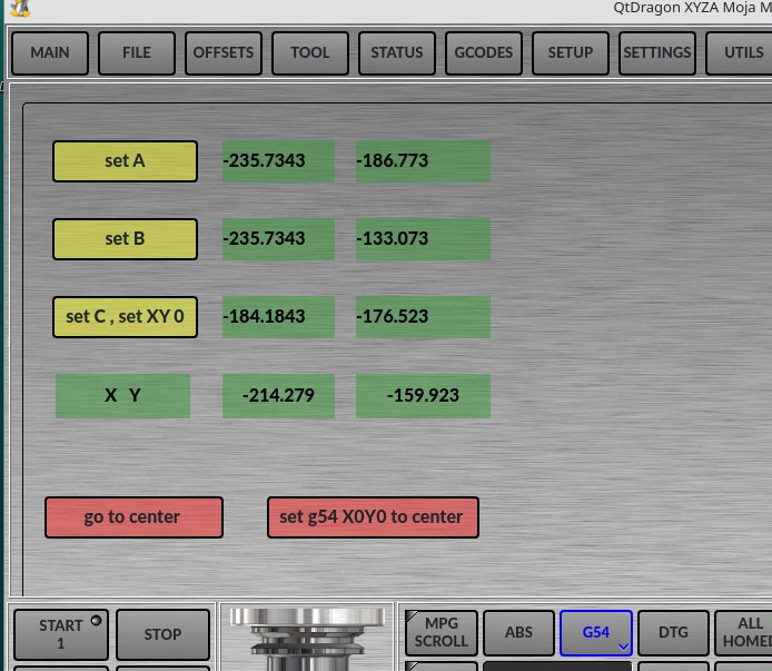

- MarkoPolo
- Posts: 320
- Thank you received: 91
31 Aug 2025 17:07 #334204
by MarkoPolo
Replied by MarkoPolo on topic Simple/Manual Centre Finder
The following user(s) said Thank You: Waldemar

Nice work. Yeah, I'm on Axis - 2.8.4 although I'd be happy to hear about your method to set this up.
Have spent a few hours going around in circles trying to get Chat GPT to point me in the right direction. Managed to get a custom tab set up but that's about it - buttons proved problematic for one reason or another. I'll probably wait until I upgrade to 2.9 to try again but that might be a while. Spreadsheet for now..!
*Not my formulas - I found 'em squirrelled away on a Microsoft forum page.

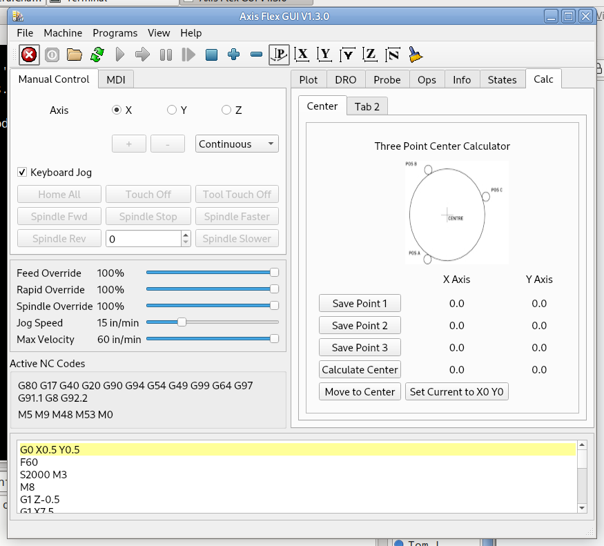

01 Sep 2025 09:52 #334232
by JT
Replied by JT on topic Simple/Manual Centre Finder
- JT
- Posts: 1123
- Thank you received: 616
01 Sep 2025 10:37 - 01 Sep 2025 10:38 #334234
by JT
Actually I'm going to add that to the Flex calculators so all you need to do is drag a container into the GUI and give it the proper name. You can't get much more flexible than that. I'll also add a go to center button.
JT
JT

- Posts: 1123
01 Sep 2025 14:01 #334237
by JT

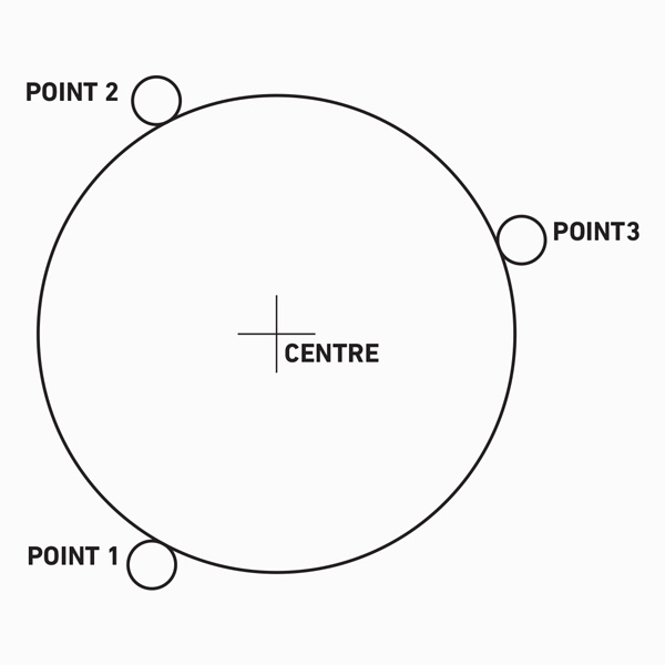

Great work JT. Looks ace. I can't see myself going over to Flex GUI - my 2.8.4 install is super stable and I'm one of those 'if it ain't broke...' guys (my mini mill runs an ancient version of LinuxCNC and has been for the last 11 years or so...) I'm about to install 2.9.2 on a spare stand alone PC to have a play with GladeVCP, so may try out Flex GUI on that machine once I've figured out I can't get anything to work in Glade...
Hey, if you need an image file that integrates better into your tab I'm attaching one here (says POINT 1 instead of POS A etc. is 1:1 ratio and the background colour should match your tab's bg colour).

01 Sep 2025 17:49 #334245
by JT
The cool thing about Flex is you don't need to program anything, the center calculator is built in now. Glade is very old and might not work well with new OS's while Flex is based on PyQt6 and is the only gui to use PyQt6 the rest of Qt gui's use PyQt5 which is at EOL.
And I'm from the same old school as you if it ain't broke don't fix it... my Hardinge CHNC runs on Ubuntu 10 with EMC 2.7 so it's 15 years old and works fine.
JT
