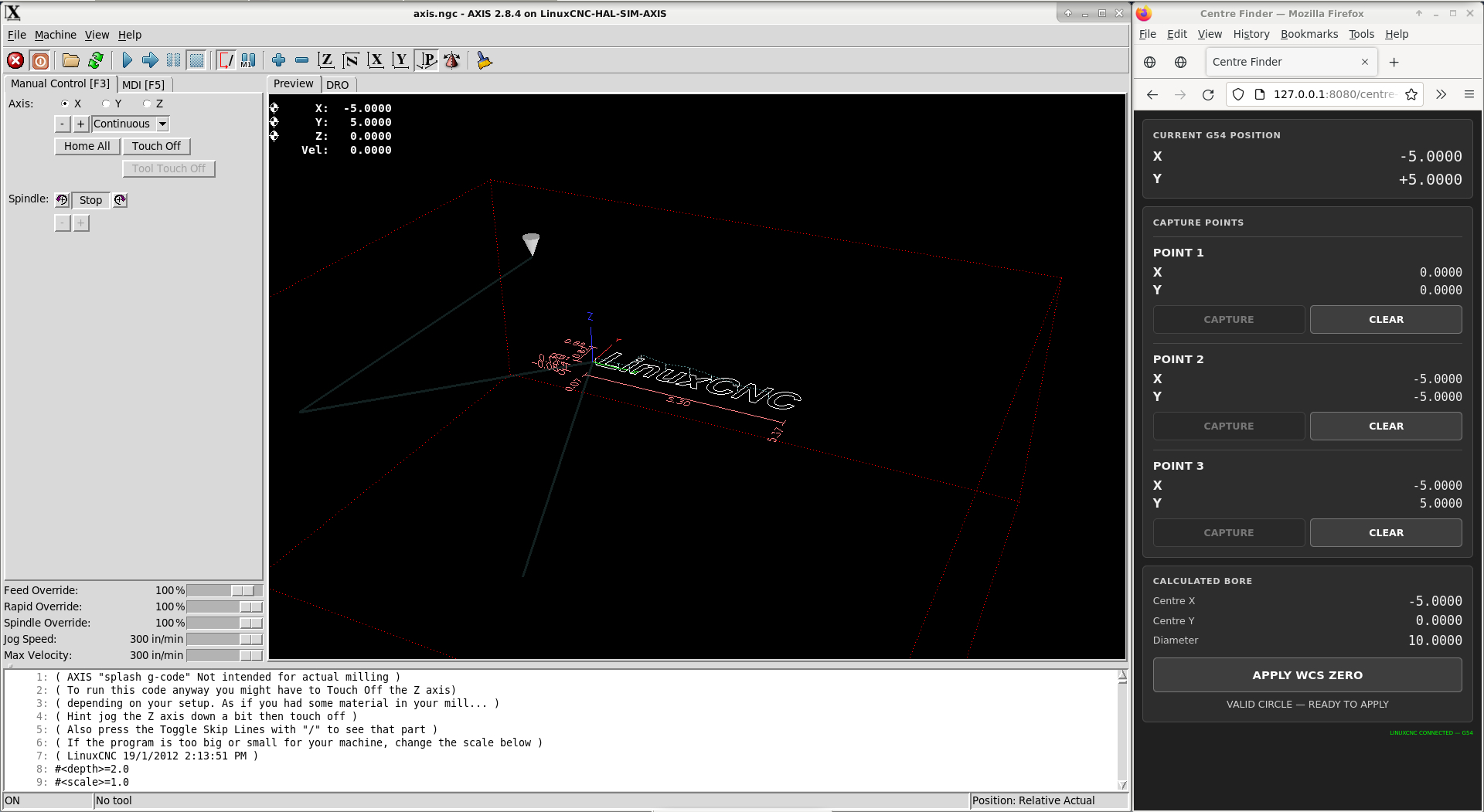

I went back to this recently and looked into an alternative approach. I simply don't have the knowledge (or courage!) to directly poke about with LinuxCNC, potentially breaking things as I go... Anyway, this approach is browser based and uses a small Python bridging app, which (of course) ChatGPT wrote. I'll attach the relevant files below. To use them:
With LinuxCNC running, open a terminal in the directory containing the files and run python centre-finder.py, then open http://127.0.0.1:8080/centre-finder.html in Firefox.
The UI is pretty chonky, but I'll see about thinning it down in time.
Manually jog the tool to three points on the bore/cylinder, hit CAPTURE at each one, and it calculates the circle centre and sets the active WCS XY zero to that point. It doesn't move the machine — it's essentially a convenient operator interface sitting on top of LinuxCNC's Python interface. Currently working on 2.8.x/Python 2.7, with an eventual possibility of adding a horizontal electrical probe.
Once done and Firefox is closed, the Python server simply remains idle in the background waiting for another HTTP request; it does not generate motion or continuously interact with the LinuxCNC motion system, so it should have no meaningful effect on machine motion or step generation.
HOW IT WORKS:
The command the Python bridge sends to LinuxCNC is:
G10 L2 P0 X... Y...
Specifically, it constructs it as:
COMMAND.mdi("G10 L2 P0 X%.12f Y%.12f" % (new_wcs_x, new_wcs_y))
The important bit is P0: P0 means the currently active coordinate system. So if you're in G54, it writes G54. If you're in G55, it writes G55, etc.
COMPATIBILITY:
Developed and tested on LinuxCNC 2.8.x / Python 2.7. The browser interface is deliberately lightweight and the WCS write uses the standard LinuxCNC G10 L2 P0 command, so the underlying approach should be familiar across LinuxCNC versions. However, the Python bridge uses the LinuxCNC Python API and may need minor changes on significantly older/newer installations. Test in a SIM configuration before using it on a machine.
It is intended to set the active WCS XY offset; it does not move the machine.
Disclaimer: I've developed and tested this on a LinuxCNC 2.8.4 HAL SIM configuration and satisfied myself that the three-point calculation, active-WCS update and general workflow behave as intended. That said, this is very much a "use at your own risk" utility — please test it on your own configuration/SIM and verify the resulting coordinates before trusting it on a real machine. I accept no responsibility for damage to the machine, tooling or workpiece.

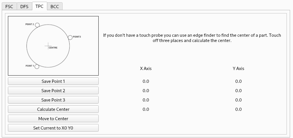

- Posts: 7368
- Thank you received: 2181
29 Aug 2026 20:25 #349134
Replied by cmorley on topic Simple/Manual Centre Finder
If your willing to donate the code, I'll add it to linuxcnc.I used your formulas for calculating the center of a circle and created a widget for qtdragon that does it.
(There's also a Python function that calculates the center from three coordinates.)
You're using axis, so it probably won't be useful to you.
