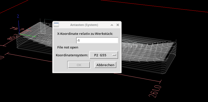

As mentioned, any input but zero greys out the ok button. The real machine and sim in Virtualbox have the same issue.
In the dialogbox it says: file not open
A gcode file is loaded, so this could point to an internal fault

The same her with 2.9.5 on my real machine and simulation. I went back to 2.9.4.

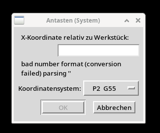

The Axis touch-off allows for any valid G-code expression, including the use of parameters. (So you should be able to type [#<_x> / 2] for example, to save typing the current X position)
Given this, "bad number format" is not a bug, but "file not found" is.
github.com/LinuxCNC/linuxcnc/issues/3563
