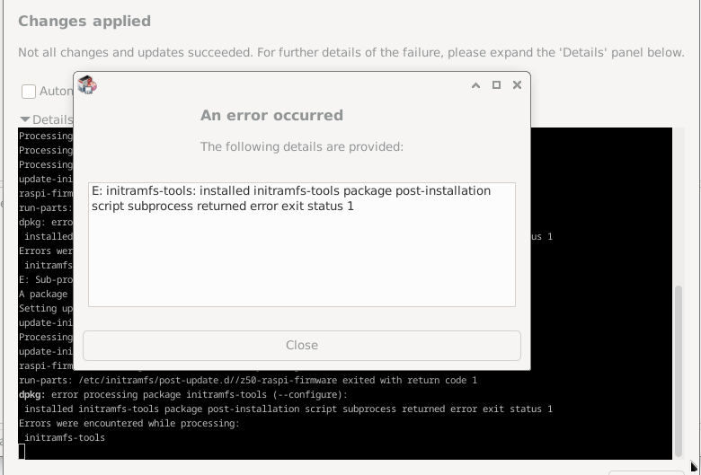

23 Sep 2025 20:03 - 23 Sep 2025 20:17 #335341
by RayJr
"No problem can be solved from the same level of consciousness that created it"
Albert Einstein
Replied by RayJr on topic Touch off, OK button greyed out
I just tried to force back with Synaptic Package Manager, and got an error.see attached.
Albert Einstein
Last edit: 23 Sep 2025 20:17 by RayJr.

- Posts: 19902
24 Sep 2025 11:41 #335360
buildbot2.highlab.com/release/debian/dists/
Replied by andypugh on topic Touch off, OK button greyed out
Or 2.9.6 which has been created to fix this specific issue, but hasn't been moved onto the repository yet (I haven't been at home long enough to do it since the debs got built).Uninstall 2.9.5
Manually download the 2.9.4 deb files using gdebi.
