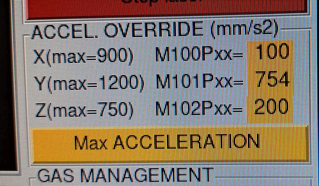

Final results:
yes, this code is correct:
halcmd setp ini.0.max_acceleration $accel
halcmd setp ini.x.max_acceleration $accel
M100 Pxx codes works well....it contains keyboard arrow/pendant/program acceleration overrides
so...i wrote small part to pyVCP as well
Thank you all! (specially to Todd)
Final results:
