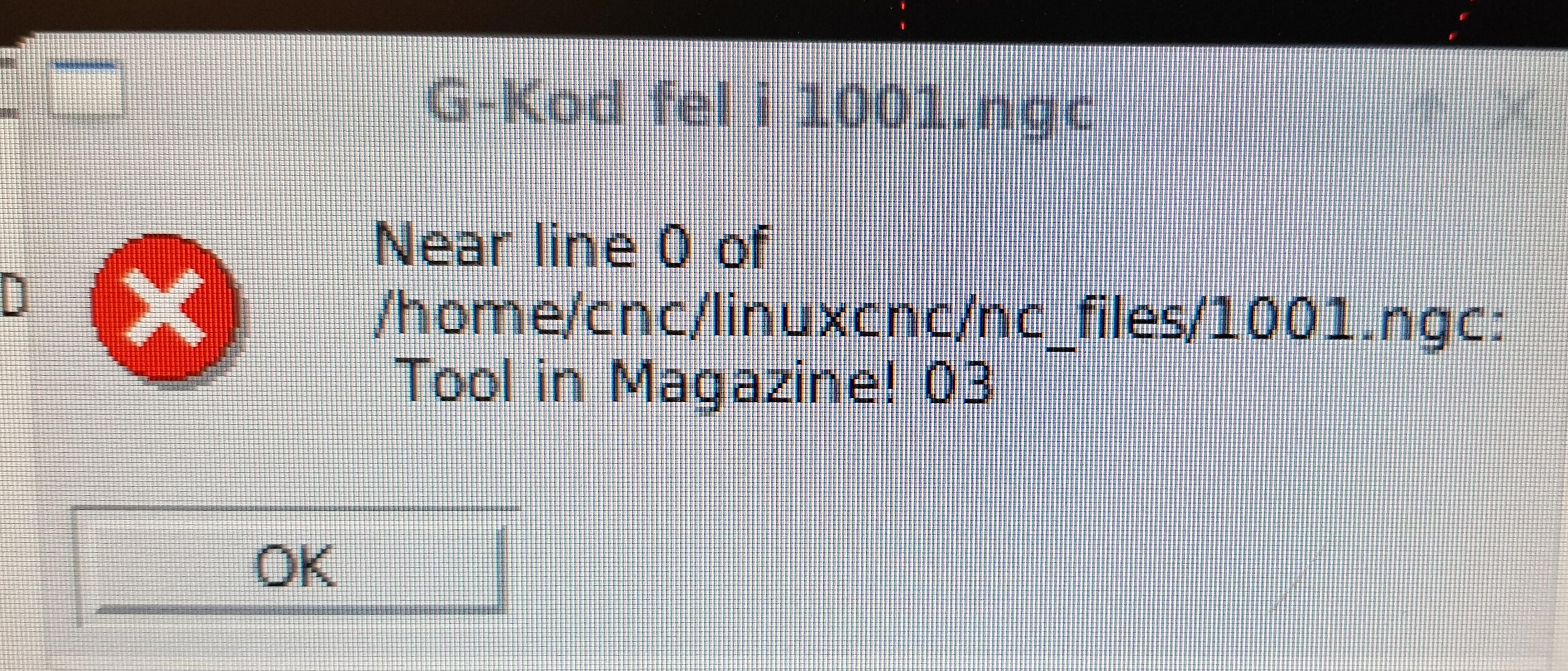

It's just a copy error on my part. If you look in the attached ngc file it is correct Not what is the error here.
- Posts: 19904
03 Dec 2019 06:44 #151845
Nobody but you can know that.
You say that the error message is generated by your tool change remap code. So what causes that error to be printed?
(Does your system actually set spindle-oriented true once the spindle is oriented?)
Replied by andypugh on topic VMC related HAL questions.
Is this the cause of the error message above?
- Posts: 19904
03 Dec 2019 06:46 #151846
If you have already posted your HAL, INI and remap files, then can you give a link to the message (of these 18 pages of messages) where the files are?

No I use M5 to abort only
linuxcnc.org/docs/2.8/html/gcode/m-code.html#mcode:m19
M19 is cleared by any of M3,M4,M5.linuxcnc.org/docs/2.8/html/gcode/m-code.html#mcode:m19

Well, you do need to set spindle-oriented true or M19 will always time-out.

Here are the current files.
The error message comes when I load the file 1001.ngc into linuxcnc
Text "Tool in magazine! 03" Coming from my toolchange.ngc
I comment off the line N25 the file (1001.ngc) opens properly.

The error message you show is from here:
So you see the error message because G-code digital input 5 is true.
So, why is that? Is it true?
(MSG, Checking MagPos 02)
M66 P5 L0 ; Check if mag pos is empty?
o103 if [#5399 EQ 0]
(abort, Tool in Magazine! 03)
o103 endif
(MSG, Moving arm 04)So you see the error message because G-code digital input 5 is true.

The docs do not say what happens with no Q-word, but they seem to suggest it is not optional.
(but might default to zero)
Although I have no Q?
