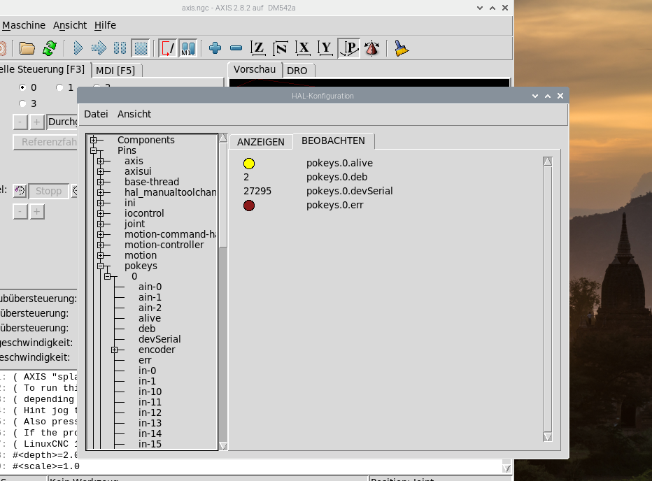

09 Aug 2022 19:53 - 09 Aug 2022 20:27 #249426
by MATZE-ATZE-SCH
Replied by MATZE-ATZE-SCH on topic Pokeys - Encoders
Hello Dominik,
the compiling had worked without error.
Also in Linuxcnc in Halshow I see the new Pins.
But the "alive" pin is not on, I dont get the signals from the input through linuxcnc...
Also the "error" pin is on...
Best regards and thanks for your help,
Marcel
Marcel

10 Aug 2022 16:49 #249456
by MATZE-ATZE-SCH
Hello Dominik,
have try it out, but without sucess...
Compiling without errors,
the pins are visible in halshow.
but the .alive isn´t blinking.
Also the .err is not on.
in the .deb is a 0.
Best regards
Marcel
in the .deb is a 0.
Best regards
Marcel

10 Aug 2022 18:24 #249467
by MATZE-ATZE-SCH
Hey Dominik,
-Pokey is connected via USB, yes
-dev-Serial is correct, set in hal with setp pokeys.0.devSerial 12345
-power is on, the red and green light are on on pokeys.
-done all the steps again...
If I compile the pokeys.comp from page 10, everything runs as it should, beside of the potis.
the alive is blinking, the err pin is off.
Then I close Linuxcnc and compile your pokeys.comp.
no error, see the pins in Linuxcnc, but no alive and deb = 0
If then I close Linuxcnc, compile the pokeys.comp from page 10, and start linuxcnc, everythink works just fine...
I don´t know what to do... :/

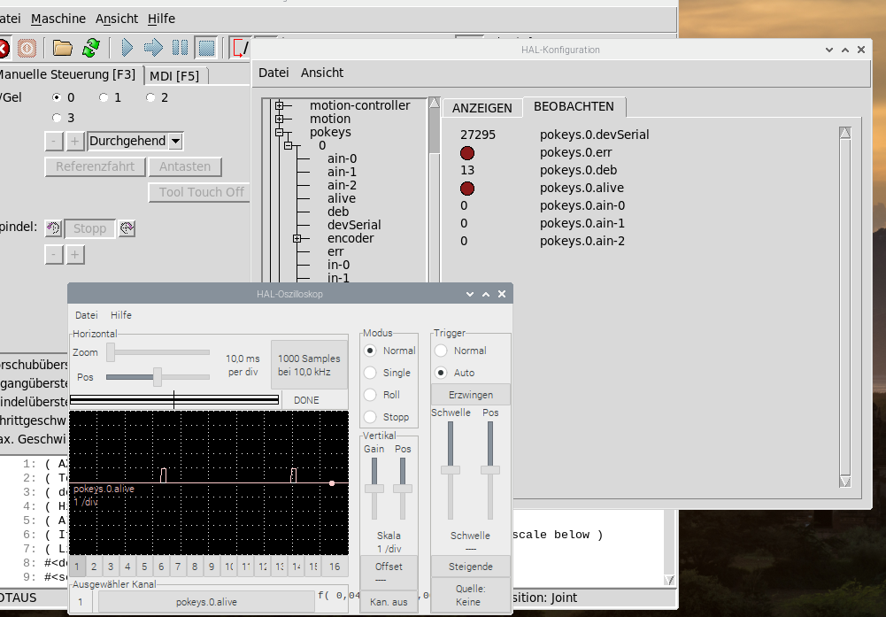

10 Aug 2022 19:26 - 10 Aug 2022 19:27 #249471
by zarfld
Replied by zarfld on topic Pokeys - Encoders
yes trying the original file of page10 is a good idea - to ensure that the system is basically working.
anyway i managed to access my system remotely and tried to reproduce the problem - on my raspberry having a dummy config it seems to work - but as the deb=13 it seems that it is periodically disconnecting
i can hradly see the alive-flag flashing on "HAL Konfiguration" page - i assume because of display latency due to remote connectionbut in HAL-Osziliskope you can see the values changing.
So i reverted that part of DigitalIO and AnalogIO to be similar as on page10 compiled and - this time - tested if the code runs
(anyway still no encoders connected as i'm not there)
hope that's similar on your system
