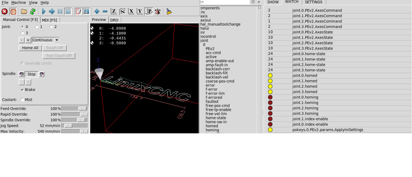

04 Mar 2025 18:16 - 04 Mar 2025 20:25 #323166 by zarfld
Replied by zarfld on topic Pokeys
i currently try to finalize the homing_comp for pokeys. it seem to basically work, but at the end where the sychronized axes should finish their homing. they are still shown as unhomed. (sometimes one of them got marked homed but never both of them)
Somehow it seems that i'm missing something, but i cannot figure out if i need to set a HAL flag or missed a step which is required to be done to finalize overall homing.
Can some one please point me in the direction where to look at?

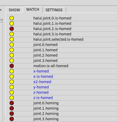

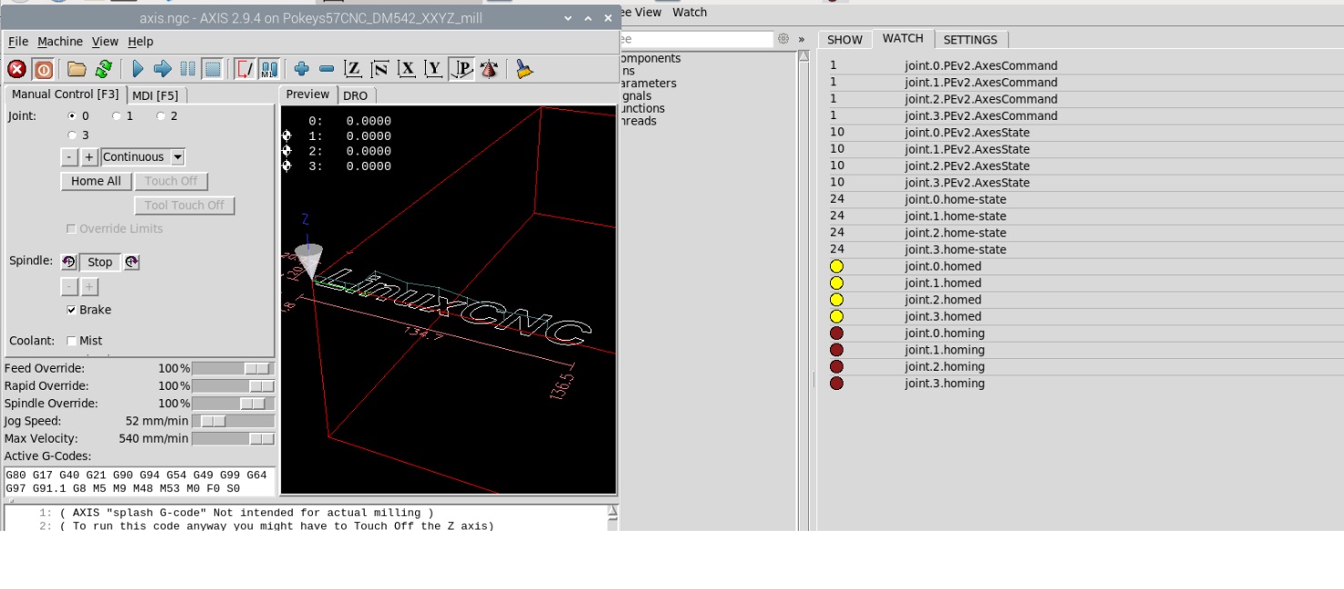

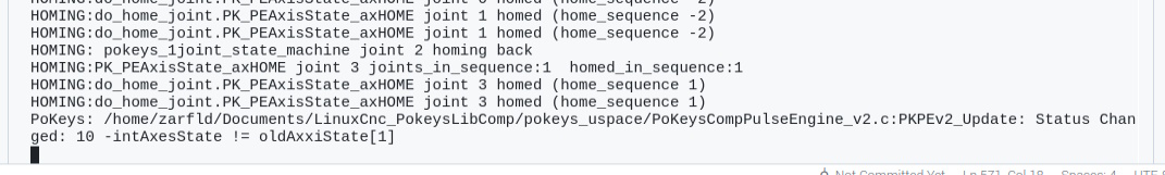

06 Mar 2025 19:12 - 07 Mar 2025 09:05 #323359 by zarfld
what i found out in the meanwhile that at the time where the cyclic of do_homing() seem to be stopped, one of the synchronized joints is still in status "PK_PEAxisState_axHOMING_BACKING_OFF". but it allway seems to stop when the status changed to PK_PEAxisState_axHOME.
in that cas it's legit that one of them is still not homed, but for me is still unclear why the cyclic calls of do_homing() are being stopped.
the other miracle is why the flags of both joints are set to:
.homed = 1
.homing =0
edit 7 new findings:
i now tried to workaround the problemb changing the home Sequences so that the Y will get Home sequence 3. and X&X2 get home_sequence -2: that endet up that now the joint for Y doesnt get homed (i mean halui.joint.2.is-homed still shows 0)
that seems that it is not related to the synchronized homing sequence of joint.0 and joint.1, but more likely to the last sequence that is being homed.
and also logging showed that the cyclic calls of do_homing() (or all calls to home_comp) are being stopped right at the moment when the PulseEngine Status changed to 10 (= homed).
as i'm quite sure that Linuxcnc motion or Halui know nothing about PE_AxisState, i think it is not the status change itself but something related to it, but i didnt see the debug message message. that do_homing() returned 1. so it is most likely something else
Last edit: 07 Mar 2025 09:05 by zarfld. Reason: new findings

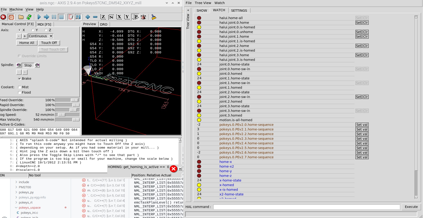

07 Mar 2025 15:37 #323425 by zarfld
Hi All,
it seems that i found the issue by accident   : it seemed that some part of motion still checks the home-switch-in even if they don't have a direct influence on my homing-procedure. (that is completely outsourced to pokeys, i just await the home status, the home-switch information is there but more or less for informative purposses. i didn't use these switches at all, but it seems theres some part of motion which checks that in background)

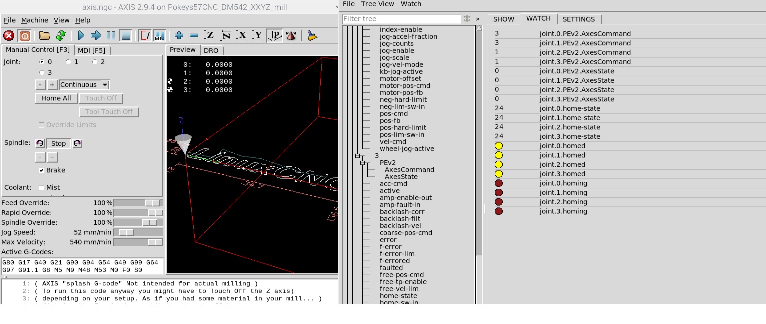

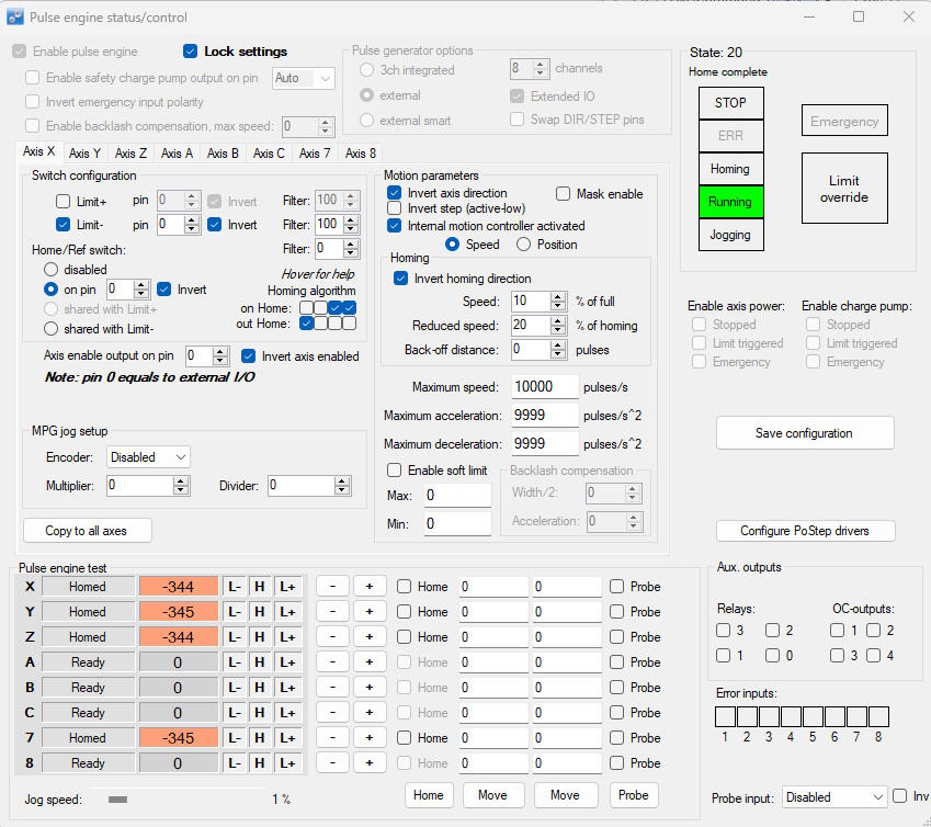

27 Mar 2025 22:02 #325111 by zarfld
i now tried to extend the homing workflow to better align to the Linuxcnc usual homing.
my home states are :
PK_PEAxisState_axREADY   -> before homing
when Homing is triggered the pokeys internal Homingprocedure does the following states
 - PK_PEAxisState_axHOMINGSTART
 - PK_PEAxisState_axHOMINGSEARCH
 - PK_PEAxisState_axHOMINGBACK
- PK_PEAxisState_axHOMING_RESETTING
- PK_PEAxisState_axHOMING_BACKING_OFF
 - (  PK_PEAxisState_axHOME ) that status of pulse engine is suppresed and
after that i have to finalize the pokeys homing procedure by a "PK_PEv2_HomingFinish" command in order to operate that joint again for tho upcoming steps there fore i added two additional steps:
    PEAxisState_axReadyToFinalizeHoming  -  used as a indicator from pokeys.comp to pokeys_homecomp that the homing finalize command can be triggered
    PK_PEAxisState_axReadyToArmEncoder  in this step that index search part should take place, in that step my intention was to reset the position feedback to ZERO_POSITION, to prevent problems on pokeys due to the (softlimits on the device side).
on the Joint for Z i have the problem that the difference to zero position is quite high as the position change might be 100 mm
so here i'm at a point  where i don't figure out what to do, and either where to find out or whom to ask for help.
what i currently try to do is
Joint_num].index_enable = index_search_active;  at the PK_PEAxisState_axReadyToArmEncoder status
and at the follwoing status
PK_PEAxisState_axHOMINGARMENCODER  i basically reuse the actions as were done in homing.c at "HOME_INDEX_SEARCH_WAIT"
                if (H[joint_num].index_enable == index_search_armed) {
                    /* yes, stop motion */
                    joint->free_tp.enable = 0;
                    // joint->free_tp.pos_cmd = joint->free_tp.curr_pos; // set to zero
                    joint->free_tp.pos_cmd = 0; // set to zero
                    /* Pokeys resets encoder position to zeros */
                    H[joint_num].index_enable = index_search_armed;
                    H[joint_num].homing = 1;
                    H[joint_num].home_state = HOME_SET_INDEX_POSITION;
but it always stops at about that step and some part triggers "do_cancel_homing"
the only message that i could see on my last version was
"emc/task/taskintf.cc 976: Error on joint 3, command number 139"
(until now a similar message was together with a FOLLOWING_ERROR for that joint)
Is there someone who could tell me where to check, or whom to ask. I'm not sure if this thread is the right place to ask about that topic.
BR
Dominik
