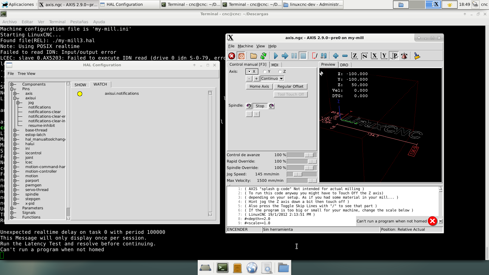

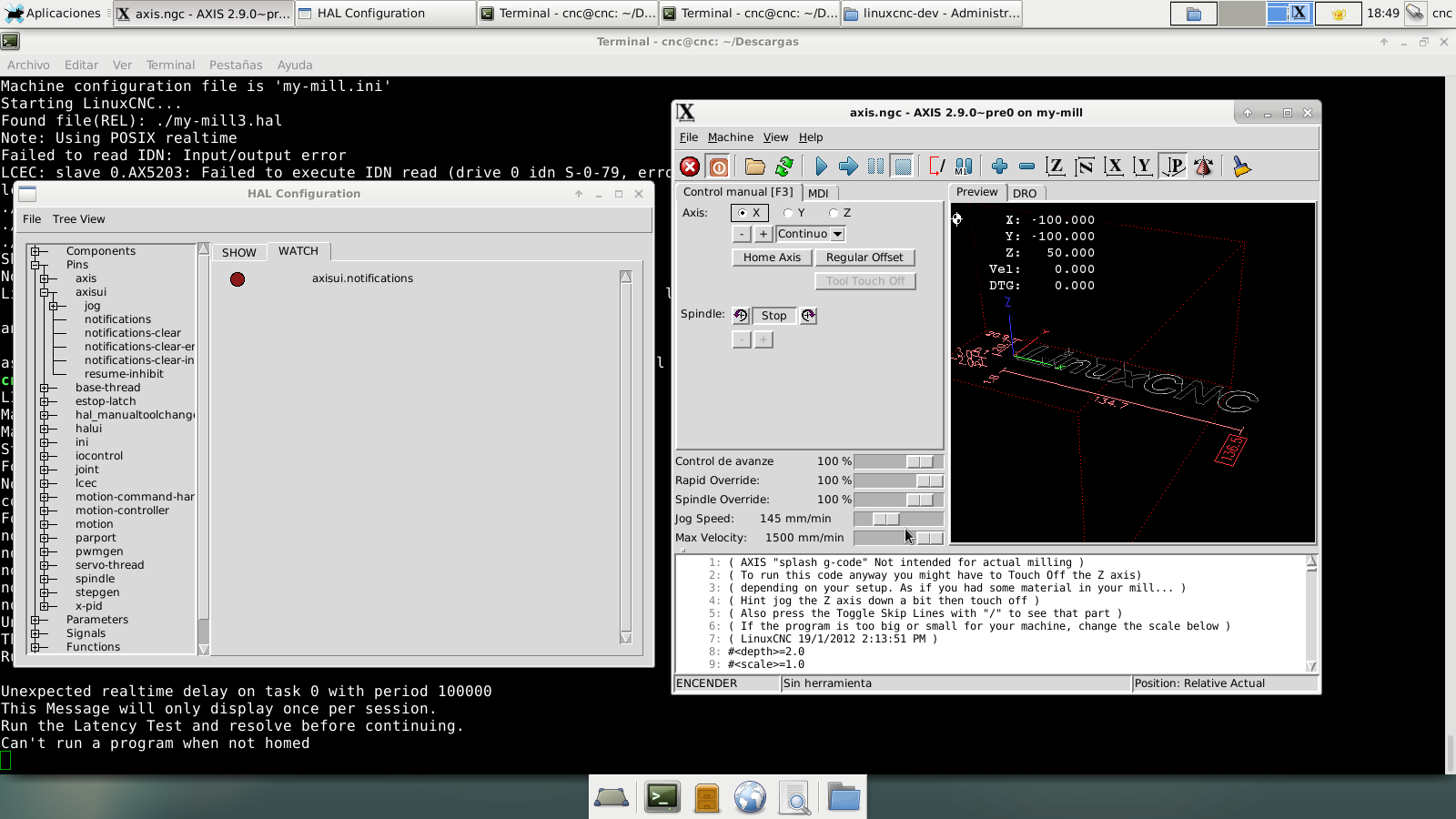

07 Dec 2019 12:29 - 03 Jan 2020 14:04 #152272
by chimeno
Replied by chimeno on topic Message Component - Reset?
Hi, I found this old thread, and I'm looking for a HAL pin output that notifies me when a message appears in the AXIS guide, any idea if it exists? does not exist.
I have to create a new output pin, I must look at the file
added this line
now I must connect it, I guess I should look at the
but I don't have much experience in phyton, if someone can guide me or help me ?, thanks
greeting
Chimeno

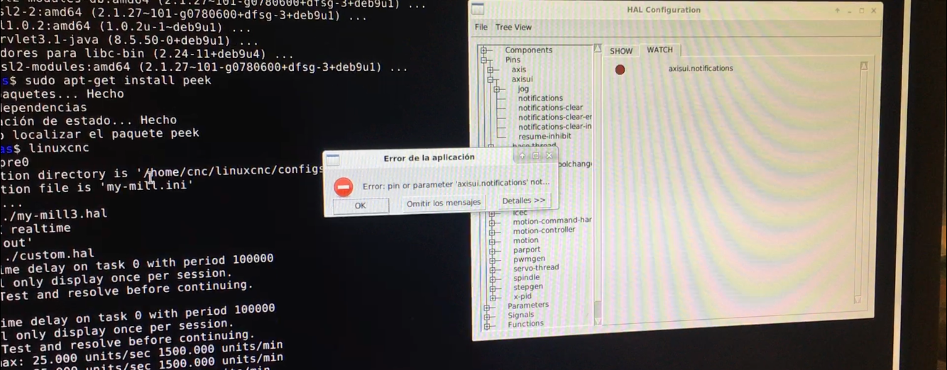

04 Jan 2020 12:16 #154007
by chimeno
Hello again,
I am trying that when an error message occurs to be able to activate an output pin, warning, I think it would be good for linuxcnc, now I have it worked as I show in the image img2477, but when I close the application an error appears, I will not program python so I'm trying, if someone can tell me what I did wrong or how I should do it, the changes are in this fil
the lines that added
in which section:
greeting
Chimeno
./src/emc/usr_intf/axis/scripts/axis.pythe lines that added
comp ['notifications'] = Falsecomp ["notifications"] = Truecomp.newpin ("notifications", hal.HAL_BIT, hal.HAL_OUT)in which section:
