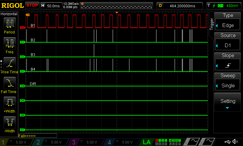

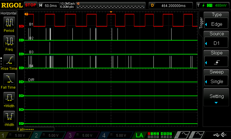

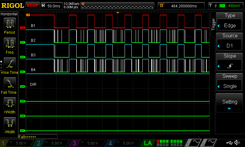

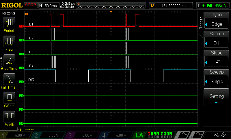

I finally got a chance to hook up my scope and see what's going on. One direction is pretty smooth, but the other has ~4Hz period between port writes.
I'm not going to spend too much time digging into it, because as Andy said... This would be a lot better off as a separate HAL component.
I won't say that my priorities will not change in the coming year, but I would love to revisit this as I work my way through classes. It'd be a great intro to HAL components.
The following snips show the labeled channels:
DS1Z_QuickPrint3 was a slow jog in +X, it was smooth.
DS1Z_QuickPrint4 was a slow jog in -X, it was rough (approx 4Hz on the DIR pin).
DS1Z_QuickPrint1 was a fast jog in +X, it was a bit rough.
DS1Z_QuickPrint2 was a fast jog in -X, it was very smooth.
Bear in mind, this is still generating PWM at this point. I'm using the PWM component for direction.
