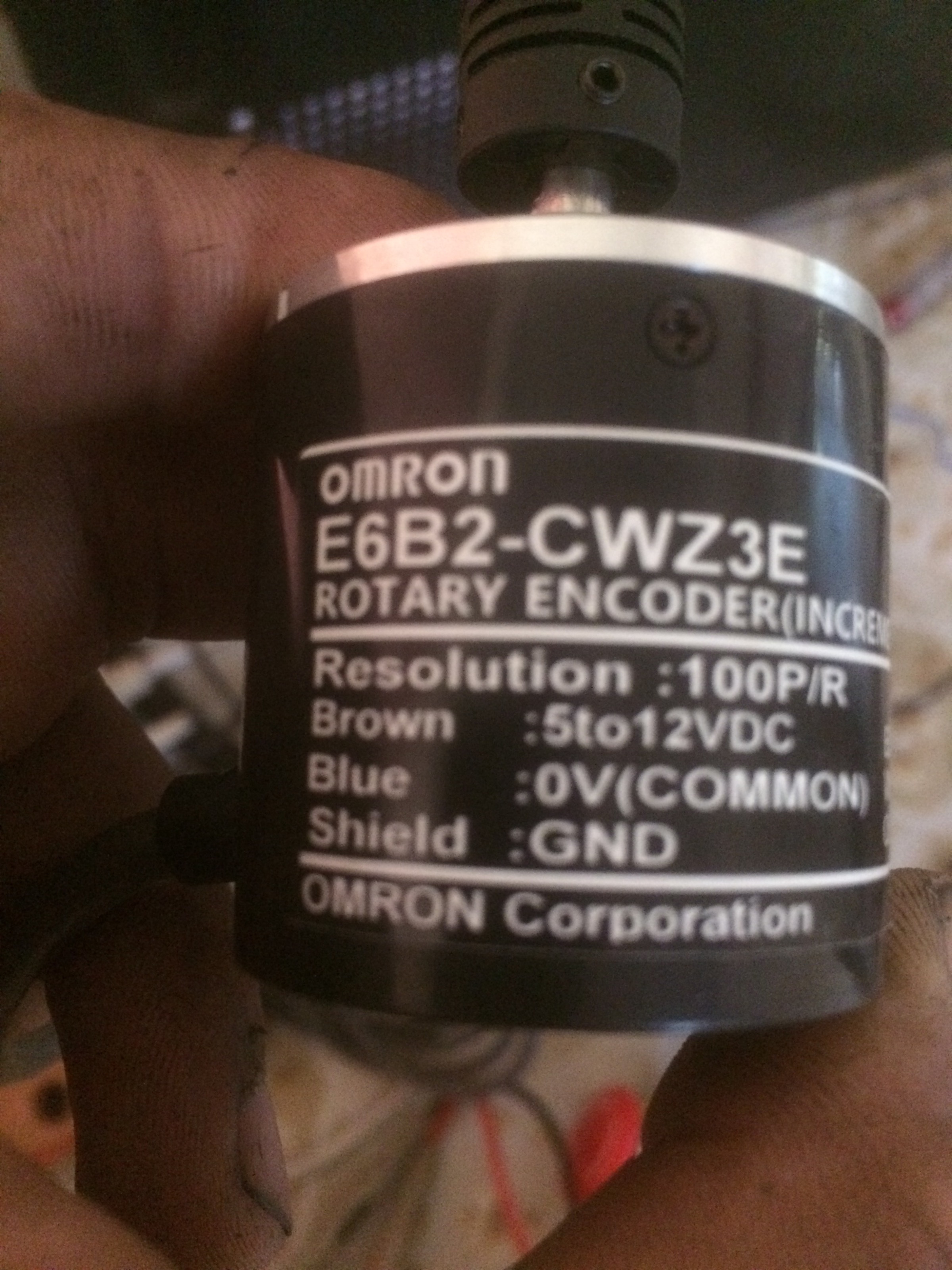

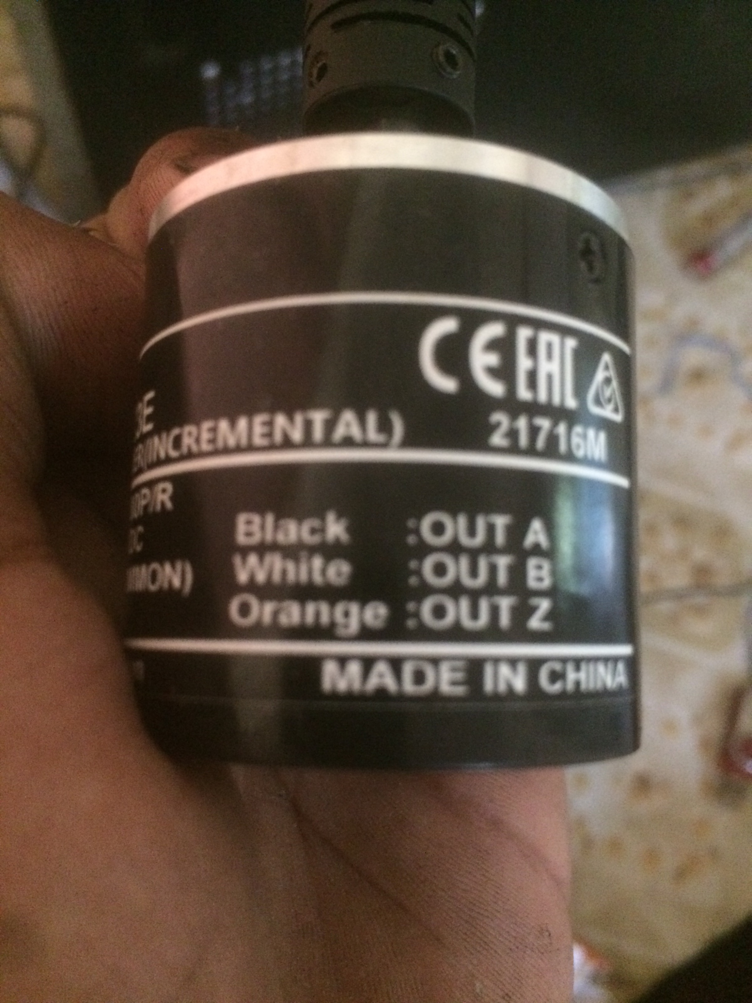

I bought omron 100ppr quadrature encoder to connect my bob.
connect pin 10 and 11 as phase A and index.
stepconfig select those pin as mentioned but not spindle speed not working,
what is missing?
what is missing?

07 Mar 2020 21:27 #159451
by Dinuka_Shehan
Replied by Dinuka_Shehan on topic spindle encoder help
encoder

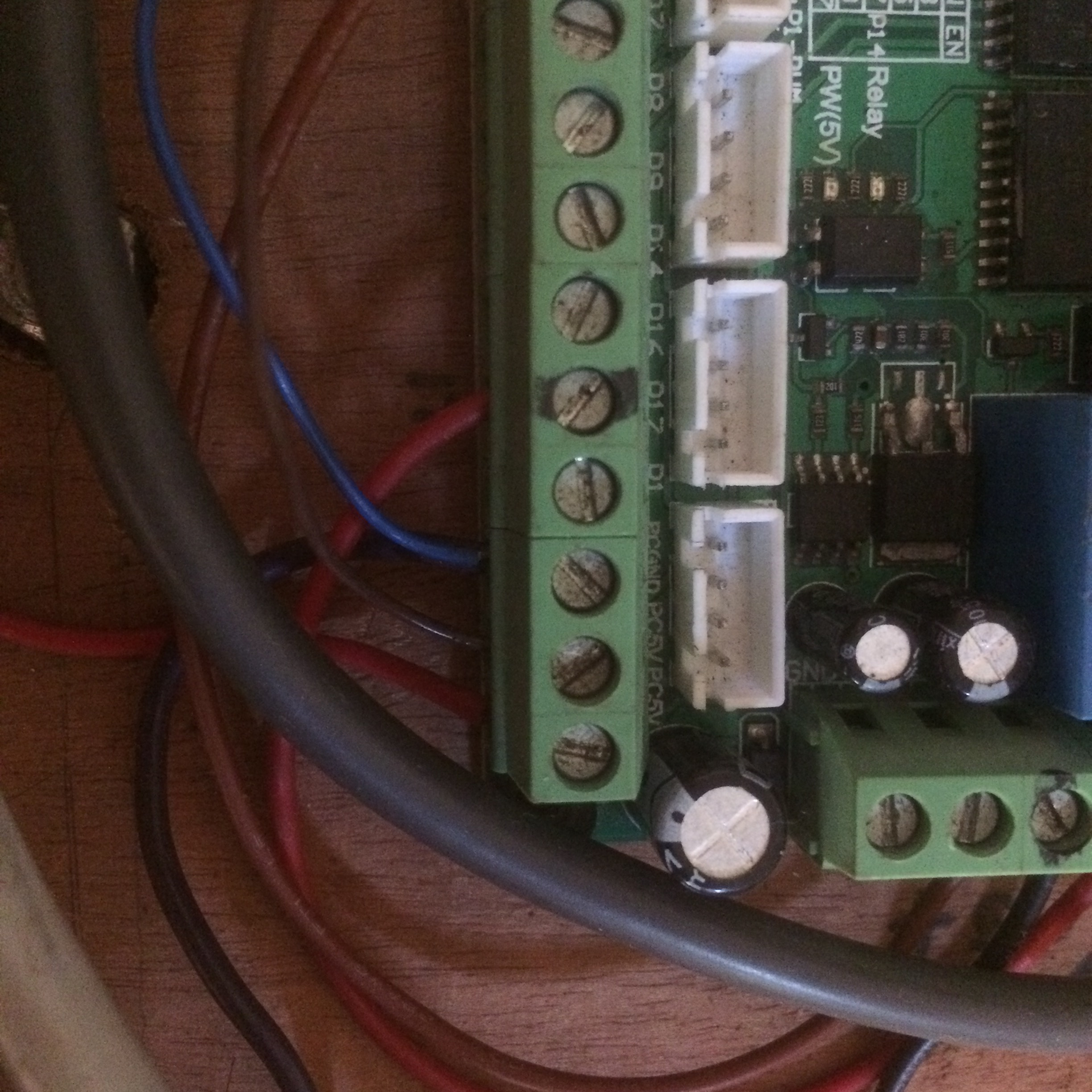

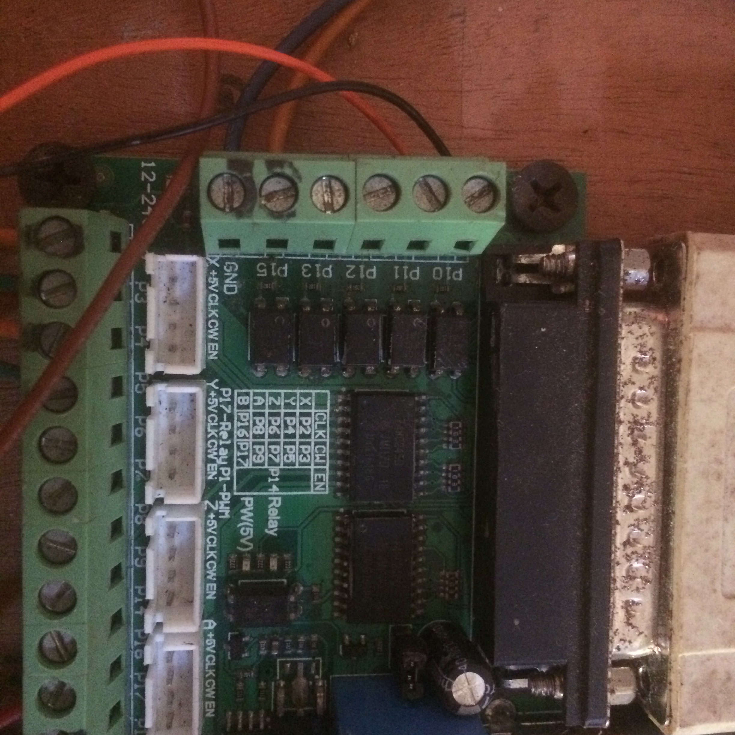

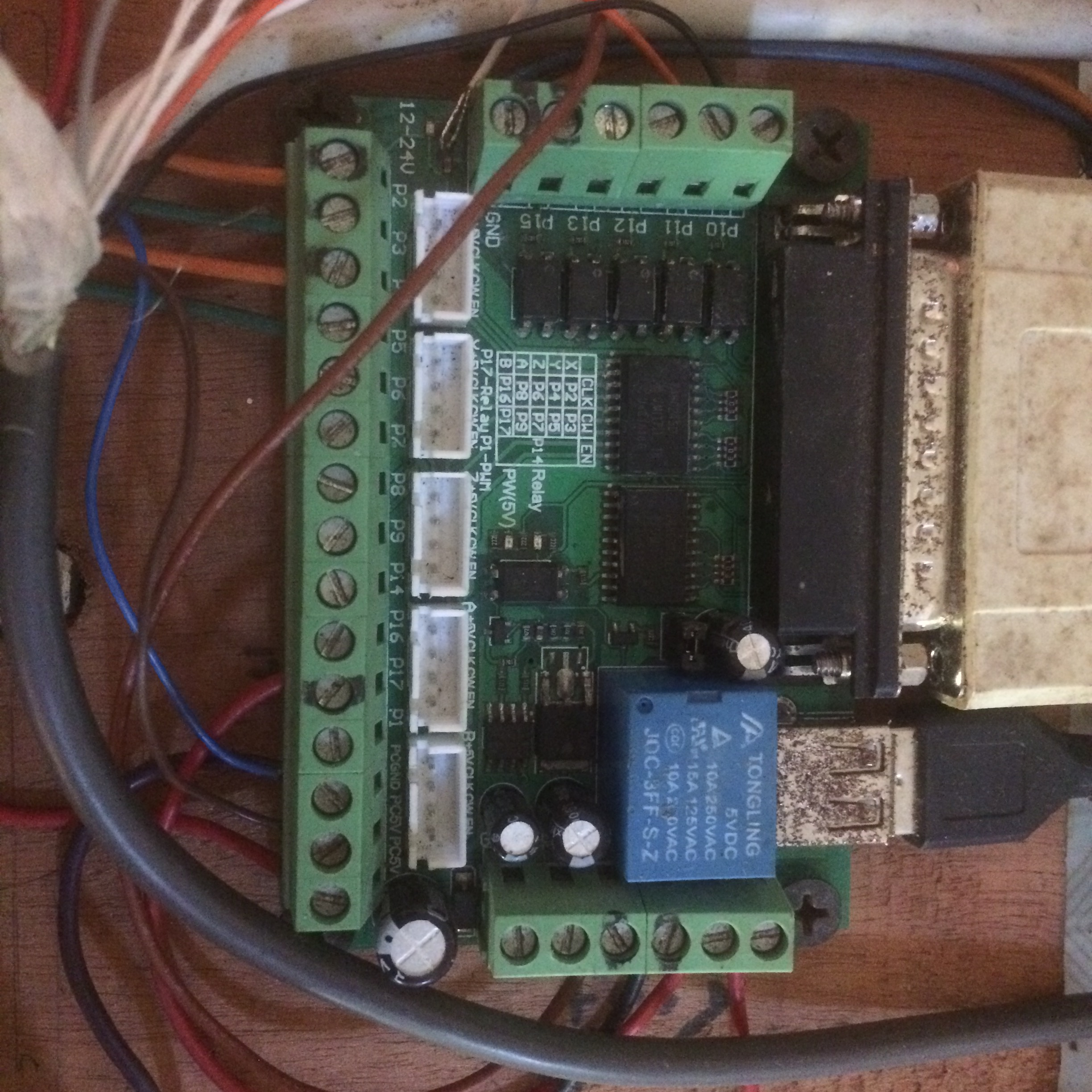

07 Mar 2020 21:32 #159452
by Dinuka_Shehan
wiring

A couple of things:
1. if you are using both A and B lines from the encoder (quadrature) you will have 400 counts
per turn so the scale should be 400 not 100
EDIT I see you are using only A and index so 100 is correct for counter mode
2. why do you have encoder 3 instead of 0?
3. People can be of more help if you post your hal/ini files and any error messages
you recieve
