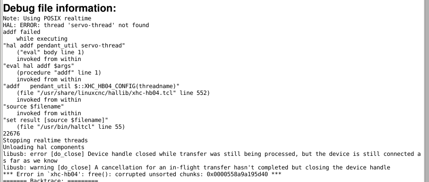

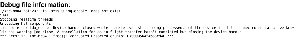

Whilst I’ve been watching this thread I haven’t commented, but one thing I have noted is that the error messages have clearly stated things like no servo thread can’t find file and the like. Have you addressed these issues ? Or have you just been concerned that the pendant isn’t operating ?
Have you been able to get a working config, one that works without trying to get the pendant working ?
If it was me I’d concentrate on having a configuration that is able to operate my machine and run gcode. Make a backup of that and then attempt to get the pendant going. Theoretically any issues should be in the file pertaining to the pendant not the main machine.
The error messages usually give a good idea of what the issues are eg pins not existing ( generally a typo or something you’ve forgotten to add ), unable to find a file once again a typo or the file not in the location expected. These are actually examples of what I’ve seen in your error messages.

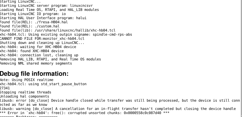

I am using the whb04 wifi mpg without problems when I run the simulator that is integrated in linuxcnc. I try to make a new configuration following the steps and it doesn't work for me, I have ordered the order of execution of the hal and tcl files and I got the last error message. I can not see because of my lack of experience what is the error .. I will continue !! thank you for your response !!

You have a message:
CANNOT FIND FILE FOR:monitor_xhc-hb-104.tcl
Like I said the error log gives a pretty good idea of the issue. Is that file name correct ? Do you have that file ?
Then Linuxcnc is shutting down. That is the issue. sort that issue out.

The monitor_xhc-hb04.tcl is *not* a HALFILE,
it belongs in the [APPLICATIONS] section.
(And the naming is monitor-xhc-hb04
*not* monitor_xhc-hb04.tcl).
Example:
Ref (README): github.com/LinuxCNC/linuxcnc/blob/2.7/co...xhc-hb04/README#L141
Ref (Example sim config): github.com/LinuxCNC/linuxcnc/blob/2.7/co...hb04-layout2.ini#L43
Replied by dgarrett on topic xhc-hb04 .Why can't I make it work?
An observation: your inifile (fresa-HB04_2020-03-21.ini) excerpt:CANNOT FIND FILE FOR:monitor_xhc-hb04.tcl
[HAL]
HALFILE = monitor_xhc-hb04.tclThe monitor_xhc-hb04.tcl is *not* a HALFILE,
Example:
[APPLICATIONS]
APP = xhc-hb04-accels
APP = monitor-xhc-hb04Ref (README): github.com/LinuxCNC/linuxcnc/blob/2.7/co...xhc-hb04/README#L141
