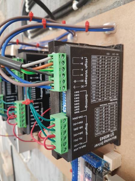

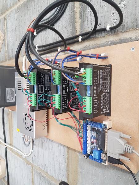

Pictures of the wiring, what BOB, what drives, what are the DIP switches set at in the drives, post your hal and ini files.

Todd - Yeah I did try that. Axis wouldn't start. Ive just tried to copy the debug info over but Ctrl C wouldn't work for some reason.
Tommy -

Morning, apologies, it was a late finish last night in the end. Got home, turned the cooker on and it smelt of burning so had to take that apart, the joy!
Here are the pics of my wiring set up. Eventually this will all go inside an acrylic box with a fan on the side for ventilation but it is what it is while Im trying to get it up and running.
