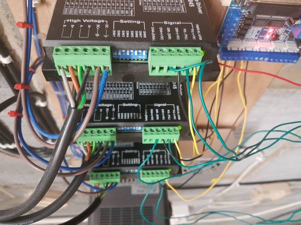

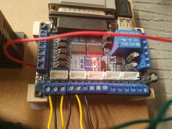

Ok so, I tried the step/dir + cables direct into the pport on the cable and nothing on any of the axis. Ive got some longer cable which I will try direct to the PC port tomorrow.
Ive checked the continuity of the wiring and its all good but still no joy with movement on the machine.
Voltage test - USING DVM - Testing points, Red on driver terminal screw and black on GND screw on BOB.
X
STEP starting voltage 0v Left 1.4v Voltage then holds until I hit Right it then drops to 0v and holds even when I stop pressing key.
DIR starting voltage 1.4v Left 1.9v Voltage then holds in that area until I hit Right it then drops to 1.3v and holds while holding the key down.
Y
STEP starting voltage 3v Up NO CHANGE Down NO CHANGE
DIR starting voltage 1.4v Left NO CHANGE Right NO CHANGE
Z
STEP starting voltage 1.4v POS 1.48v voltage then holds until I hit NEG it then drops to 1.03v and holds even when I stop pressing key.
DIR starting voltage 1.4v POS voltage then holds until I hit NEG it then drops to 0v and holds even when I stop pressing key.
Not sure if that all makes sense. I'm guessing there is an issue with the Y Axis but not sure whats going on with the X and Z. Tried again in Axis once all sorted and nothing, no movement on any of the axis. All 3 motors are powered up so that something lol.

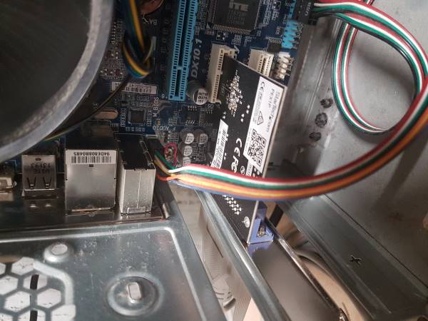

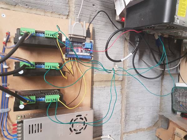

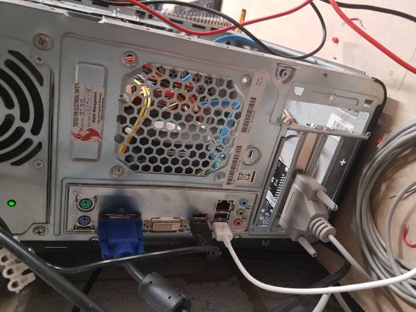

Attach the hal and ini, some picture of the setup as you have it wired now, and the back of the pc.
Also a screenshot of the terminal with
sudo lspci -v | grep port
BTW those voltages look all kind of wrong.

That is strange, a parallel port should have one or two addresses depending on the type, not 10!
Oh well, you will have to try all of those, but before you do, find a way to measure the voltage on the printer outputs, namely between pin 2 and gnd of parallel port, so at least you know when you get the right address.
Also keep in mind that to be sure the port is accessible, you will have to reboot the PC after any address change as it may hang and subsequent tries will not work.
Replied by tommylight on topic New to LinuxCNC - Trying to add a PPort card and get LinuxCNC to start
What card is it ?
It looks as a PCI-E one.

28 Apr 2020 06:30 - 28 Apr 2020 06:31 #165958
by Clive S
Replied by Clive S on topic New to LinuxCNC - Trying to add a PPort card and get LinuxCNC to start
Where are the green wires on the drive going to.
See this .just for the bob wiring
Don't wire the enable at this stage
