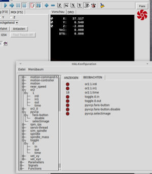

Replied by remon_v on topic Fans to turn on when starting program
I still get the same error:
Pin ' pyvcp.fans-button.disable' does not exisst

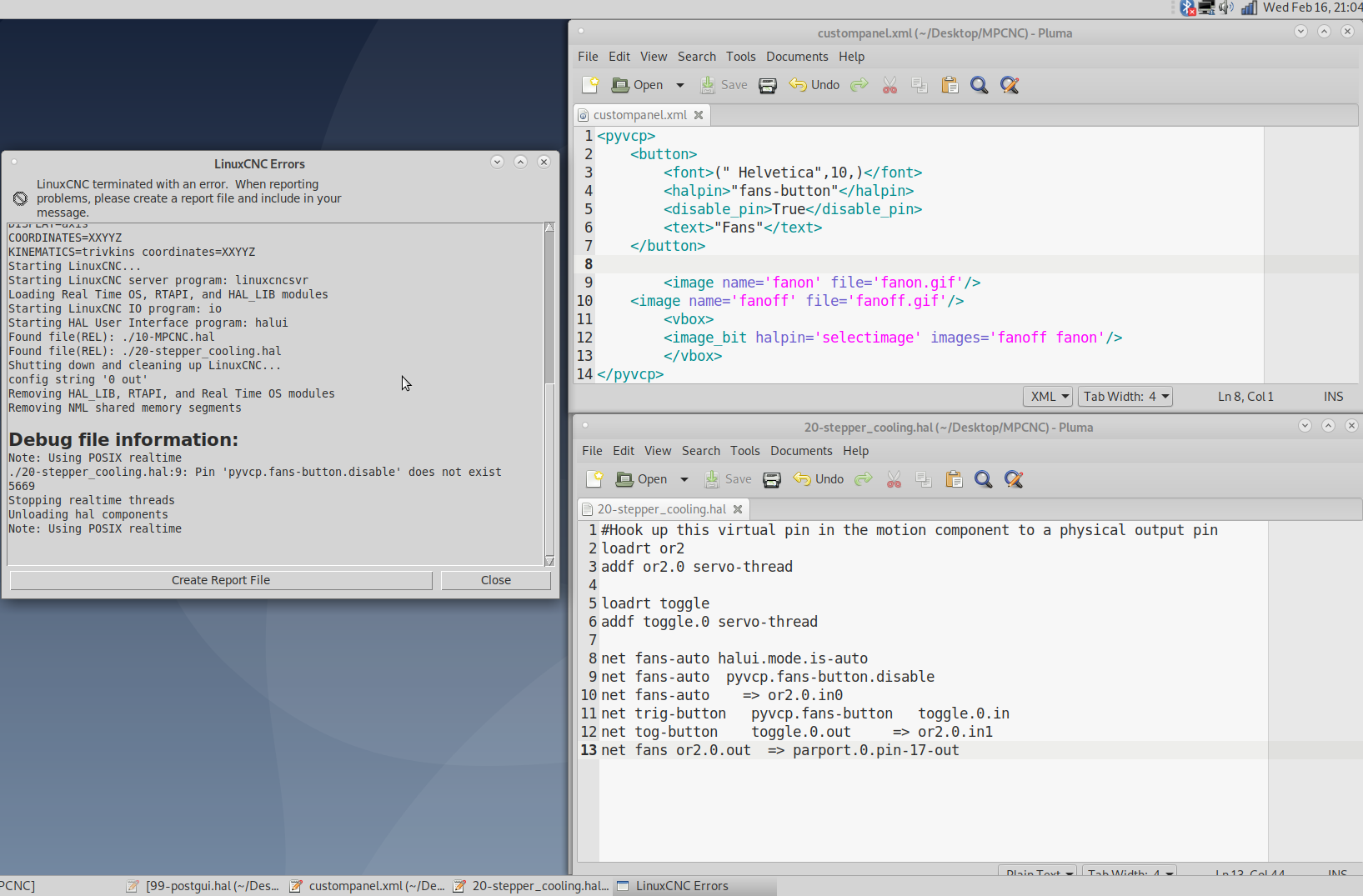

16 Feb 2022 14:01 #235072
by MaHa
Replied by MaHa on topic Fans to turn on when starting program
I get this error because missing
<disable_pin>True</disable_pin>
in the .xml file. I tested it in the sim and it was working as i expected.

Is 20-stepper_cooling.hal loaded as postgui?

17 Feb 2022 07:26 - 17 Feb 2022 07:32 #235130
by MaHa
You have this entry in the MPCNC.ini file. All the content of '20-stepper_cooling.hal' should be moved to this POSTGUI_HALFILE (99-postgui.hal), because this loads after axis is started.
POSTGUI_HALFILE = 99-postgui.hal
and this entry removed or commented
'HALFILE = 20-stepper_cooling.hal'

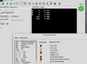

17 Feb 2022 08:08 - 17 Feb 2022 08:16 #235135
by MaHa
Last edit: 17 Feb 2022 08:16 by MaHa.

17 Feb 2022 08:24 #235136
by remon_v
Thanks! That looks cool… I will check it when I get home

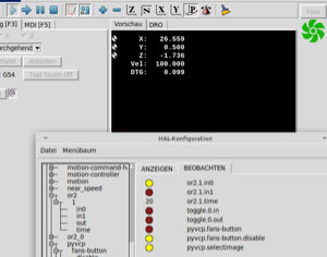

17 Feb 2022 14:20 #235160
by remon_v
