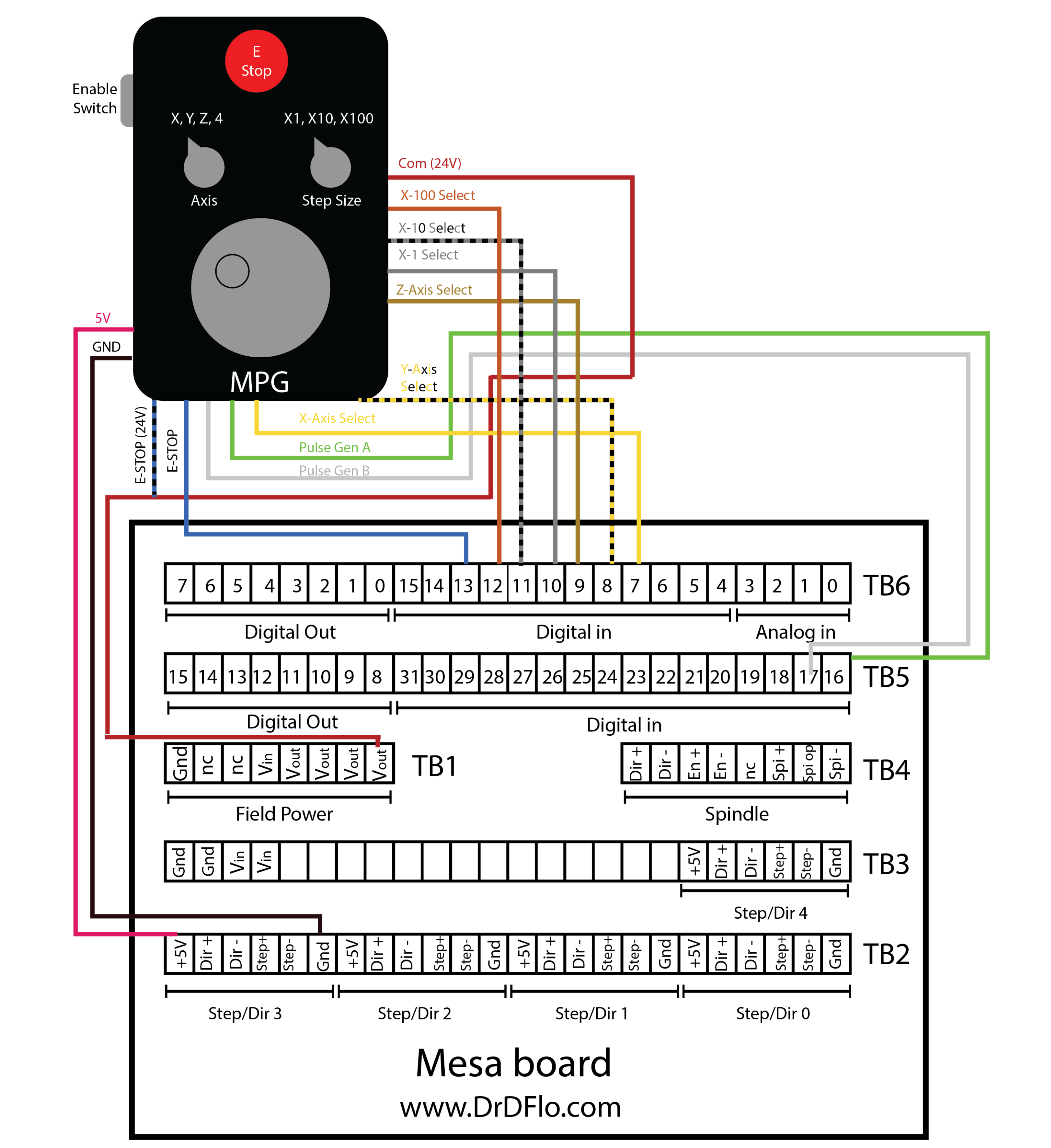

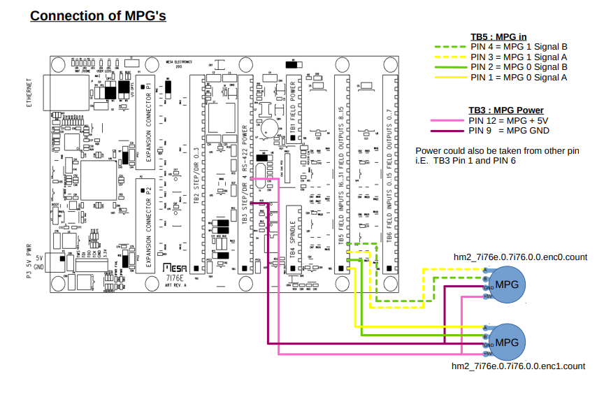

hey there,
i have connect hand mpg, but cant get any reading, just -1 on enc0.count
and its in mode 2
5v and gnd on tb3 for mpg
maybe missing some scale on encoder ?
and its in mode 2

Do you have a common ground between MPG and Field power?
- Kasper-001
- Posts: 81
- Thank you received: 5
17 Feb 2022 15:23 #235170
by Kasper-001
Replied by Kasper-001 on topic 7i76 MPG cant get reading
i have tried with 5v and field gnd , but that gave no reading
- Posts: 18119
- Thank you received: 5337
17 Feb 2022 15:25 #235171
Replied by PCW on topic 7i76 MPG cant get reading
It needs both.
( You must have field GND connected to 5V ground for this to work )
- Kasper-001
- Posts: 81
17 Feb 2022 15:27 #235173
by Kasper-001
is it jumper settings ?
- Posts: 18119
17 Feb 2022 15:29 #235175
No, its your external wiring
The 7I76 MPG inputs need 5V signals relative to field power common

17 Feb 2022 15:38 #235177
by Kasper-001
i have it like this
- Posts: 18119
17 Feb 2022 15:41 #235178
That will not work because the MPG inputs (on TB5)
do not have a common ground with the MPGs
- Kasper-001
- Posts: 81
17 Feb 2022 15:47 #235180
by Kasper-001
so put T3 pin 23 =gnd + T1 pin 8=gnd together
- Posts: 18119
17 Feb 2022 15:57 - 17 Feb 2022 16:07 #235184
Yes, the field power common and 5V common must be connected
if your MPG runs from the 5V supply.
Last edit: 17 Feb 2022 16:07 by PCW.
