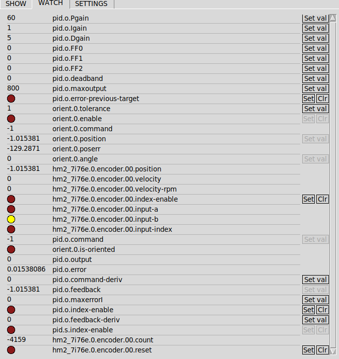

I'm trying to implement spindle orientation for my ATC build. Need a simple homing function.
I've found about 6 or so 'working' examples dating back to 2010 in the forum and have tried using them as seed-corn to modify my working HAL file. No joy, however... too many errors during startup to count.
I think the main problem, aside from my ignorance and inexperience, is that all of the examples are using some configuration fundamentally different than mine - or the comments are in German. Or both.

Does anyone have a working HAL file (plus INI if needed) with spindle orientation for a 7i76e & 0-10V command (bog-standard VFD)?

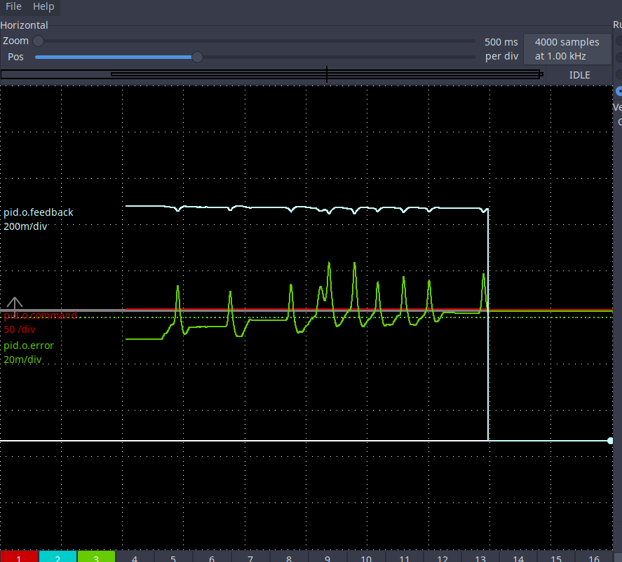

Still fiddling with the PID settings; seems like lots of D is making it better, but it never settles. Acting like it's not actually servoing - there doesn't seem to be any change in the error or pid output whenever the index is triggered.
I'm used to poorly tuned servos reaching a target and then reacting to the target - even if they do it badly. This thing is just wagging back and forth and sometimes doesn't even rotate enough to reach the index signal.
Does the halscope shot below make any sense? Is there some setting or hal connection missing?

There is something funny going on. pid.o.error is non-zero but pid.o.output is zero. Was the halshow screenshot taken with the pid.o enabled?
(looking again, no, as orient.0.enable is false in the image)
If your vfd can do 10rpm then orient should work really well, and you shouldn't need inverse deadband. But it is here:

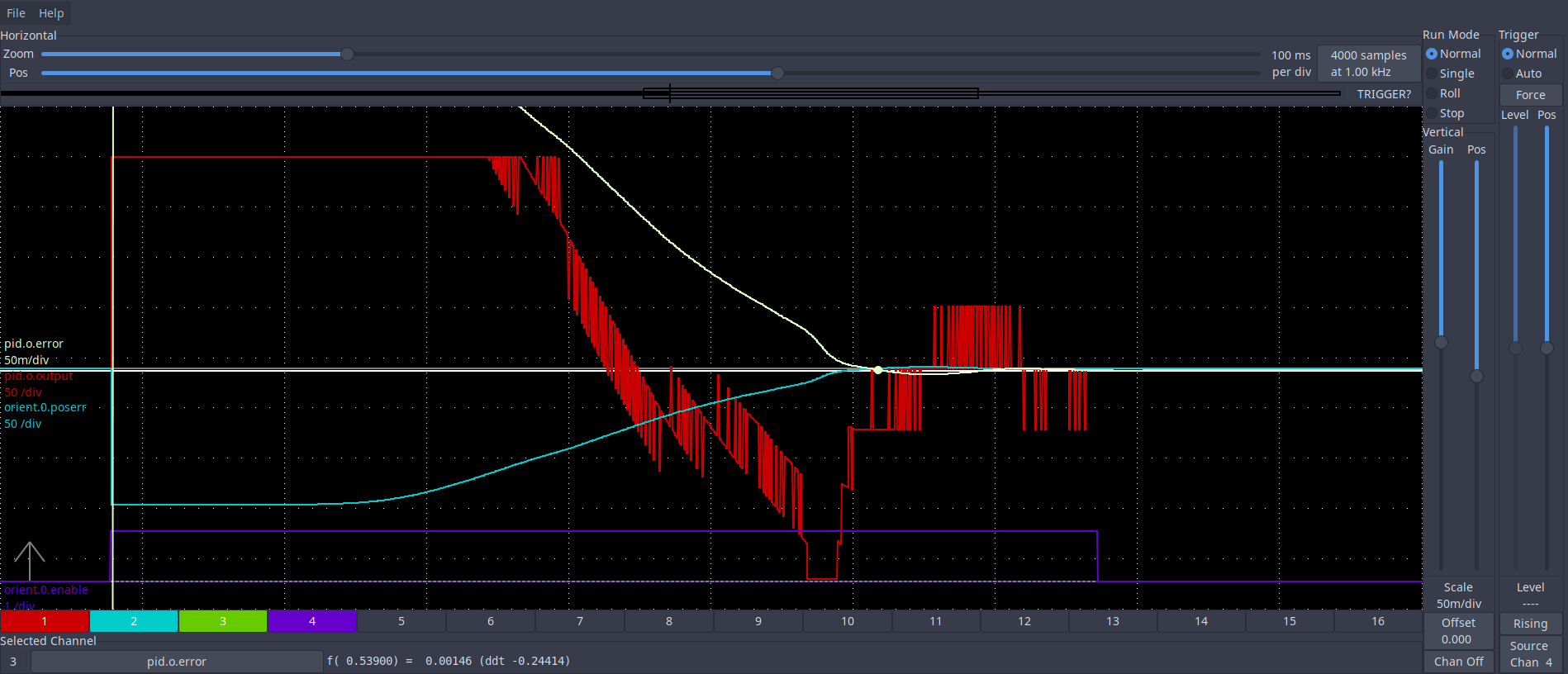

On the halscope, ignore the index for the moment, and plot pid.o.command / feedback / error.

The halshow screenshot was taken after the orient timed out and everything stopped. Was included mostly to show settings that generated the halscope trace.

Here's the best I've achieved so far. Orient completes (in tolerance) about 50% of the time within 5 seconds. Otherwise it fails, either a by a little or a lot. Giving it more time doesn't seem to help.
I was wrong about the lowest spindle speed...60rpm is as low as it can go at steady state and not get 'clunky.' The analog offset/gain thing I did to the VFD earlier settled it down, but it didn't turn it in to a brushless servo.

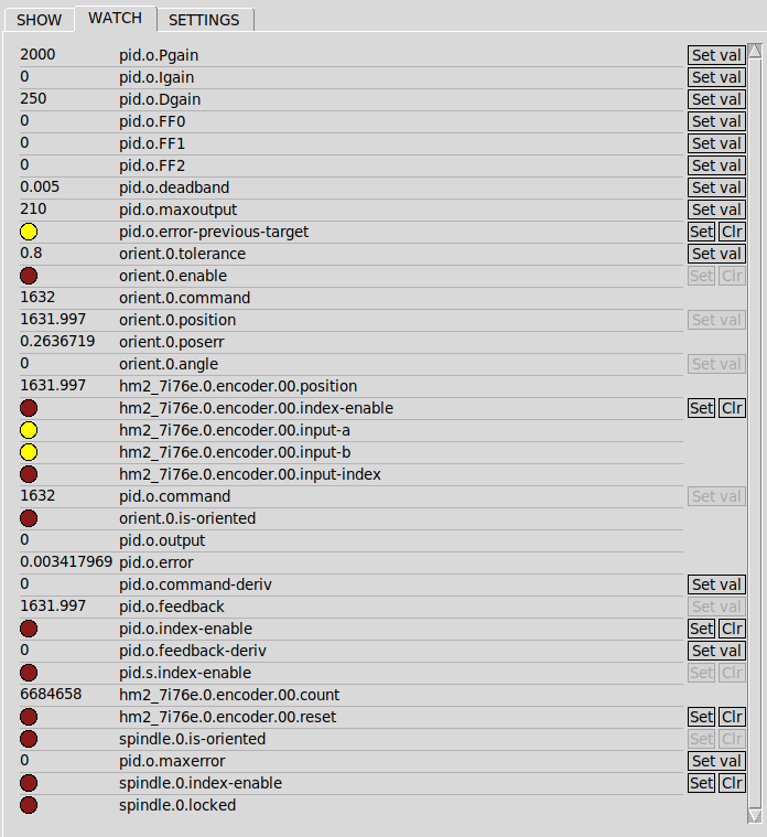

So close now. Orient is nailing it about 8 out of 10 times within 2 seconds when I run a little M3 S1000 G4 P2 M5 M19 testing program. Seems like once in a while it'll get close (within a couple degrees), stop, then jump and hunt until orient times out and errors.
I've disabled the orient-lock 'spindle brake' function from the example as it was causing the spindle to dither +/- 2-5 degrees once orient-complete was asserted.
Could use some suggestions on:
1. Getting it to be 100% reliable within a resonable time (2 seconds or less)
2. Speeding up the process. Don't want to wait so long at each tool change.
3. Reducing dither to re-enable the spindle-brake function. Encoder is a 1024-line (4096ppr) and the dither is more like +/-50 counts.
4. Do the PID settings look insane? I've read all I can about FF0/1/2, but not sure how or if they'd help here.
5. Something I should be doing different in halscope to help someone analyze the spindle response?
PID settings and halscope attached for anyone who might be following.
-Ralph
-Ralph
