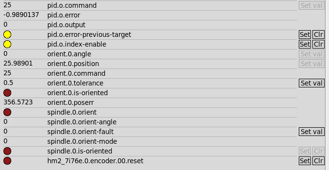

21 May 2022 22:11 #243529
by spumco
Replied by spumco on topic [So close...] Spindle orient PID tuning?
So lincurve addition didn't throw any errors and I started running/tuning orient.
M19 kept timing out... and I noticed something strange in halshow.
orient.0.poserr always winds up way off - which, presumably, is why it times out with an error. But poserr looks funny, like a scaling issue or something. The spindle is getting close and the PID is twitching/hunting, but poserr is reporting almost a full turn off.
What would cause the orient poserr to be almost a full turn off, yet the PID thinks the target is close enough to be wagging +/- just a little?

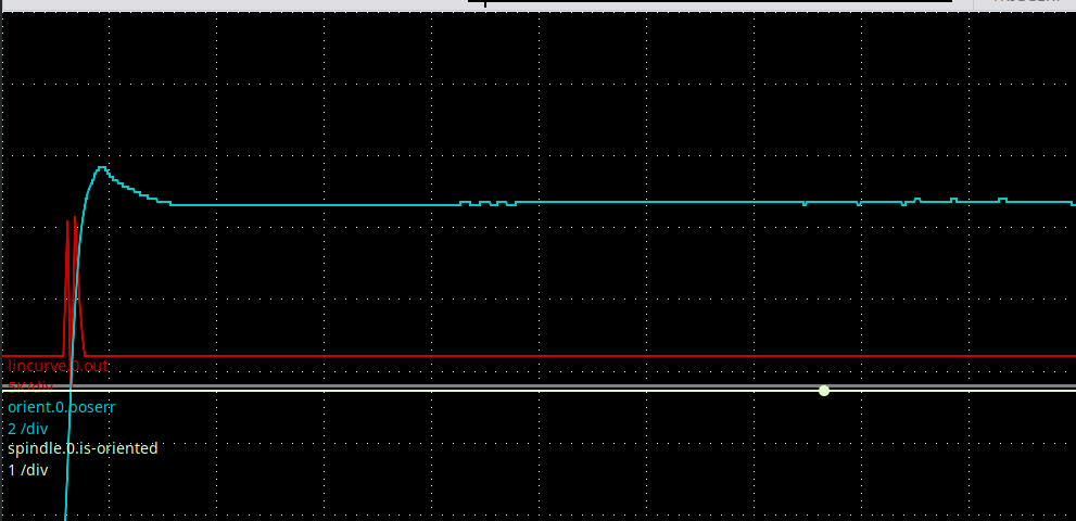

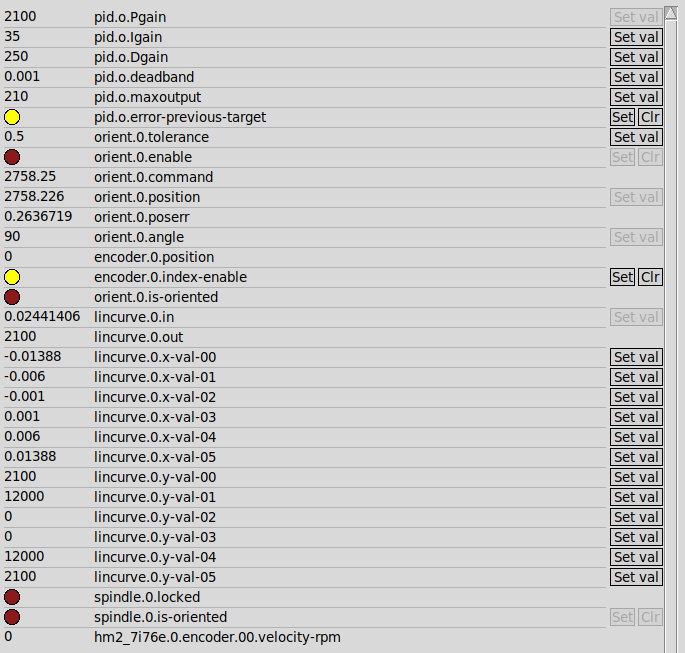

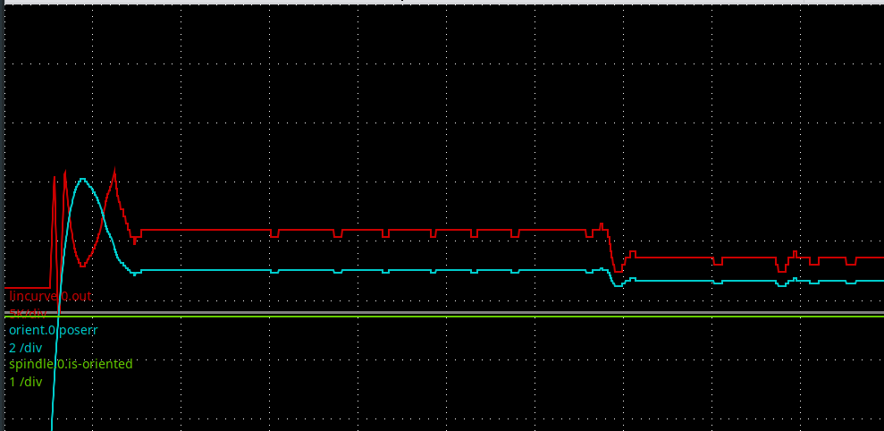

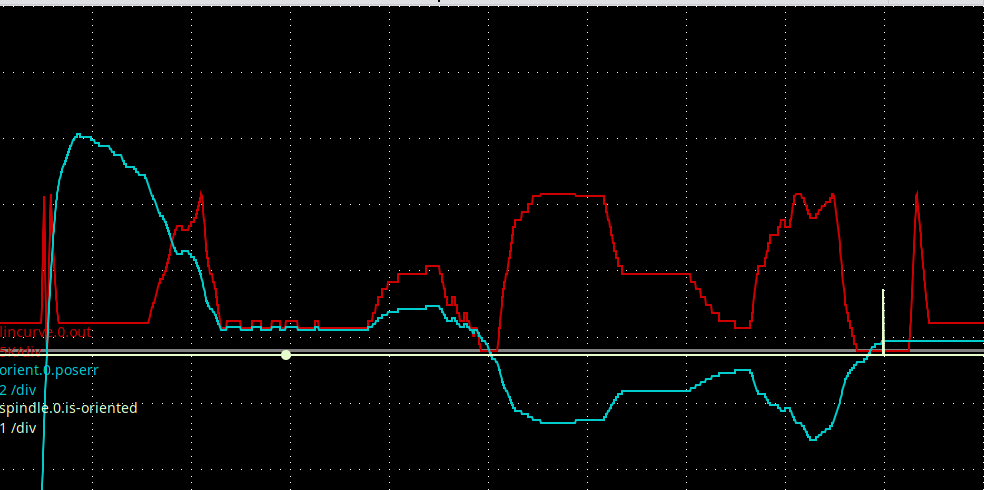

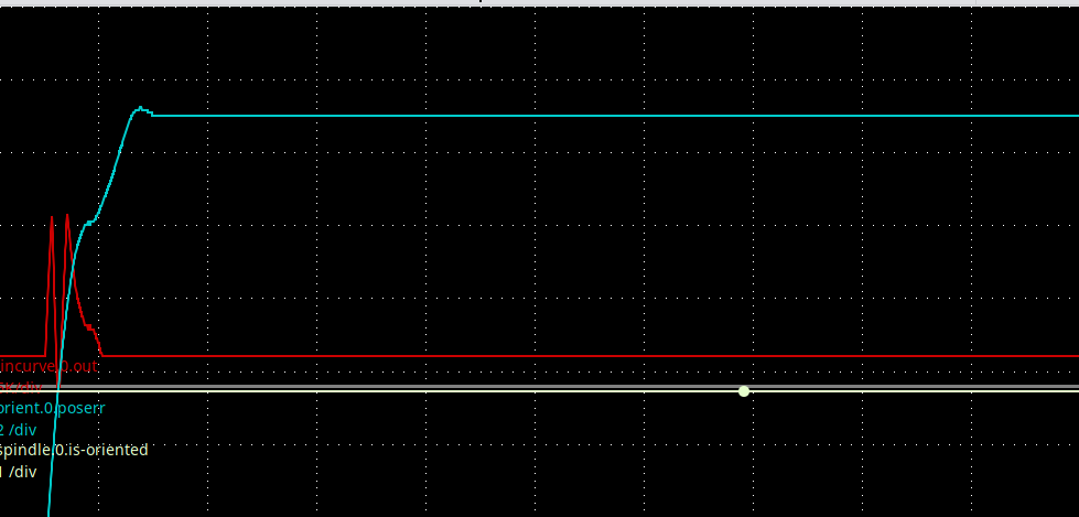

11 Jun 2022 17:31 #244962
by spumco
Replied by spumco on topic Spindle orient PID tuning? [So close but no dice]
While not back to square 1, orient is starting to aggravate me.
It's not repeatable. I can run an M19 orient command four times in a row, and it doesn't respond the same way twice. I set up a halscope to see if that helped make sense of what's happening.. but it isn't helping me understand the seemingly random responses.
I've got a simple little program to run the spindle for a couple seconds, stop it, then orient. I'm giving it 3 seconds to orient before it throws an error.
Multiple tests with the same lincurve & deadband values result in wildly different results. It usually orients the first or second time if I tweak an input value, but after that it's hopeless. Or it will fail four times in a row... then it nails the orient in less than a second.
Adding a little (relatively) I-term seems to have helped, but it's not what I'd call reliable.
Multiple screen captures attached - all are with the same settings. First one nailed it, remainder failed.
- Posts: 18119
- Thank you received: 5337
11 Jun 2022 21:06 #244969
Replied by PCW on topic Spindle orient PID tuning? [So close but no dice]
My take on this is discard lincurve and fix the orient component so it outputs
a followable motion command (add orient velocity and acceleration constraints)
That way the PID heavy lifting will be done by FF1 like a standard velocity mode
servo. Step command inputs and integral terms don't get along very well
