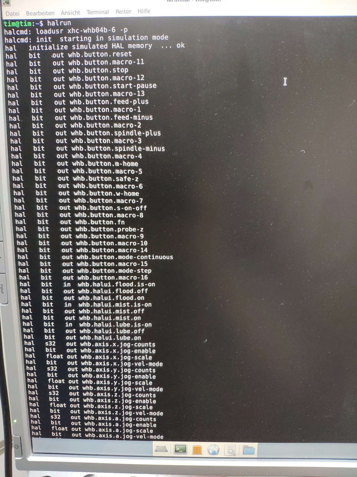

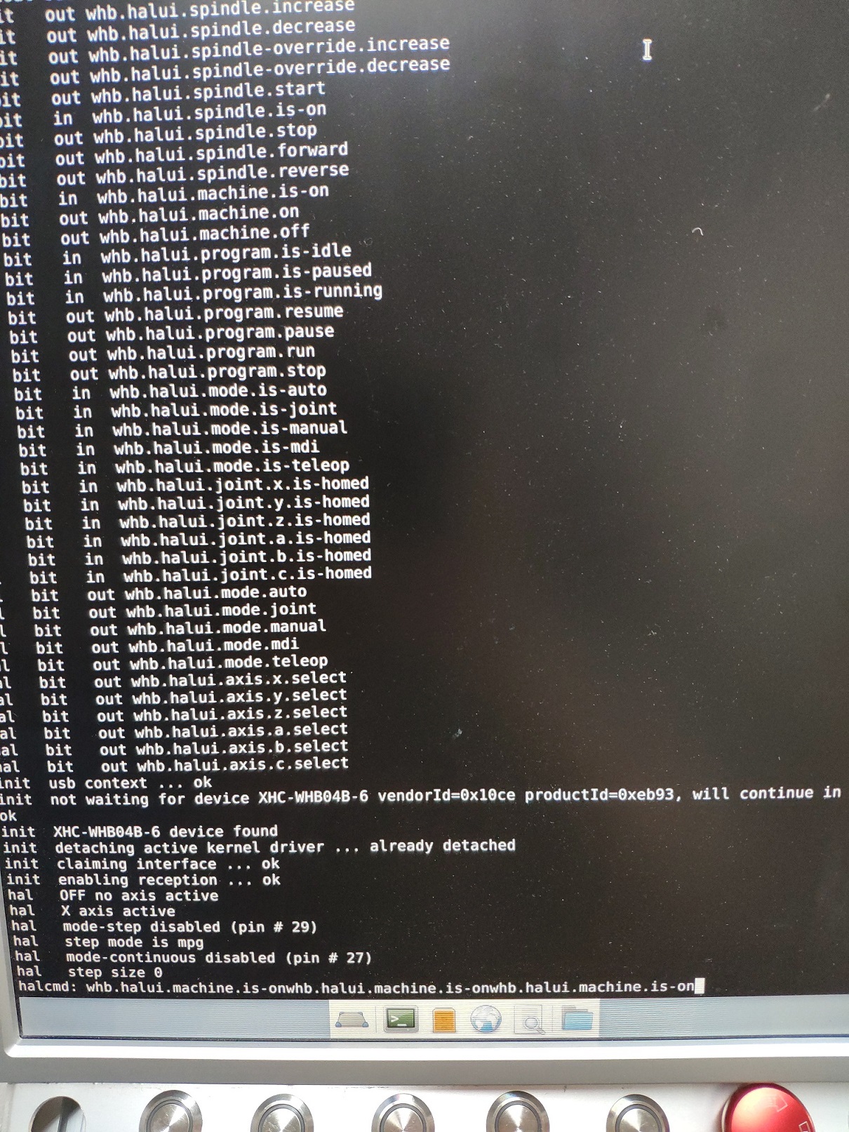

Hi,I want to run my WHB04B-6 pendant. Installed and compiled everything according to talla83. Everything worked fine.Communication with the handwheel via terminal also works. running "halrun" and loading "loadusr xhc-whb04b-6 -ue" it transfers data such as "selected axis".
To my problem: When starting LinuxCNC with defined pins, such as "whb.halui.joint.x.select", it returns an error "pin whb.halui.joint.x.select does not exist" and won´t start LinuxCNC. When only loading the xhc-whb04b-6 component, it shows the pins in my hal whb configuration. Any ideas?

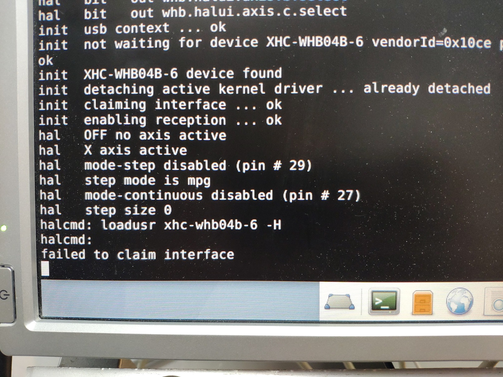

10 Jun 2022 11:05 #244881
by mittim
Replied by mittim on topic whb04b-6 - pin does not exist
When running in terminal with different component-functions, that´s what I get. It seems, the problem starts, when the component is started with "-H" as Hal-mode.

10 Jun 2022 12:23 #244888
by chris@cnc
Replied by chris@cnc on topic whb04b-6 - pin does not exist
Is there any reason why compile this comp? Usually work this more or less out of the box. I used in 2.8. and 2.9. without any trouble. I also pull out the receiver and linuxcnc start up without any message. So there maybe something wrong with your installation

10 Jun 2022 12:27 - 10 Jun 2022 12:29 #244889
by mittim
I did not know this comp is included already. Maybe I will delete my linuxcnc and pull master branch new.
I can remeber, there was already a BIN file in the /usr/bin directory with the same name as the one, I was compiling according to talla83. Maybe that screwed up something.
