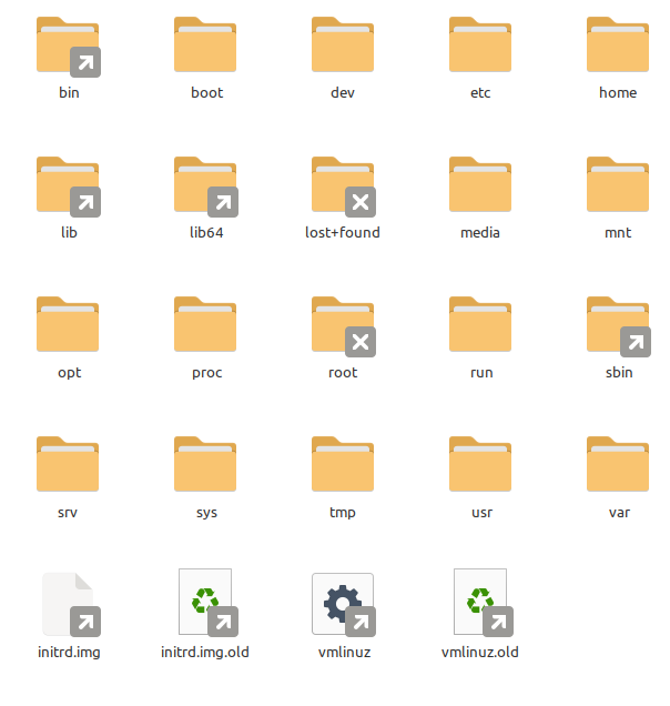

- Posts: 4819
- Thank you received: 2177
16 Jul 2024 03:32 - 16 Jul 2024 03:53 #305327
just checked on 2.9.2 installed through the package manager on a LMDE system , 'halcmd.h' is located in '~/linuxcnc/src/hal/utils'
see below
Replied by Aciera on topic emc.hh -- hal_priv.hh --- etc etc not find
see below
Last edit: 16 Jul 2024 03:53 by Aciera.
The following user(s) said Thank You: bkt

- bkt
- Posts: 1111
- Thank you received: 114
16 Jul 2024 03:41 - 16 Jul 2024 03:47 #305329
by bkt
Sorry and ~/ means for xxx/home/linuxcnc or /linuxcnc ... because I install from package manager too .... 5 month ago ... than start now to check again my new project and not find that folders .... all linuxcnc is on ~/lib, ~/usr/share, ~/bin, ~/etc .... there are not folder named ~/linuxcnc .....
Replied by bkt on topic emc.hh -- hal_priv.hh --- etc etc not find
Last edit: 16 Jul 2024 03:47 by bkt.
