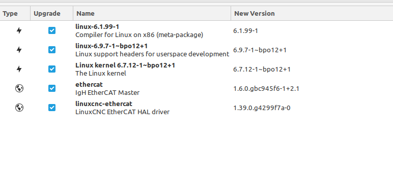

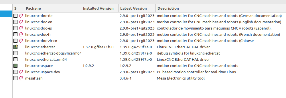

oh ... I check my past actions .... pakage manager is right ... so only 2.9.0 version is admitted .... but I've installed manually a deb package for 2.9.2 .... so now think need deb pacakge for 2.9.2 linuxcnc-uspace-dev ... where find it? ... sorry i'm not usual with forum and all update of Linuxcnc repositories ...
ŗdw my question is related to re-install deb package ... so can simply remove 2.9.2 linuxcnc istallation and than reinstall the correct version or need to remove ethercat too?
so now I have these situation in package manager (if note is quite clear because not possible install uspace-dev ... there is not 2.9.2 version):
plus in update manager have these one (can not update to 6.7 kernel ... not sure is rt-preempt one):
not know if can update without need to remake all again (mac adress, udev rules, 666 permission etc etc).
regards
regards

A later deb in a repository will upgrade if you do apt install again. If you go to the 2.9.3 docs and find the Getting Linuxcnc doc,
Heading 7.1 has a script that sets up sources to the Linuxcnc repository
You could try that.
You could try that.

so you suggest to update all ... linux kernel and ethercat ... and after reinstall all??

so at least have download 2.9.2-dev package and install it, upgrade ethercat as repositories suggested me ... NOT upgrade kernel. After these ethercat stop to connect to lcnc but not stop to work (lcsc_conf not find error become present) ..... so re-install linuxcnc-ethercat package and all work again like a charm.
for first problem, solution is: install -dev package, install a rip version until "make" stesp ...whitout really install .... only compile it. At these point all lcnc libs become avaiable for new c++ gui app.
May be not needed, never try, for sure hal-priv.h is difficult to reach if in root folder ... for sure if need to compile a new kinematics for example .... have a rip install for only compile is an helph. After compiled kins or libs you can move in right folder of your lcnc real installation.
regards
