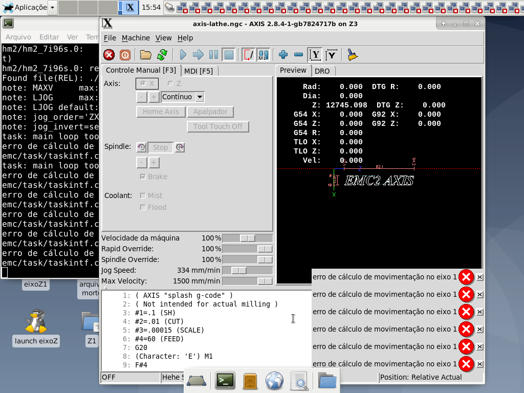

Thank you, it solved the problem, the screen is showing the correct display.
But when I try to start the machine, the message "error calculating movement on axis 1" appears. I tried to change the max_limit and min_limit values in the INI file, but without success.
When this error message appears, is it possible to see in more detail which configuration is still wrong?
Do you have any tips or examples of how I should configure axis 1 so that the error does not appear?
Below are the HAL and INI files for your consideration.
