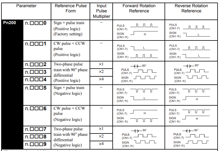

- jblanscett
- Posts: 24
27 Feb 2026 12:09 - 27 Feb 2026 12:13 #343596
by jblanscett
Replied by jblanscett on topic Trying to set up position control mode
Hi PCW,
I hope this is what you are talking about. We have our pn200 setting set at 5. Let me know if there is anything else I'm missing. Thank you for your time.
Last edit: 27 Feb 2026 12:13 by jblanscett. Reason: Picture showed up as text
- Posts: 18114
- Thank you received: 5332
27 Feb 2026 15:40 - 27 Feb 2026 15:47 #343605
Replied by PCW on topic Trying to set up position control mode
Do you have the step/dir pinout information for the drive?
It does look like it may be single ended from the pictures of the
step/dir modes.
Also in your .ini file, you have the PID P term set to 0.
This should be 1000 (for a 1 ms servo thread period)
A 0 P term will cause position drift
step/dir modes.
Last edit: 27 Feb 2026 15:47 by PCW.

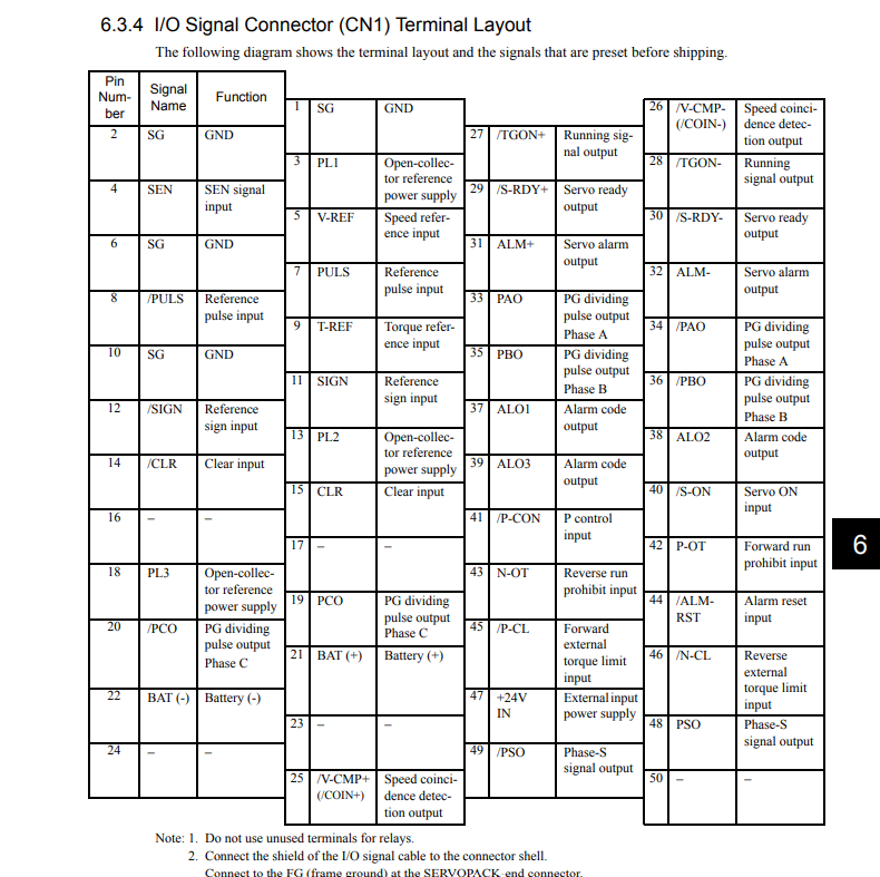

- jblanscett
- Posts: 24
27 Feb 2026 17:27 #343616
by jblanscett
Here is the connector layout. We have the P value set to 0 because we aren't able to get the axis to move when it is set at 1000. I thought we would try to get the motion working better before worrying about it. If we need to figure that out first, I can work on that first.
Thanks,
-jblanscett
Thanks,
-jblanscett
- Posts: 18114
27 Feb 2026 20:07 #343621
1. A 0 P term will not work as it will drift it must be 1/servo_period
(1000 for a 1 ms servo thread period)
2. It looks like the step/dir inputs are differential so:
Drive 7I95
7 PULS Step+
8 /PULS Step-
11 SIGN Dir
12 /SIGN Dir-
