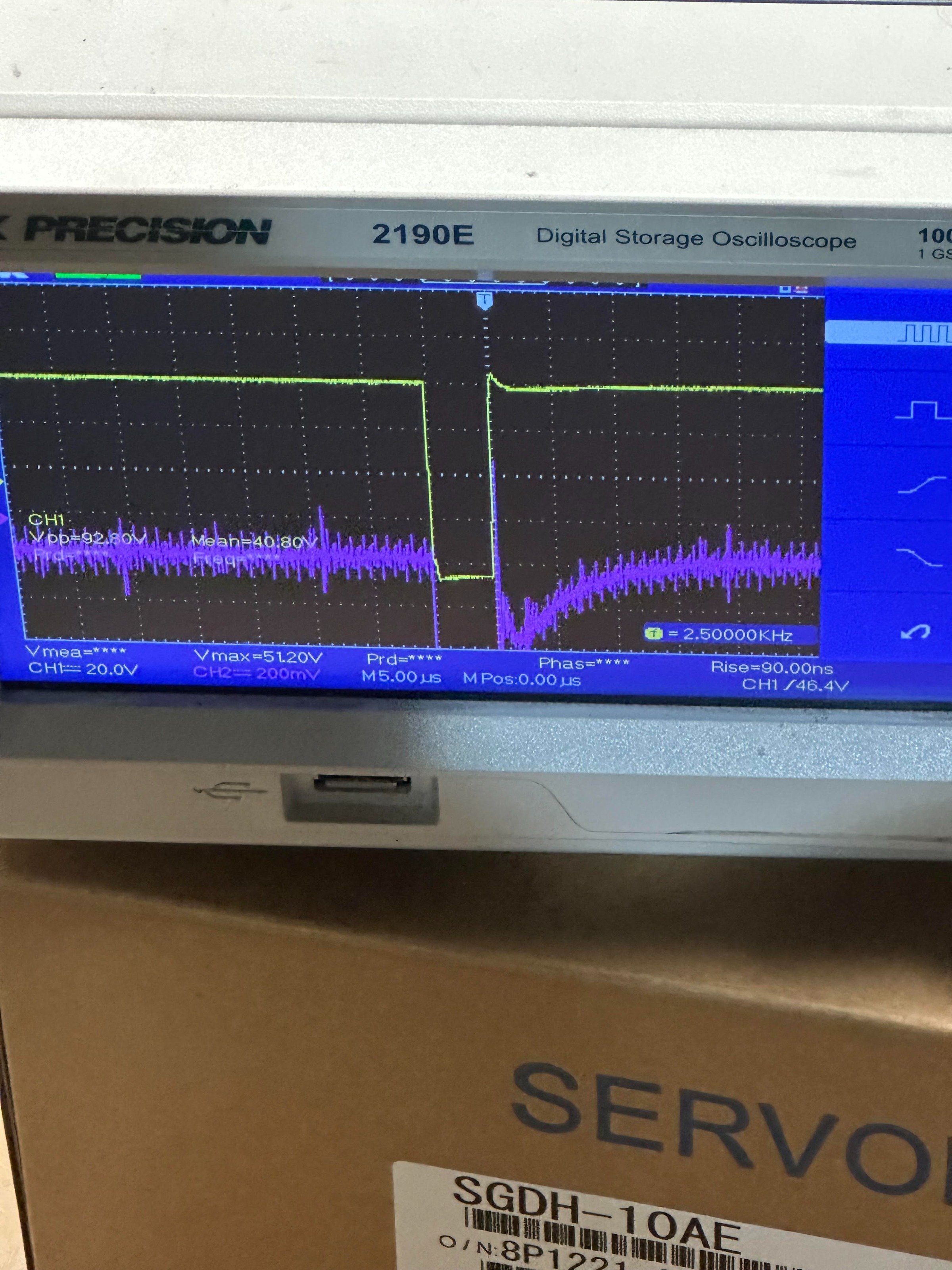

Here is a picture of our oscilloscope readings
- jblanscett
- Posts: 24
04 Mar 2026 12:28 #343834
by jblanscett
Replied by jblanscett on topic Trying to set up position control mode
I have the first probe connected to the signal and the second probe connected to the mesa ground and the electrical box ground.
- Posts: 18114
- Thank you received: 5332
04 Mar 2026 16:15 #343848
Replied by PCW on topic Trying to set up position control mode
When you say the motor moves, are you saying the DRO is changing
when no commanded motion is requested?
Do you get a following error?
