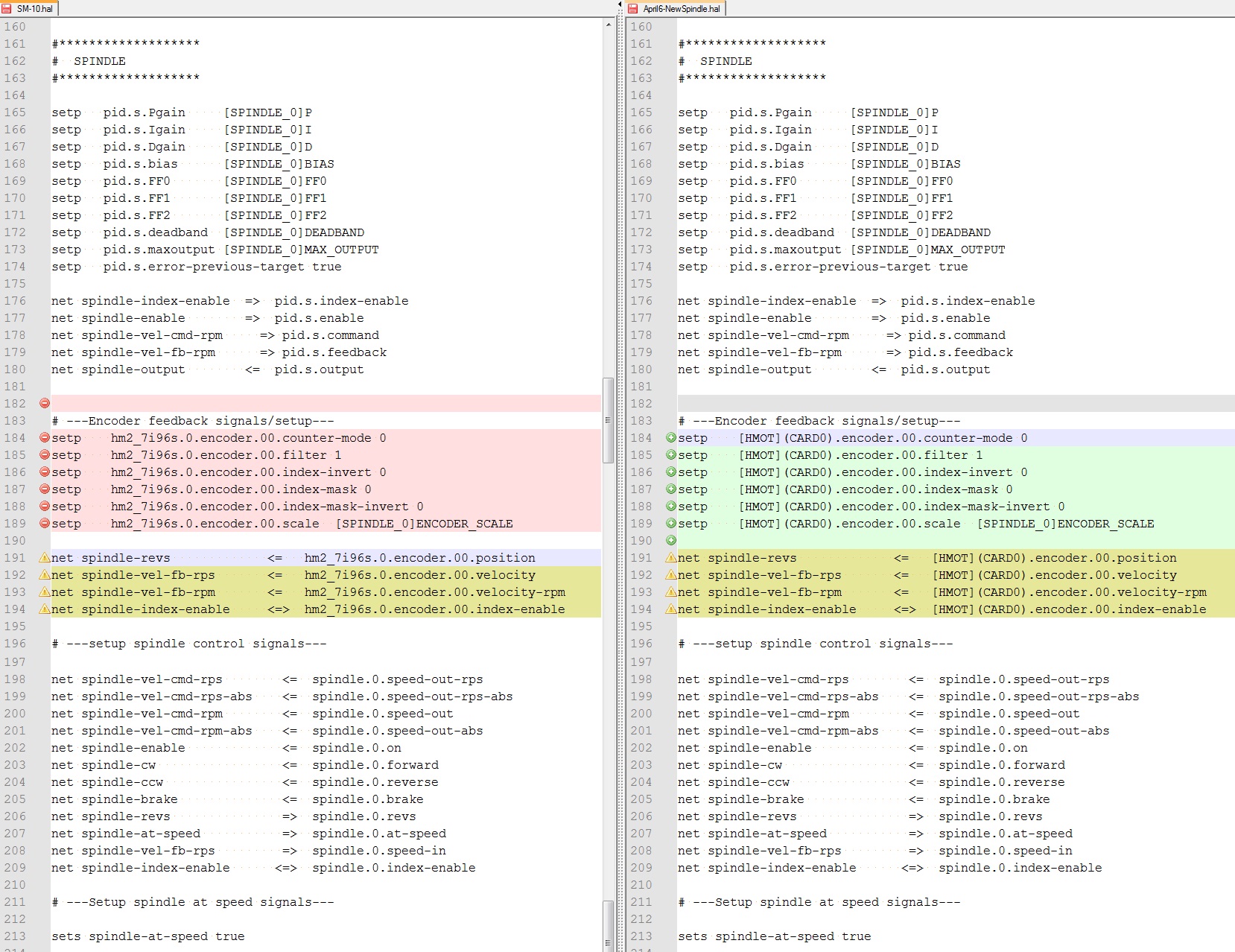

I made a new configuration using pncconf and compared the spindle & encoder 0 section.
I don't see anything that's different, other than naming conventions (see attached)
I have a quadrature spindle encoder connected encoder (0) input. A & B
I now also have a 1PPR signal, connected to the encoder.0. index pin.

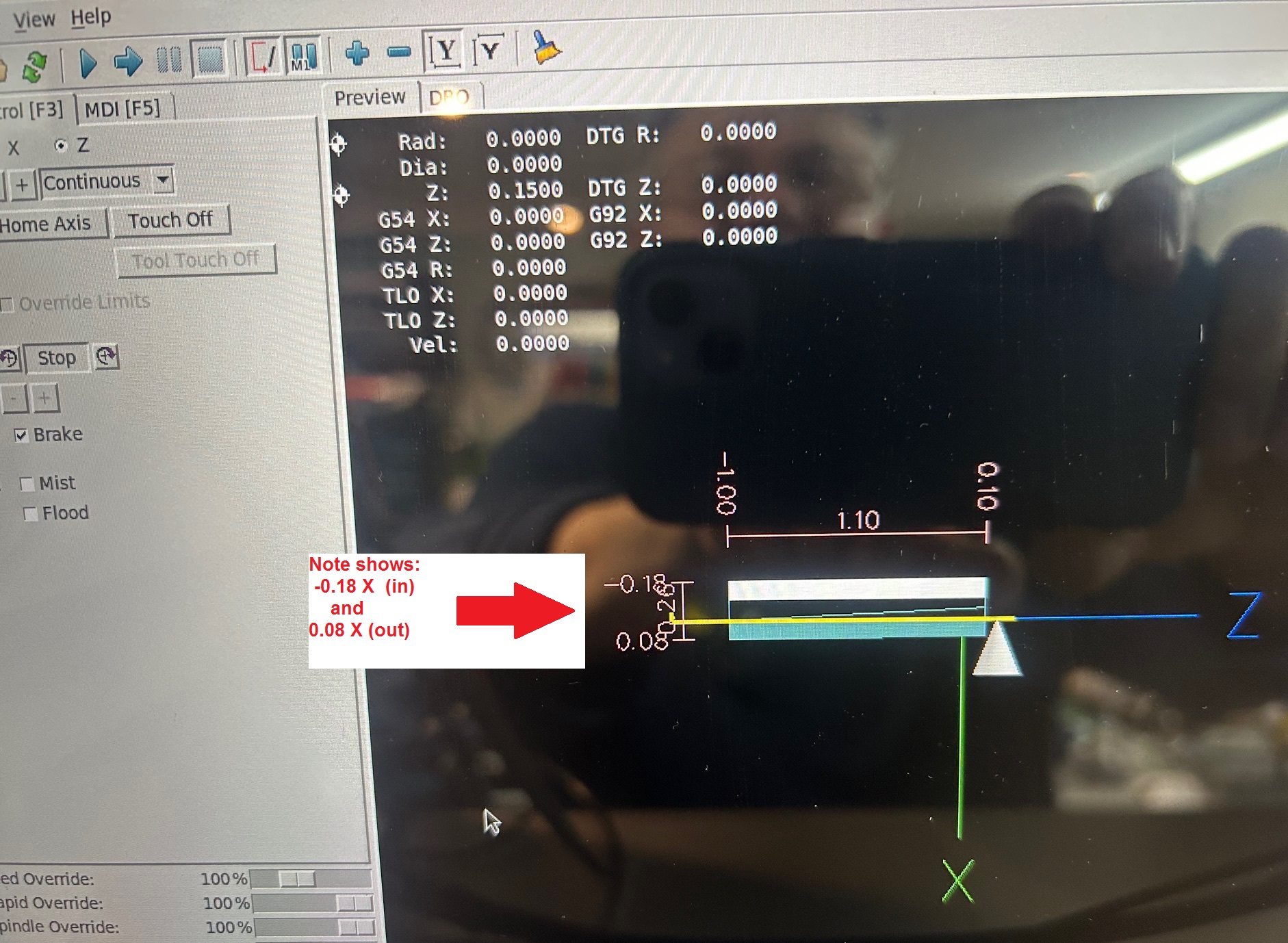

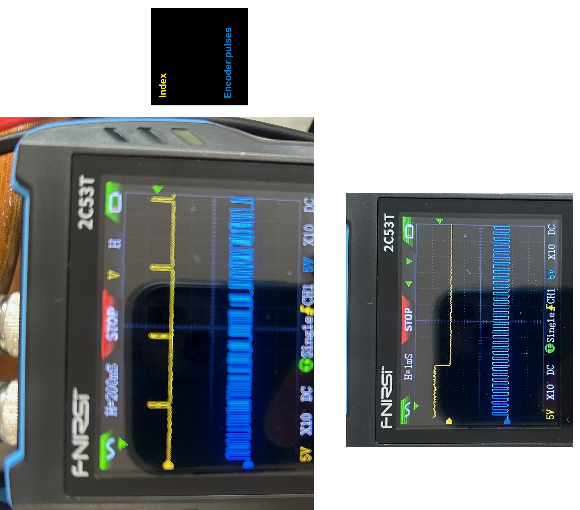

I scoped with an actual scope the index signal as well as the other spindle quadrature signals and they are as expected (not sure on the polarity of the index pulse. It is low for most of a spindle rotation, with a brief blip high once per revolution.The program now runs, however it cuts and retracts in the wrong direction (X wise). It seems that the G76 command thinks more negative X is towards the center of the spindle center line and more positive is out and away from the spindle centreline.Even the graphic, shows -X towards the centerline ie. a deeper cut is more negative X), please see attached. Interestingly the animated graphic, shows the correct motion with a slow cut to the left then retracting out for the non-cutting return Z movement in the real world -X direction (labeled as positive X in the graphic), and then cutting progressively deeper (real world X, graphic more negative X) on each pass..ngc file is as follows:

2) Also does the index work? Yes, it is low for most of the revolution, and blips high momentarily as the magnet passes,See scope capture.

If I change the sign of the "I" term from negative to positive (which should change from external to internal thread mode), the program correctly cuts the thread, The graphic representation in axis shows an internal thread being cut, but the actual action is external resulting in a perfect thread.
