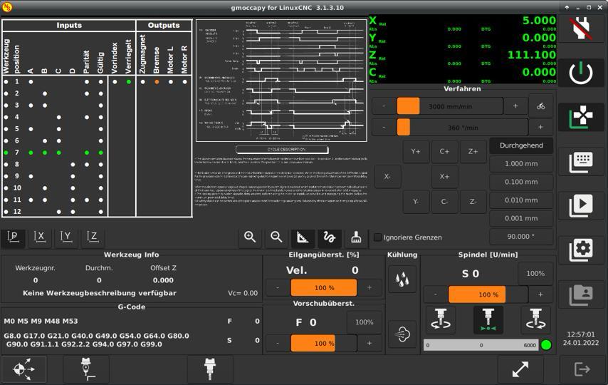

I attach the configuration files to handle the turret. The only difference with yours is that the one I have did not have the encoder and I had to design one, but without the use of parity pins, you can add it by modifying the turret.hal file. My turret only has a 6-position tool changer while yours has 12, that's not a problem, what I did was design my encoder to only detect 6 positions and only use 3 sense pins to get a maximum of 8 combinations, with your encoder you can do all 12, adding another sense pin to the turret.hal file. As I explained in this thread, the turret originally works bidirectionally, but I could not get it to work that way because the carrousel component does not allow it. In this thread they also discuss this type of turret forum.linuxcnc.org/10-advanced-configura...ute-encoder?start=30. I have to search my notes because I found in another thread someone who designed a component for a turret that works the same as the one we have, but is manufactured by another company. This component does allow the turret to work in a bidirectional manner.

11 Feb 2025 12:18 #321231 by Surmetall
Replied by Surmetall on topic TURRET TOE100
Thank you so much for the data, that made my day!
as soon i have the hardware i will try to get it running. If i have time in the i will try to make a GladeVCP screen for the turret.

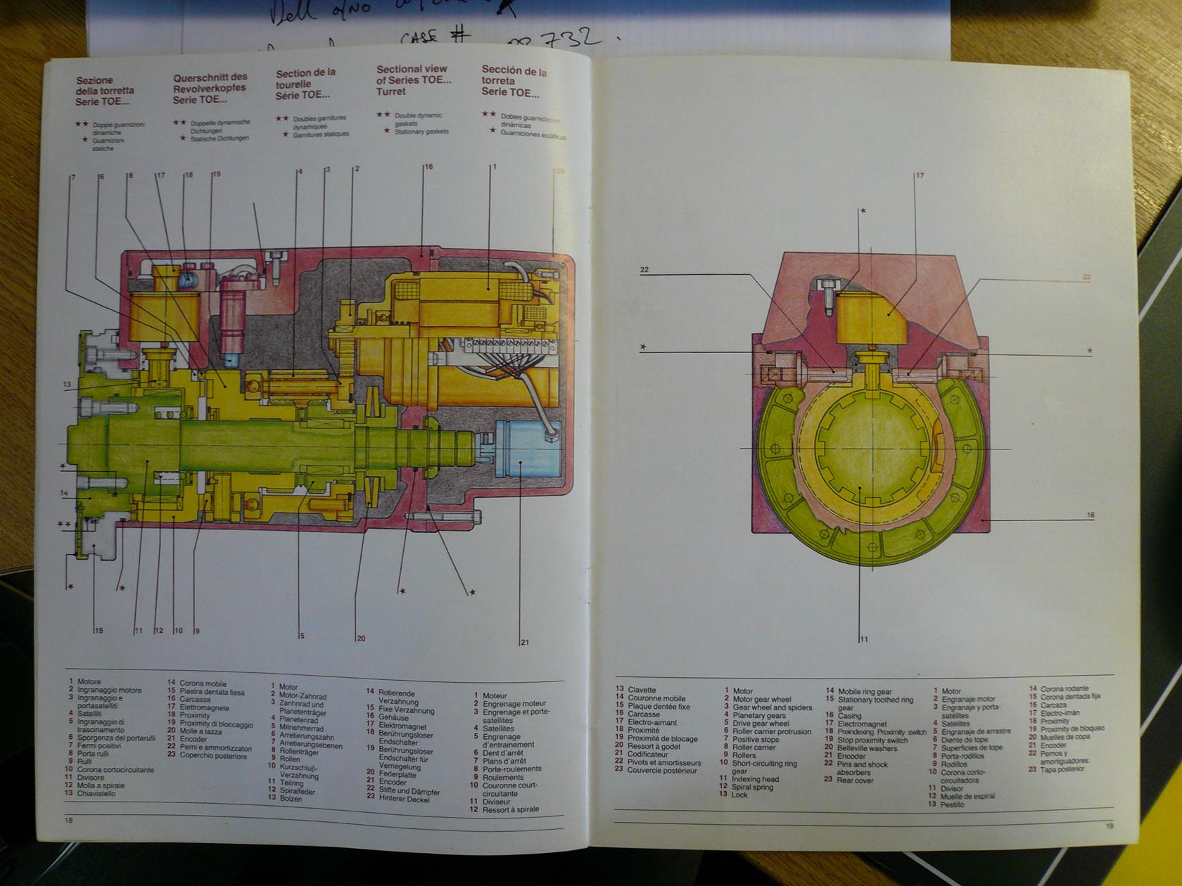

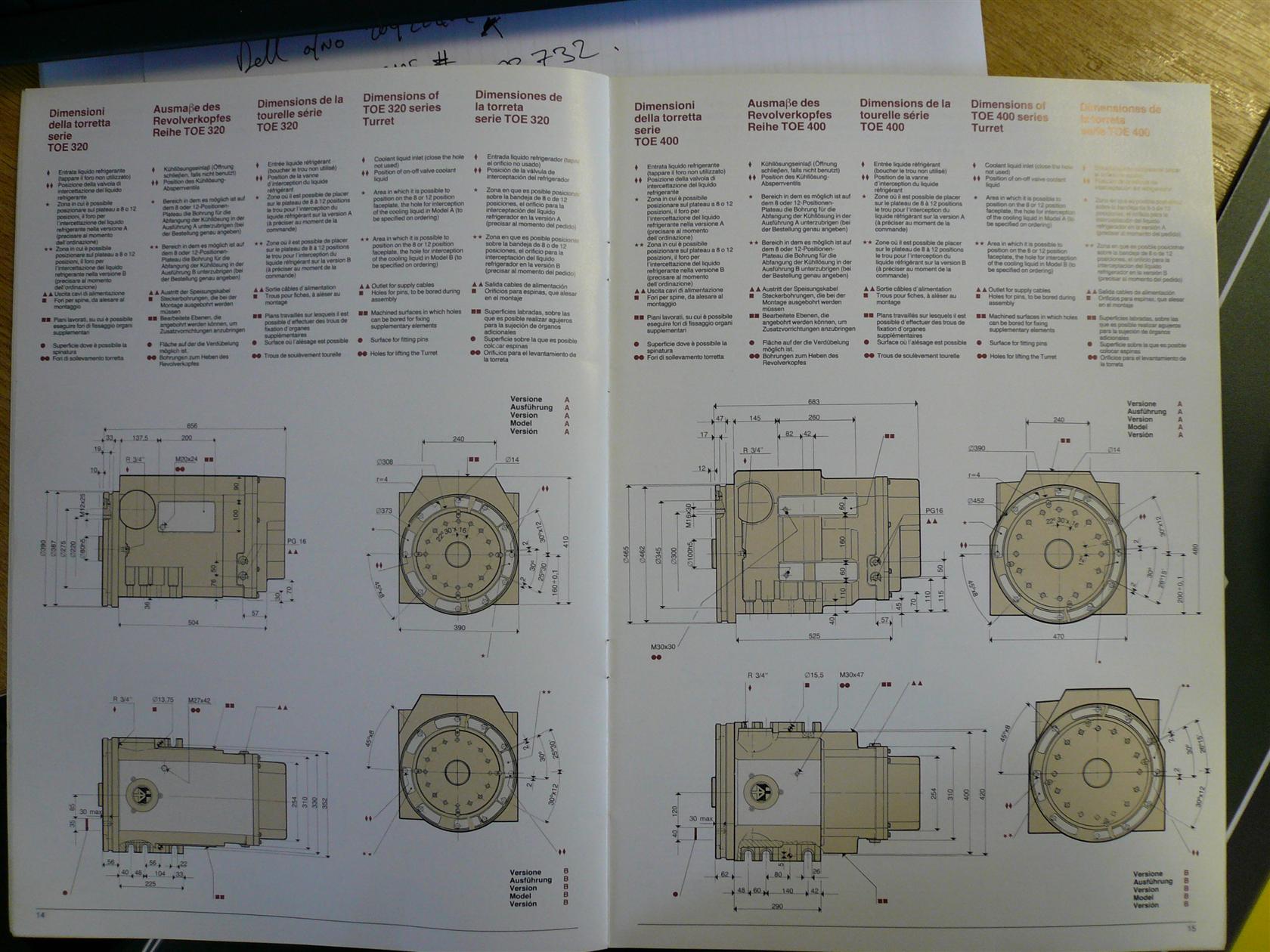

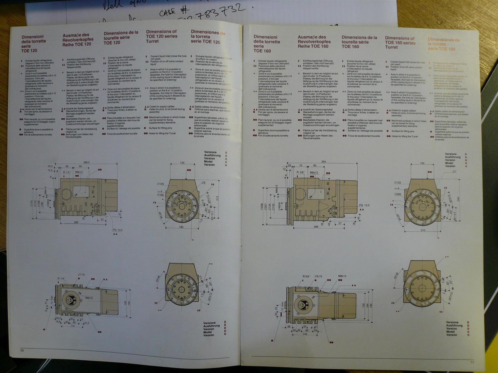

12 Sep 2025 06:26 - 12 Sep 2025 06:31 #334861 by ziggi
Replied by ziggi on topic TURRET TOE100

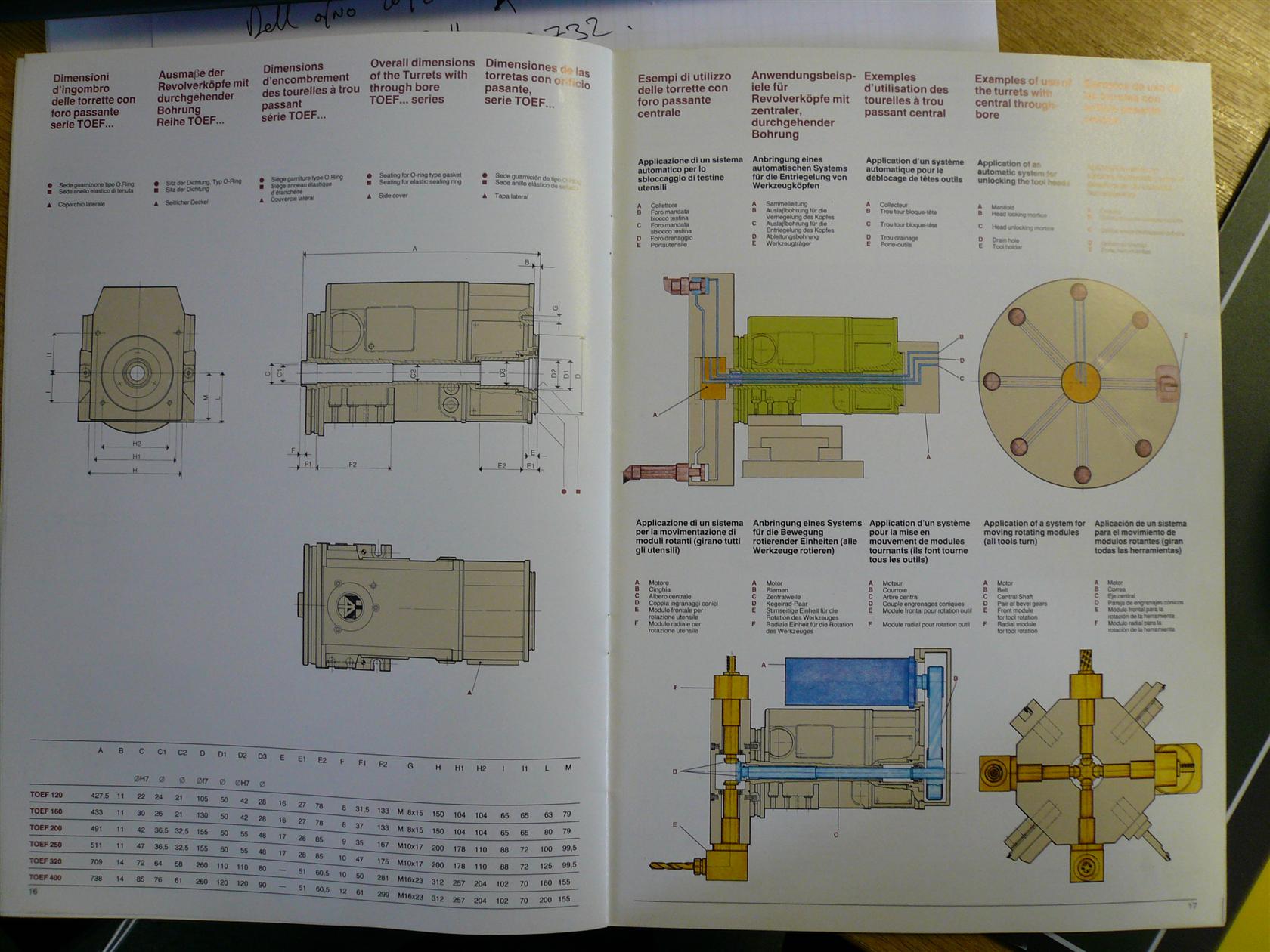

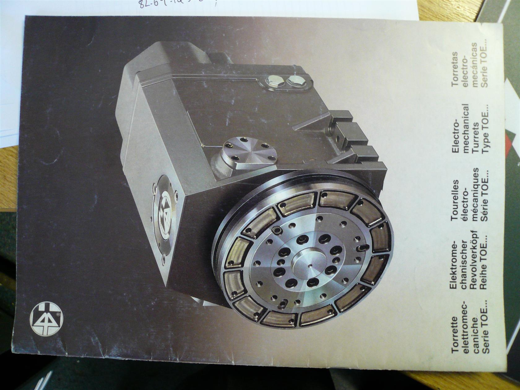

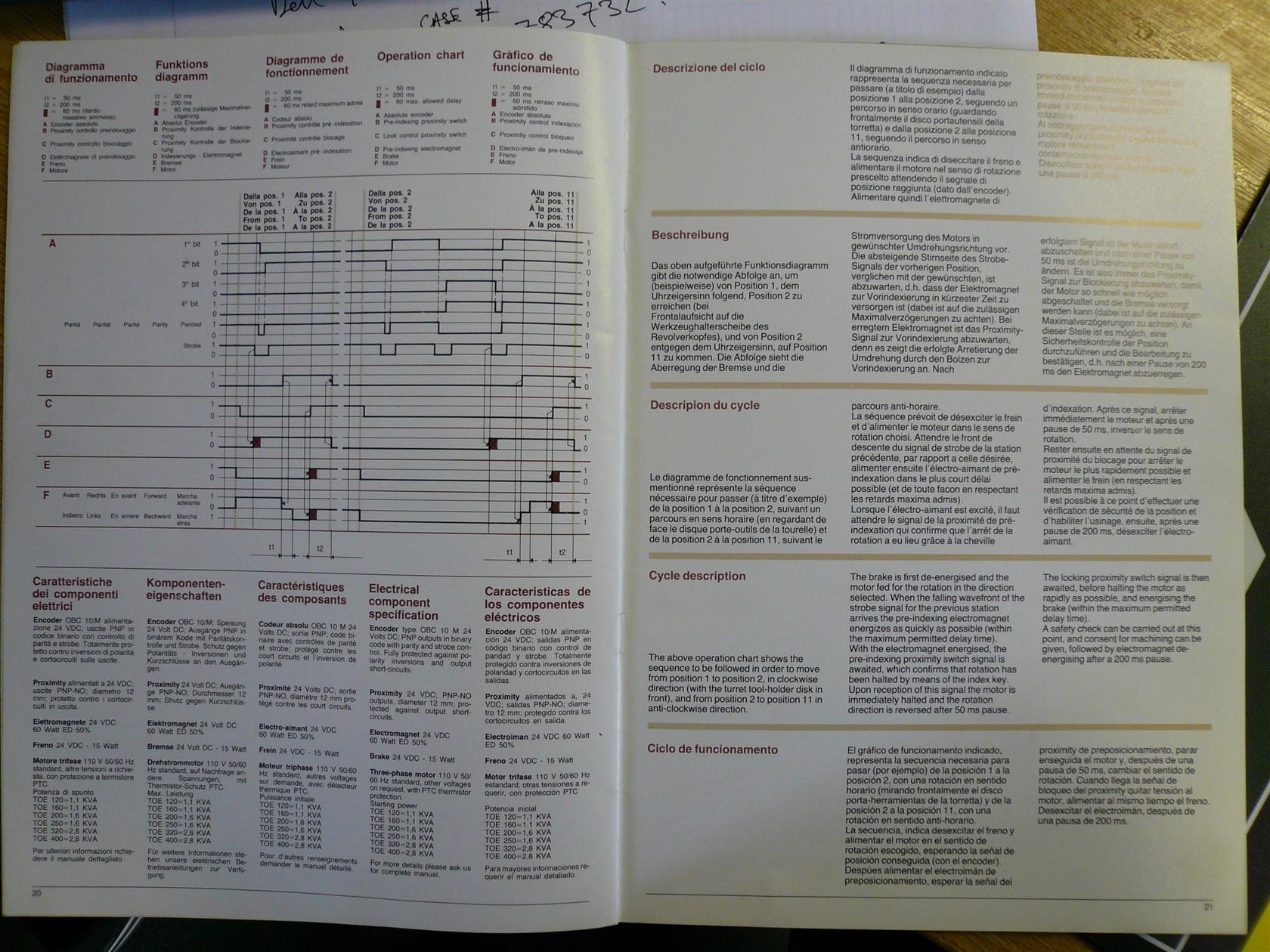

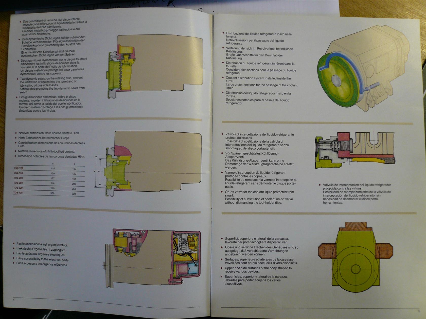

Sorry I can not really help, but searching for infos on my Baruffaldi RH80 I found some infos in the internet that can at least help to identify Baruffaldi toolchangers and show some of the interior, nothing to technical- just pictures of a brochure. But might be potentially helpful for anyone searching for infos on his Baruffaldi TC:
Last edit: 12 Sep 2025 06:31 by ziggi.
The following user(s) said Thank You: Surmetall

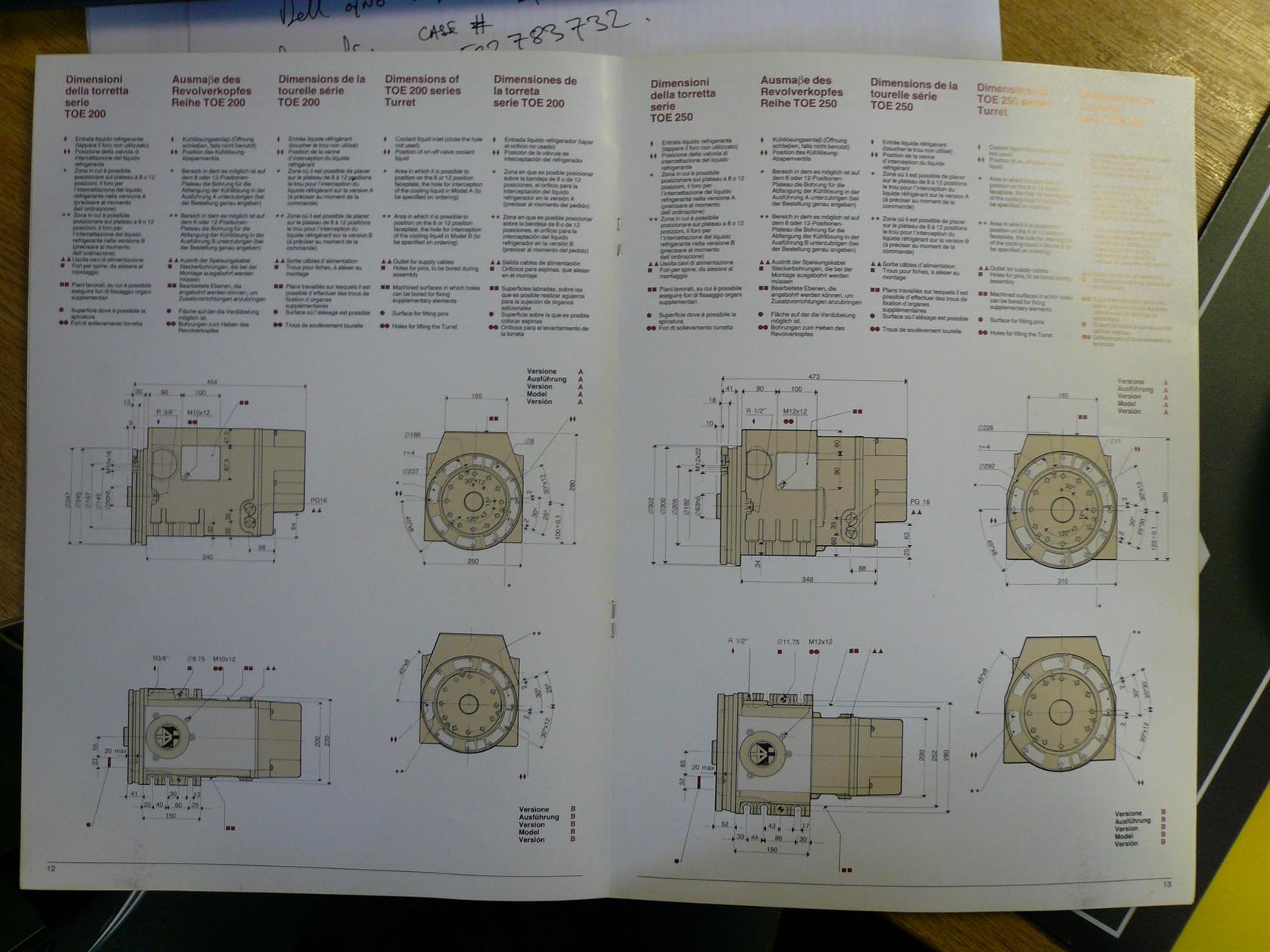

12 Sep 2025 06:28 - 12 Sep 2025 06:29 #334862 by ziggi
And the rest
Last edit: 12 Sep 2025 06:29 by ziggi.

12 Sep 2025 08:16 #334867 by Surmetall
How cool is that! I love the coolored section view. Thank you very much for sharing.
Greetings
Tom
