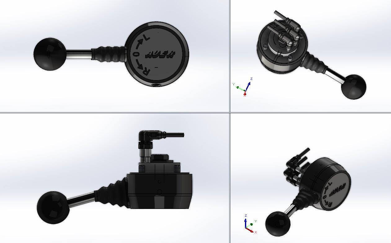

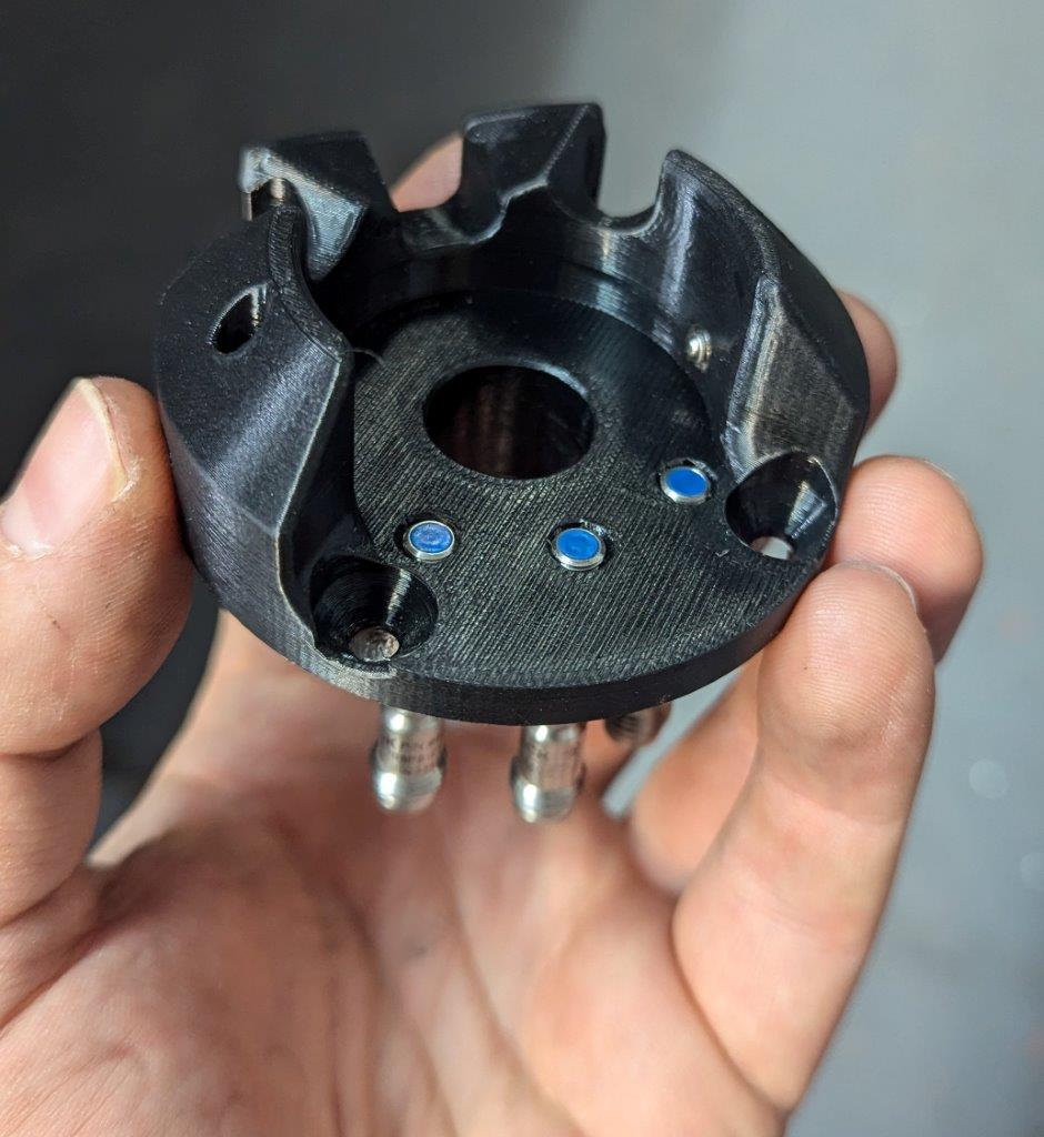

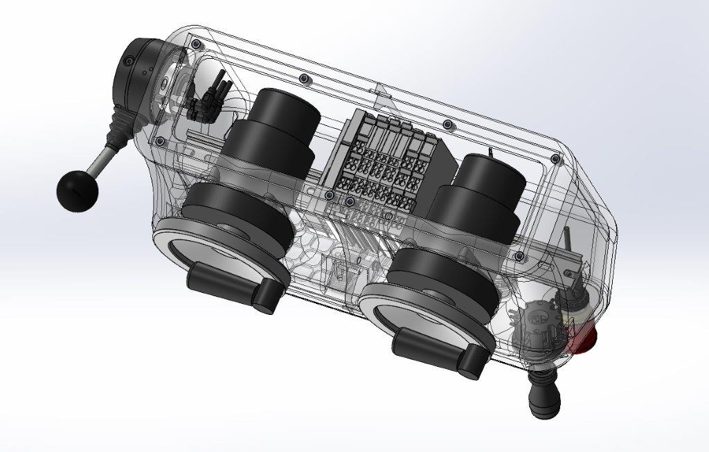

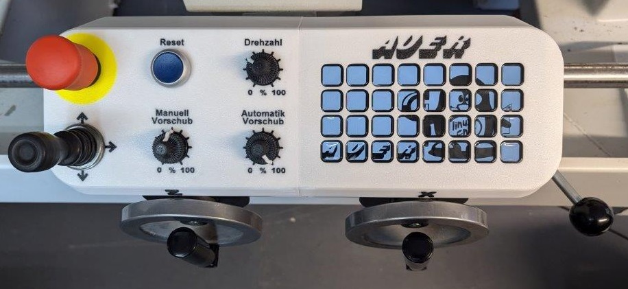

03 Jul 2025 18:45 #331177 by Surmetall

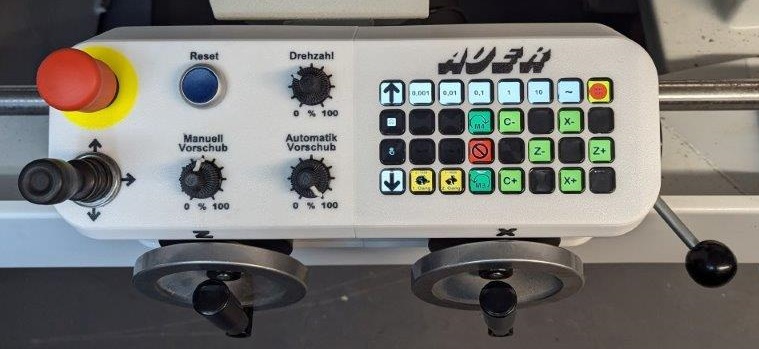

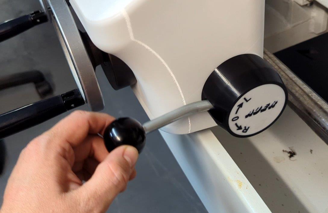

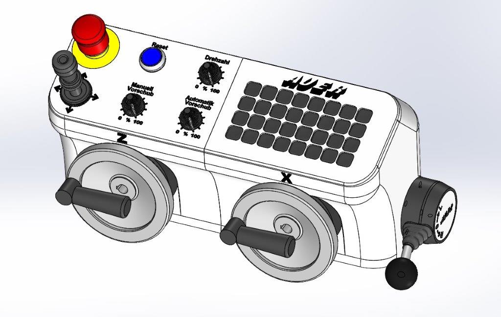

Hardware of the Handwheel/Keyboard is ready now :)

04 Jul 2025 09:45 #331224 by pippin88
Awesome!
What are those magic display buttons? Link?

05 Jul 2025 07:21 #331301 by Surmetall
Hello pippin,
Thanks! :)
its called "Streamdeck" in my case the XL Version. Its a programmable lcd wirh buttons. Streamers/Cutters/etc use it for shortcuts and so on.
Smarter people than me are working on it to make it even more usable with LinuxCNC!

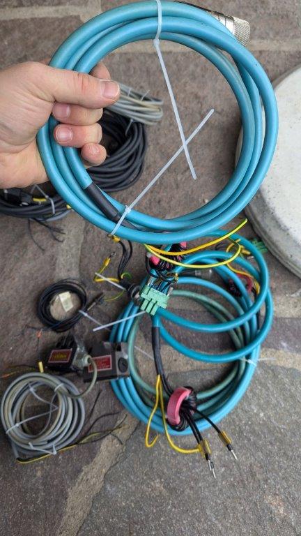

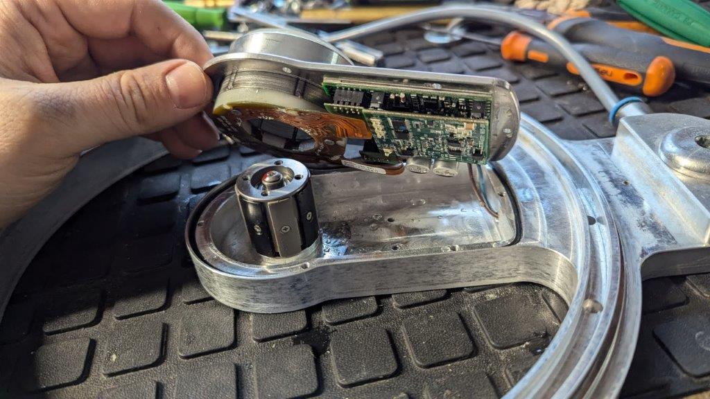

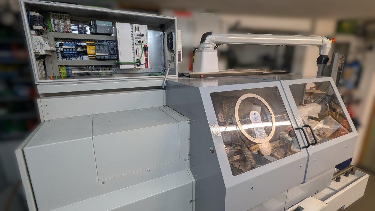

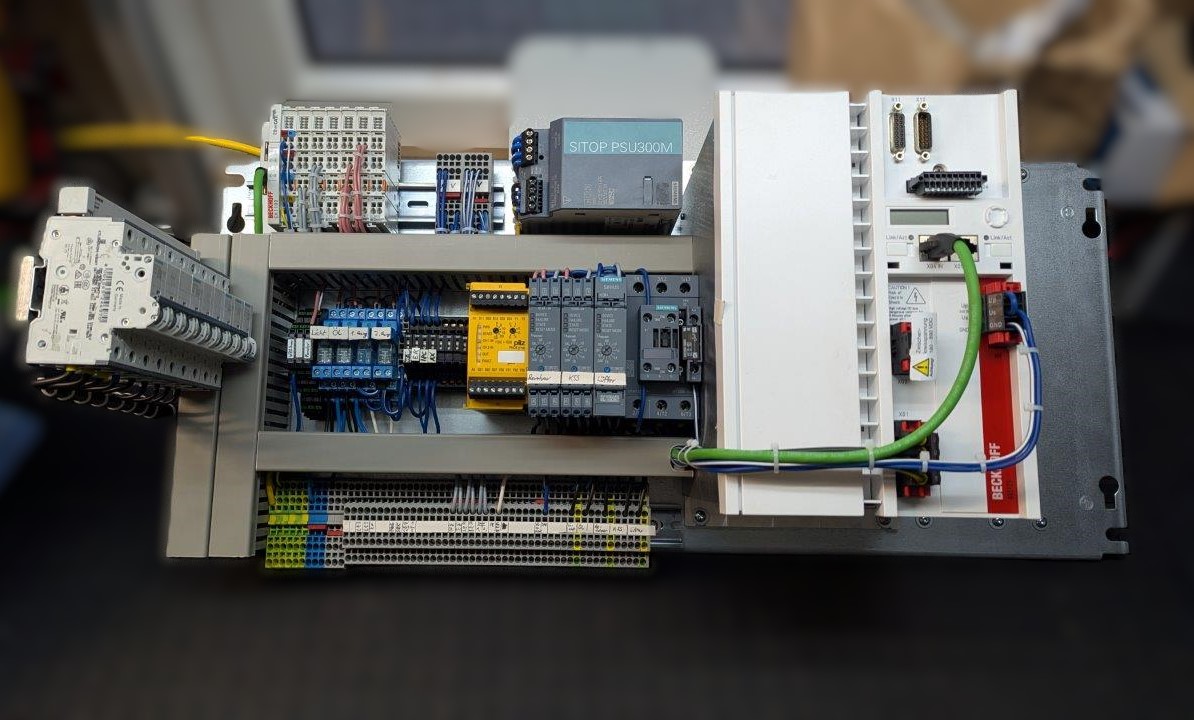

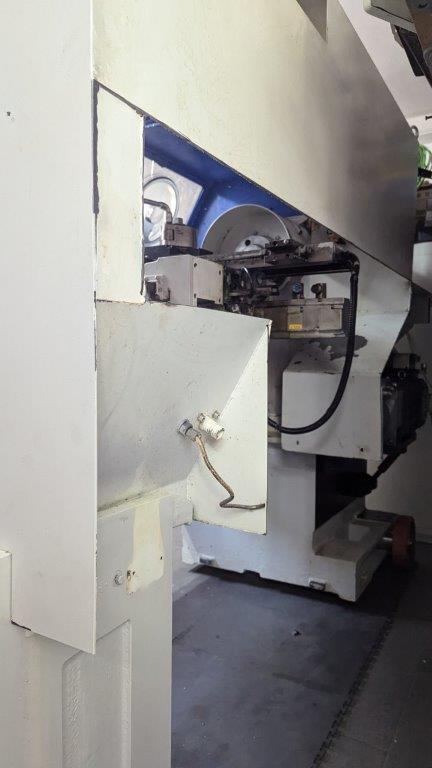

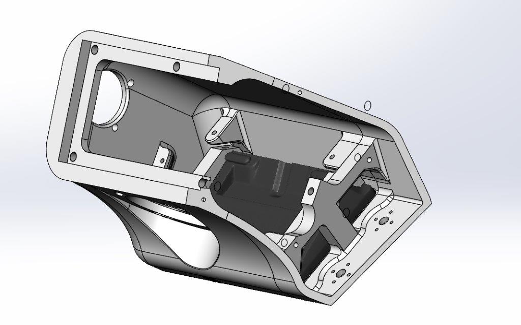

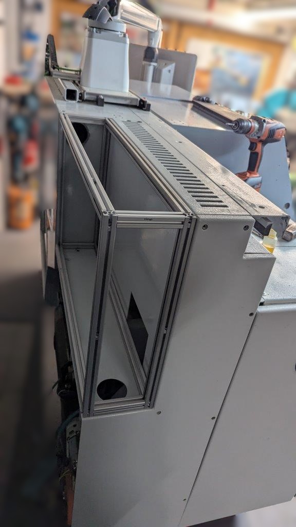

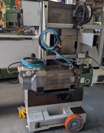

03 Jan 2026 13:04 - 03 Jan 2026 13:07 #340918 by Surmetall
Hello All,

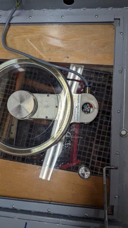

things are slowly getting serious. I have reduced the size of the machine’s rear panel, repainted it, and mounted it again. I also cleaned up the wiring and repaired a few things, including the rotary window and the external fan of the spindle servo. In addition, I have started building the control cabinet and some parts are already wired.
Current hardware setup: a Beckhoff AX5125 for the spindle servo. I am still struggling a bit with TwinCAT and the parameterization. Beckhoff EL1100 via EtherCAT, various I O modules. some encoder modules, and the drives for X and Y are still missing. Some of the I O is already working and I am starting to like EtherCAT a lot. :)For the gearbox shifting with ratios 4:1 and 1:1 and for lubrication I have already found some very good examples and I think I can handle that.
With other topics I am still a bit unsure and would appreciate some advice. Any links to documentation or things to read and learn would be very helpful.
First, spindle and C axis. What is currently the best way to approach this? I have already found a lot of information on the topic, but the solutions are sometimes very different and often seem not fully resolved. Are there any proven approaches or experiences you can share?

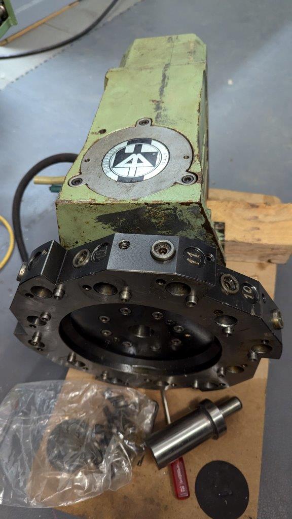

Second, the machine has a Multifix tool holder at the front, meaning a standard front tool setup with manual tool changes. I plan to install a tool turret at the rear, meaning a back tool automatic tool changer, which should be relatively easy to integrate using a carousel. Is mixed operation even possible? From a purely mechanical point of view there is nothing preventing this. For example, doing some operations with tools from the turret and others with the Multifix. Can LinuxCNC handle this so that some tool changes are automatic and machining continues, while for others it moves to a manual tool change position and prompts the user to insert the correct holder? Visualization is also an issue. As far as I can tell, it is not possible to switch between front and back tools or use both at the same time in the display.
To make things more complex, I am planning to mount the turret on a kind of quick change plate so that it can be parked very quickly in the rear right area of the machine. This is necessary to machine large workpieces with a steady rest using only the Multifix. I would like to disconnect the turret using a Harting connector. Is it possible to tell the machine via an input pin that no turret is installed so that the machine operates in front tool mode and does not attempt to use the ATC ? I would find it a shame if I had to treat this as two separate machines and could only use one type of tooling at a time.
Thank you very much for your feedback.
Greetings
Tom

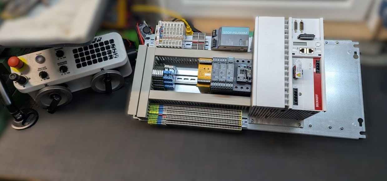

15 Jan 2026 17:56 #341435 by Surmetall
Does nobody have an idea or suggestion regarding the problems with my plans?
Lathes are probably rebuilt far less often than milling machines, unfortunately.

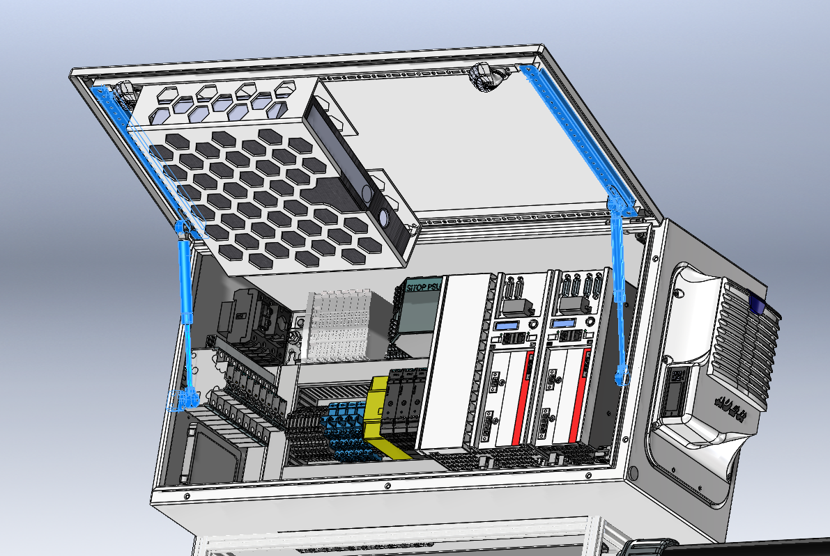

Well, in the meantime I continued working on the control cabinet. I had already planned the layout in CAD, and the effort put into that really pays off here.
First, I printed and attached a template, center-punched the holes and cut the threads, then cut the cable ducts and DIN rails to length and mounted them. A very pleasant, almost calming kind of work.
After that, I pre-wired everything and installed it in the cabinet. I also equipped the lid with a gas spring, and added a cable duct underneath the control cabinet.
The following user(s) said Thank You: tommylight, besriworld

15 Jan 2026 22:30 #341440 by tommylight
Sorry, but i forgot what your plans were, so i will have to go back and read again.
Way to busy lately...
  • tommylight
  • tommylight's Avatar
  • Away
  • Moderator
  • Moderator
16 Jan 2026 00:51 #341442 by tommylight
OK, lathe, so not my strong suite, so:
First, i am pretty sure it is doable, i am also pretty sure some of the forum users did manage to make this work fine and never bothered to report back on how they did it, and there are some with mixed success still active here.
Second, probably yes but never actually did that, although i would not mix manual and auto modes as inadvertently humans will mix those modes and on big machine that is always expensive.
As for turret/no turret pin, again most probably yes with some hal wizardry, might be quite easy i think.
Any way you look at it, almost anything within reason should be doable, although it is much easier to have 2 separate configs (not installations, just a config folder) and switch between them. I would like to insist on making this work first, then make another config for mixing and testing mixed mode.
