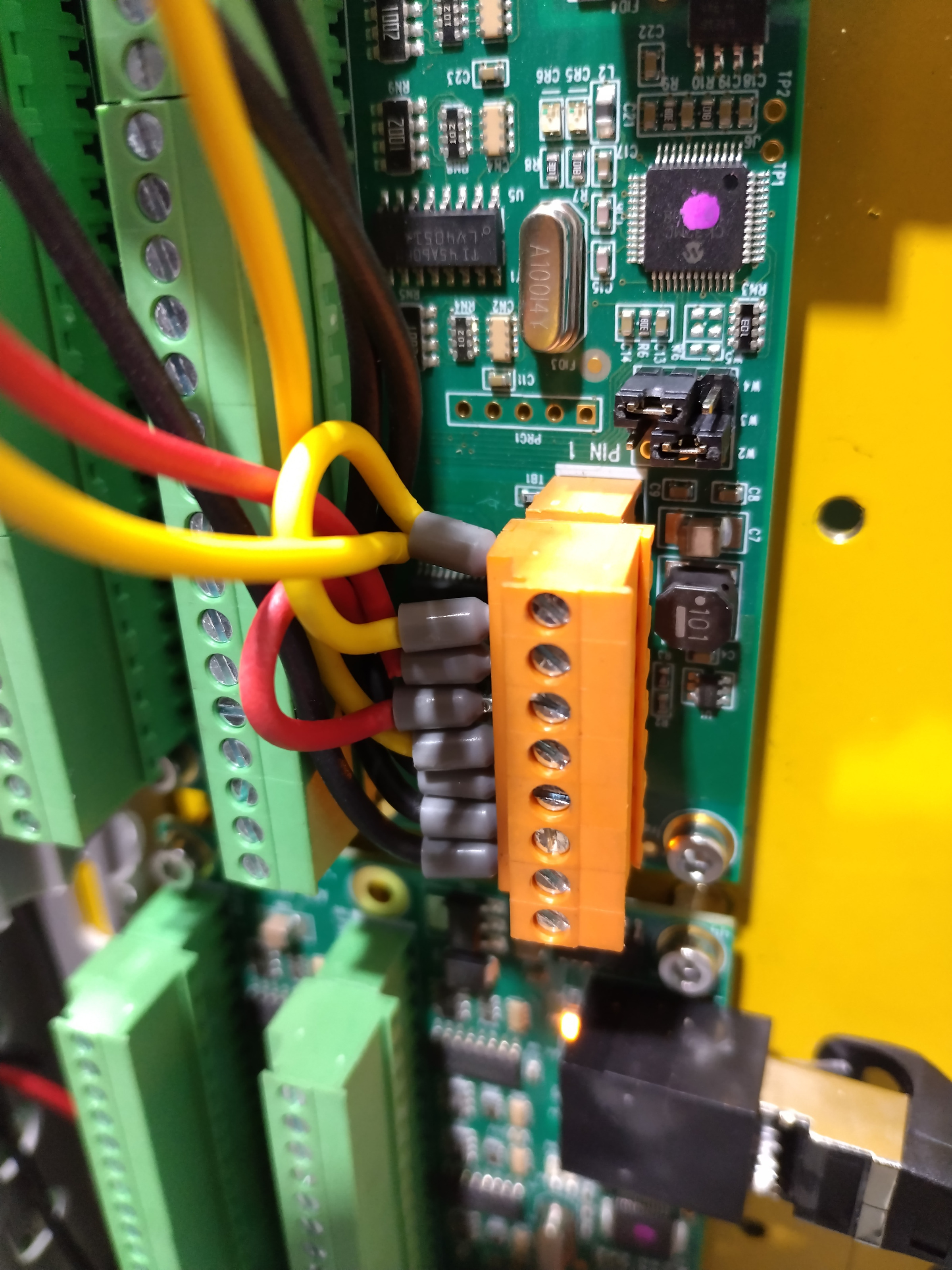

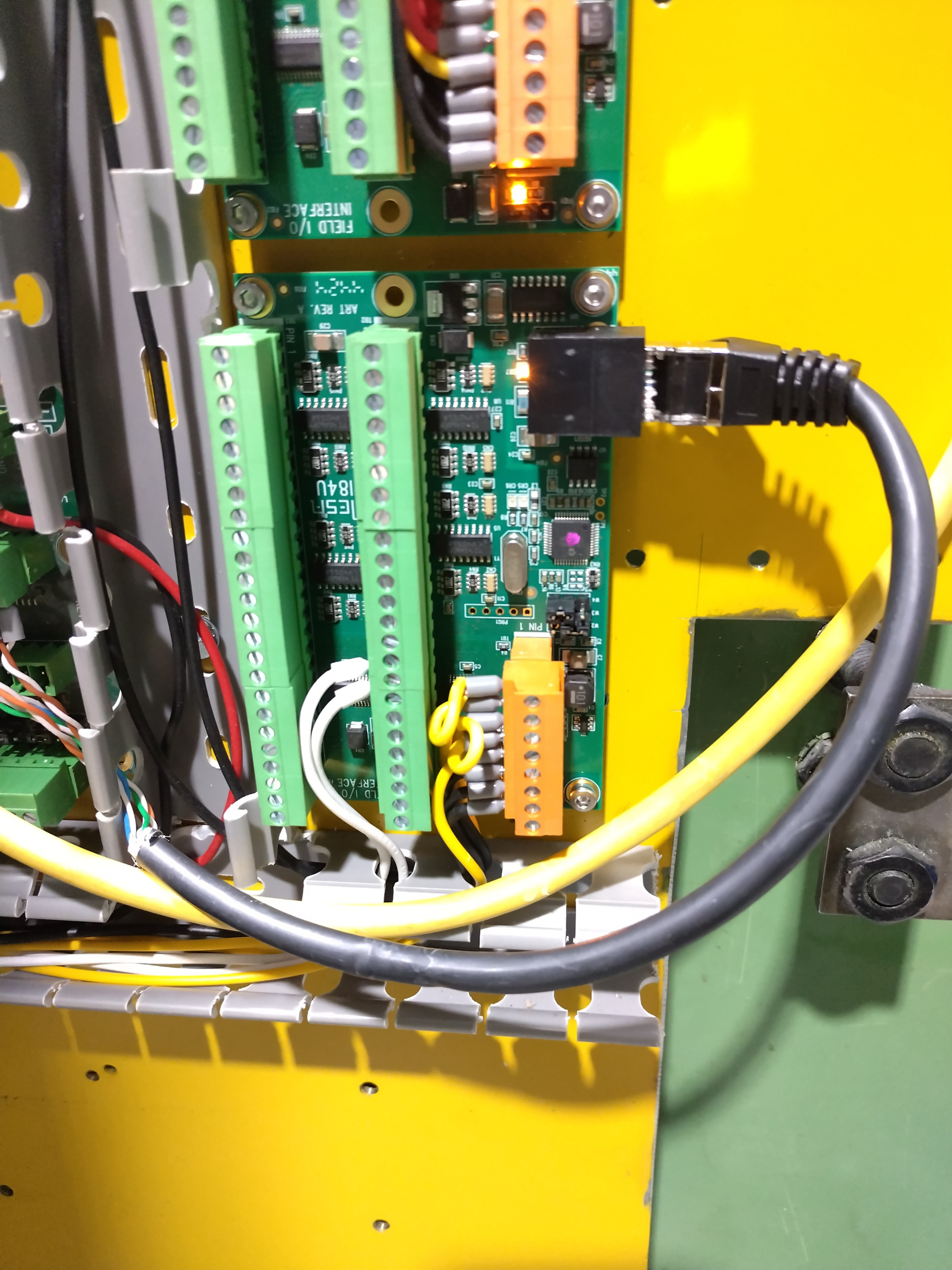

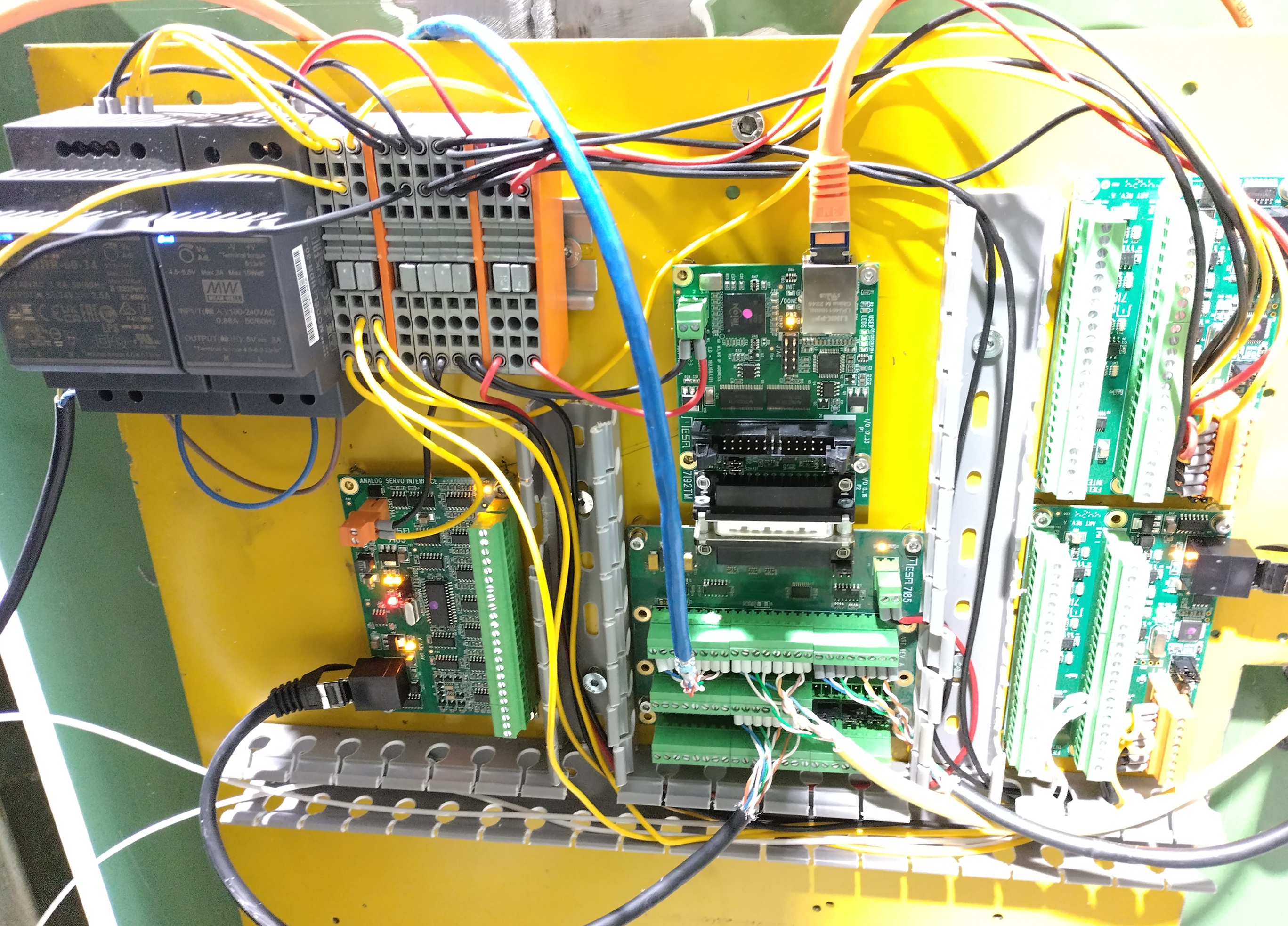

26 Feb 2026 16:31 #343544
by Dudelbert
Replied by Dudelbert on topic Considering a Full Rewire on a Working Schaublin 125 CNC
@Rotary: I tried the minimal HAL you provided. I had to change the number of encoders from 5 to 4, but then it starts up fine as well. However, it does not change the Smart Serial problem—only channel 4 detects any cards.
The one 7i84 that was detected but gave undervoltage errors now works flawlessly. I did not change anything, so I am not sure why it did not work two days ago, but I will take the small win.
I also made some images of the wiring. I am not sure how clear they are. All the yellow cables are 24V, the red ones are 5V, and the black ones are GND.
