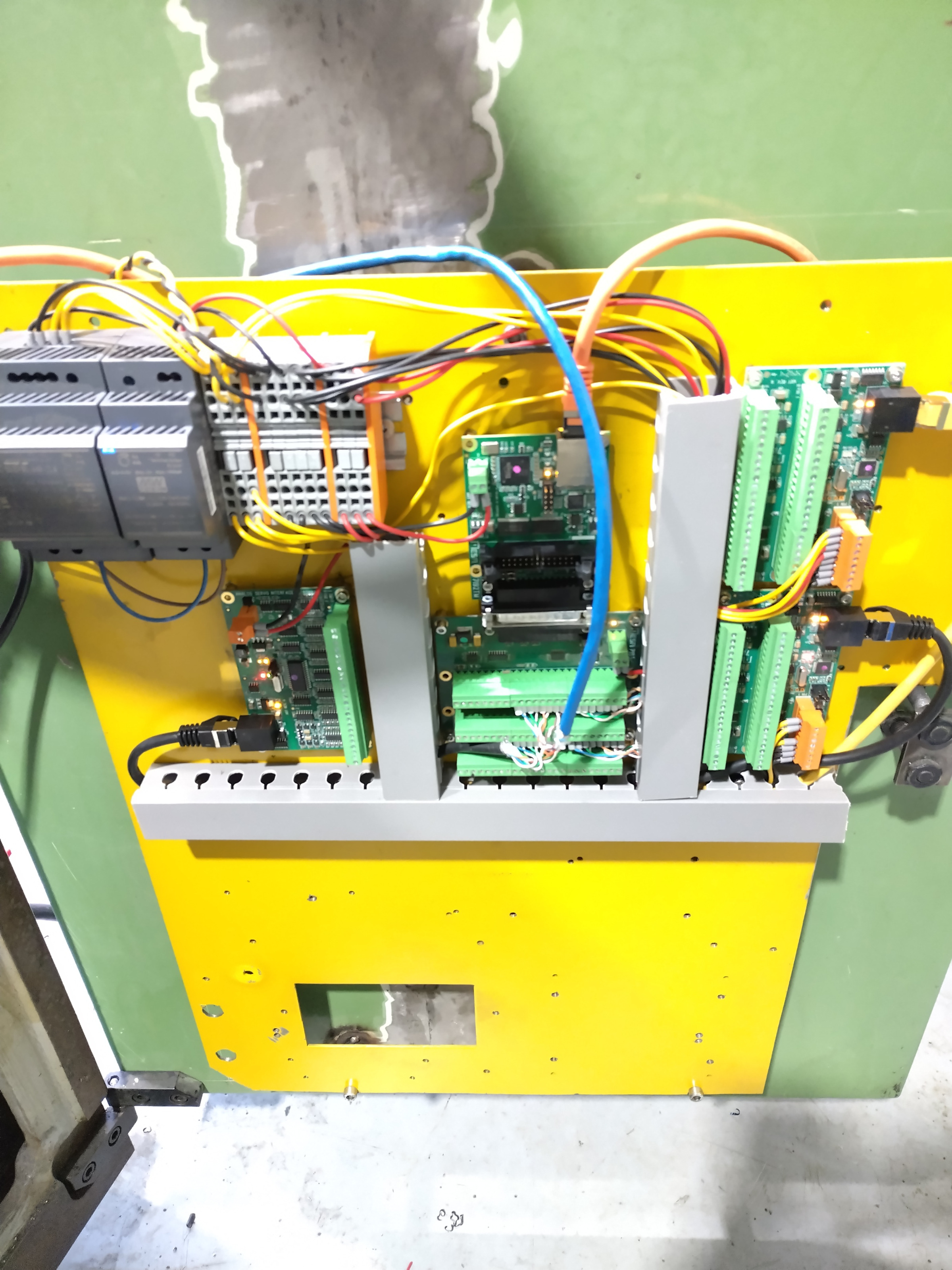

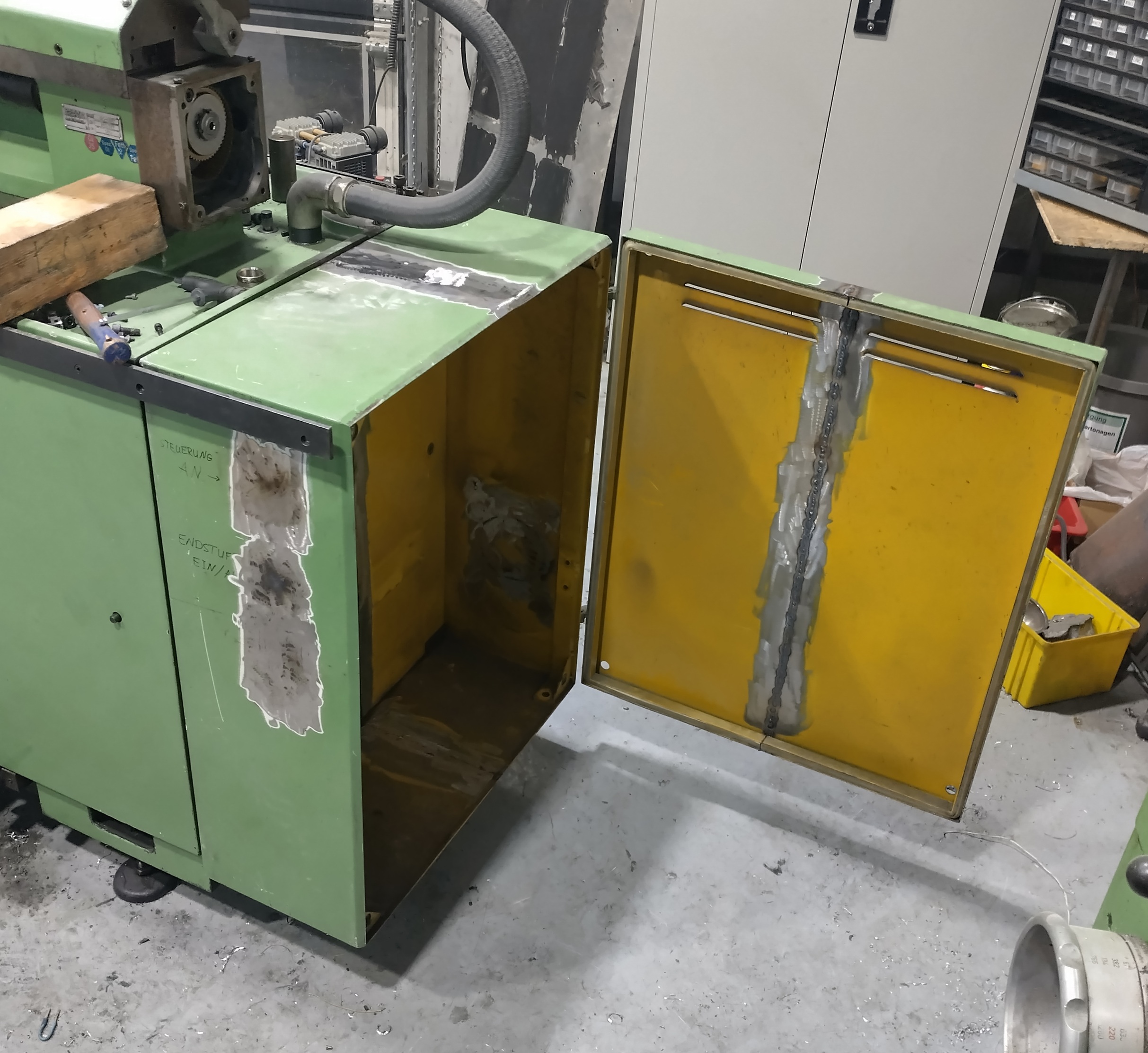

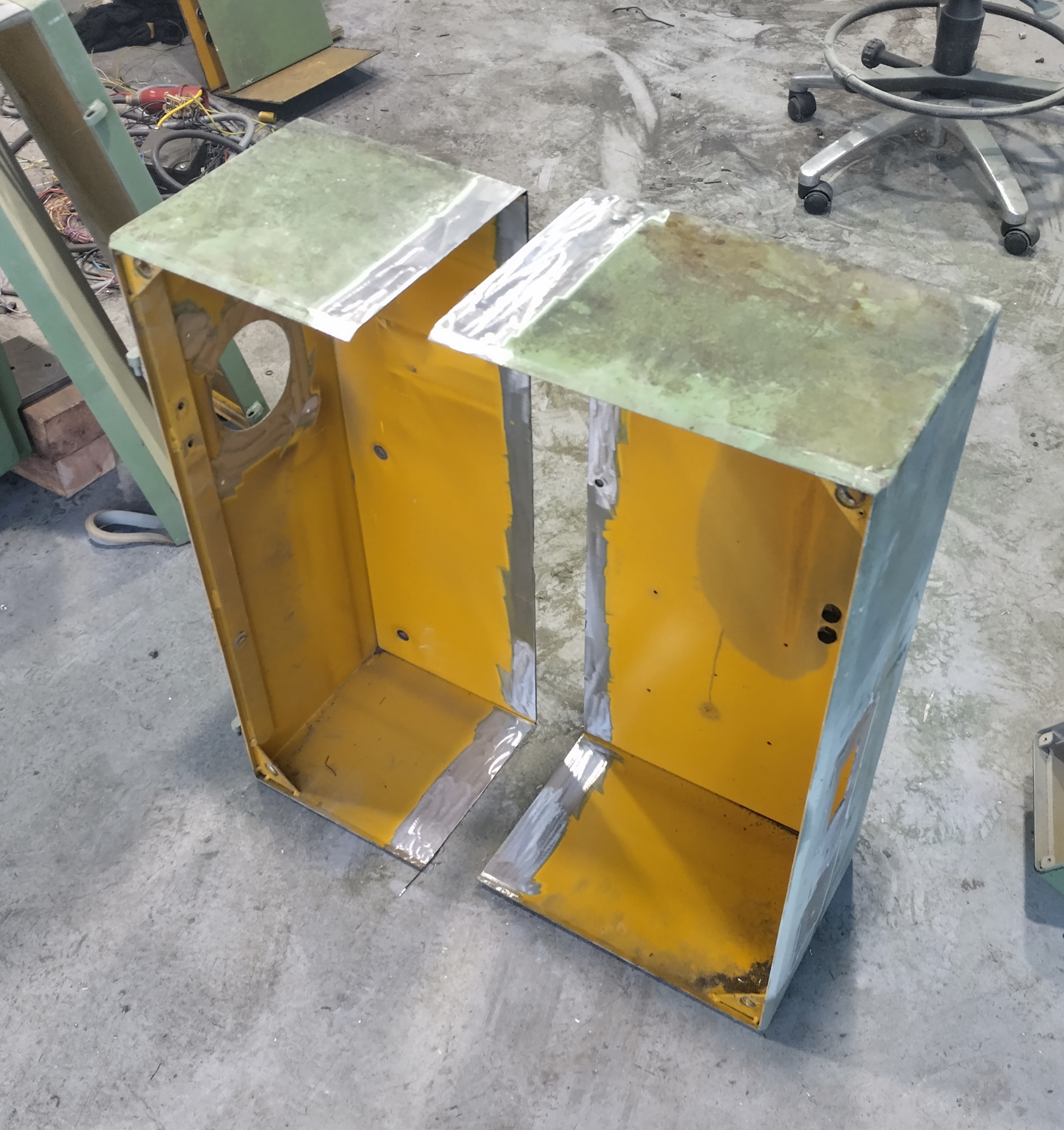

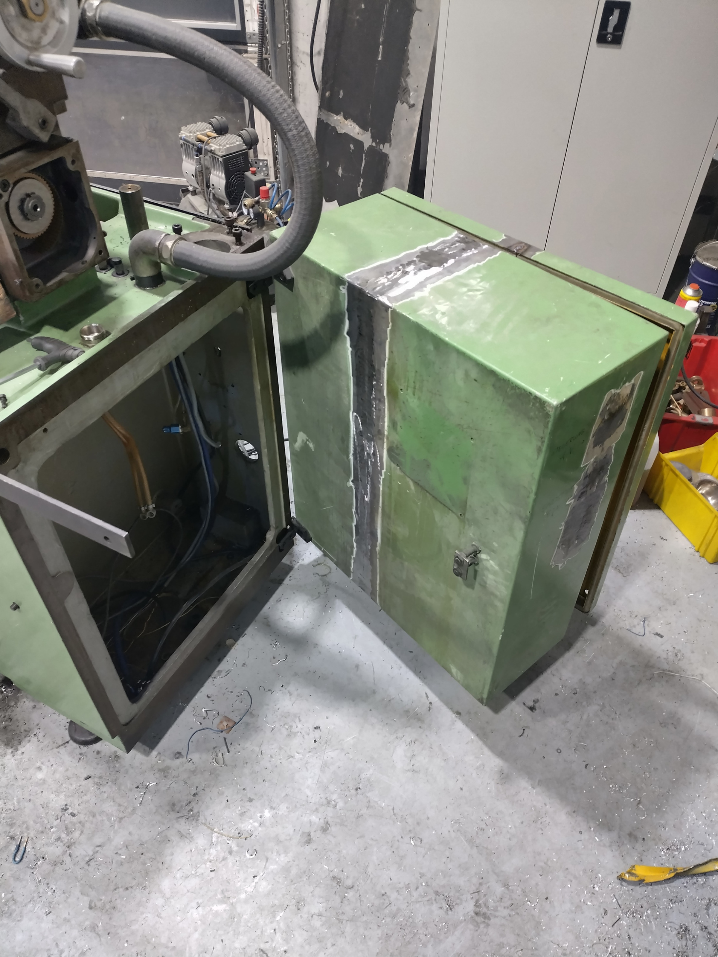

I want to give a quick update on my work, the belt for the Spindle encoder has been replaced.
Two belts have been installed same as RotrySMP has done. But I thought about this and think it is les helpful as I originally thought.
As this belt will likely “Dye” of old age, in that case the other one will also be brittle due to age already, but now it is in there and it does not hurt anything.
With the Spindle in good shape now I could test the full machine. Everything worked fine. Interestingly most of the “extended” machine was not even conked to the controller but controlled by directly wired relays, even with a notable amount of safety by locking functions out.
This includes the full tool changer, variator and back gear.
At this point I noted down some of it and started tearing the electronics and pneumatic bay down.
I also dismounted and shortened the electronics box.Their seems to be space for everything in the former pneumatics bay. If that is the case I will use the electronics box for tool holders, chucks and that stuff, if I need more space I will use that space as needed.

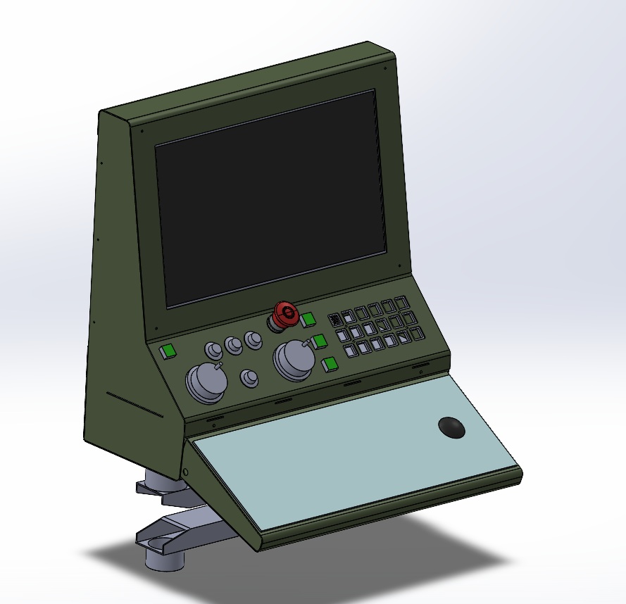

Also I did make up a bit of a control panel in CAD and made a cardboard variant.
I think that is it so far.
Martin

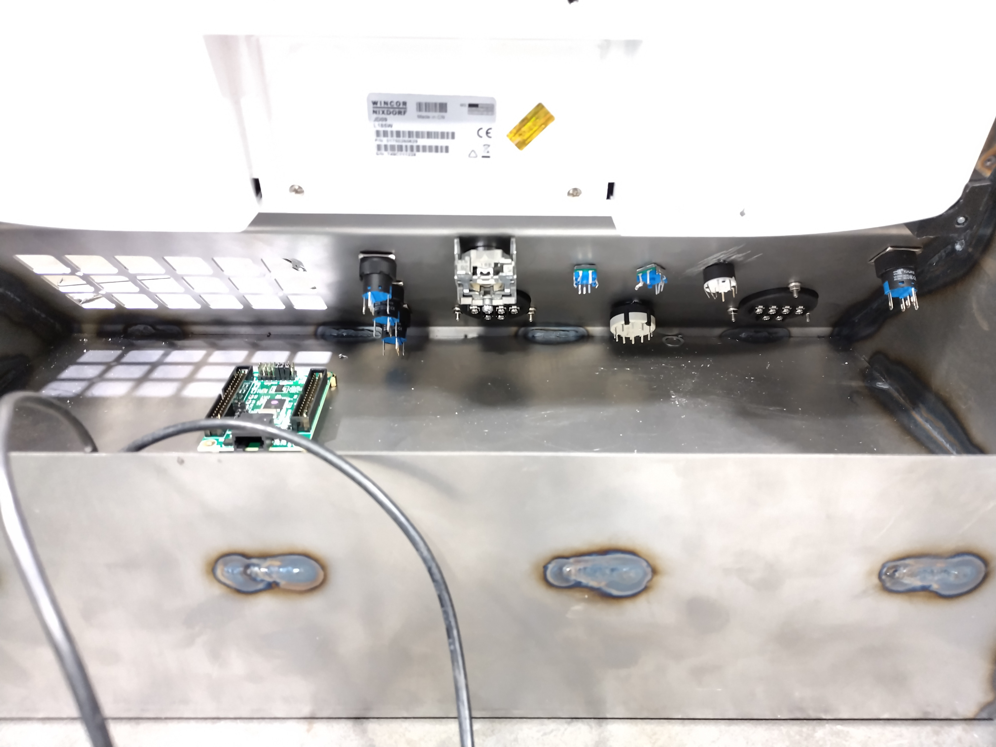

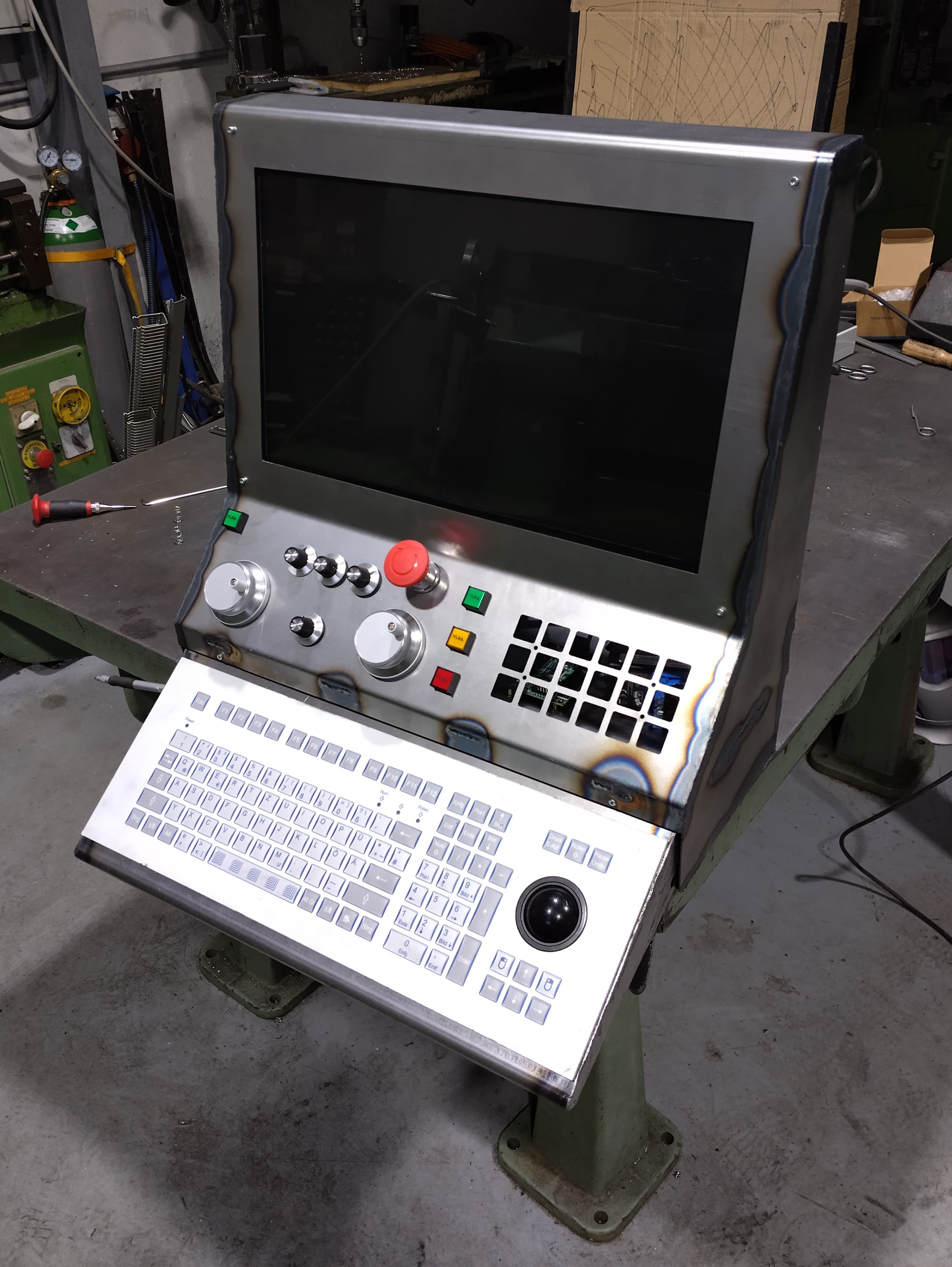

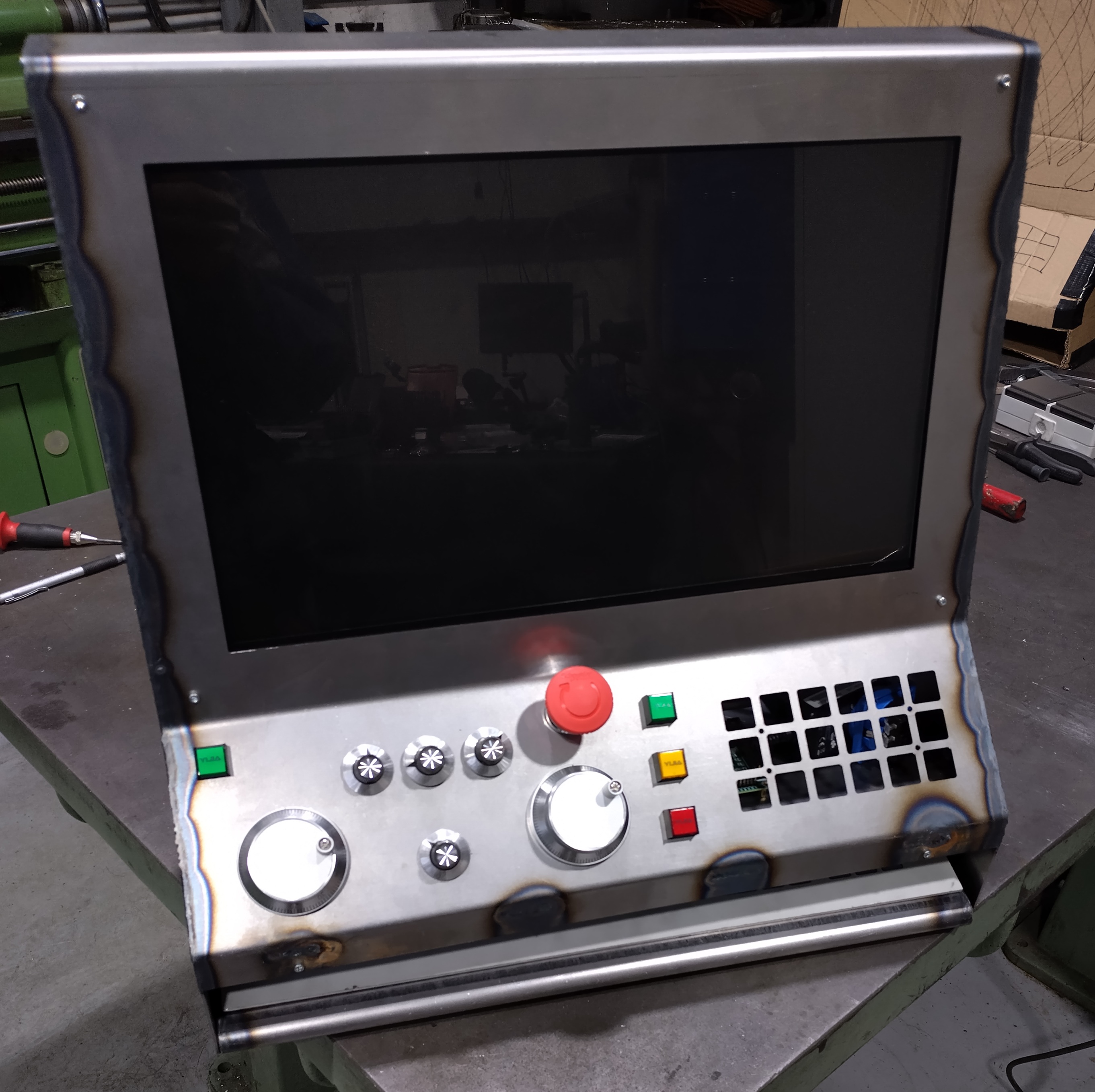

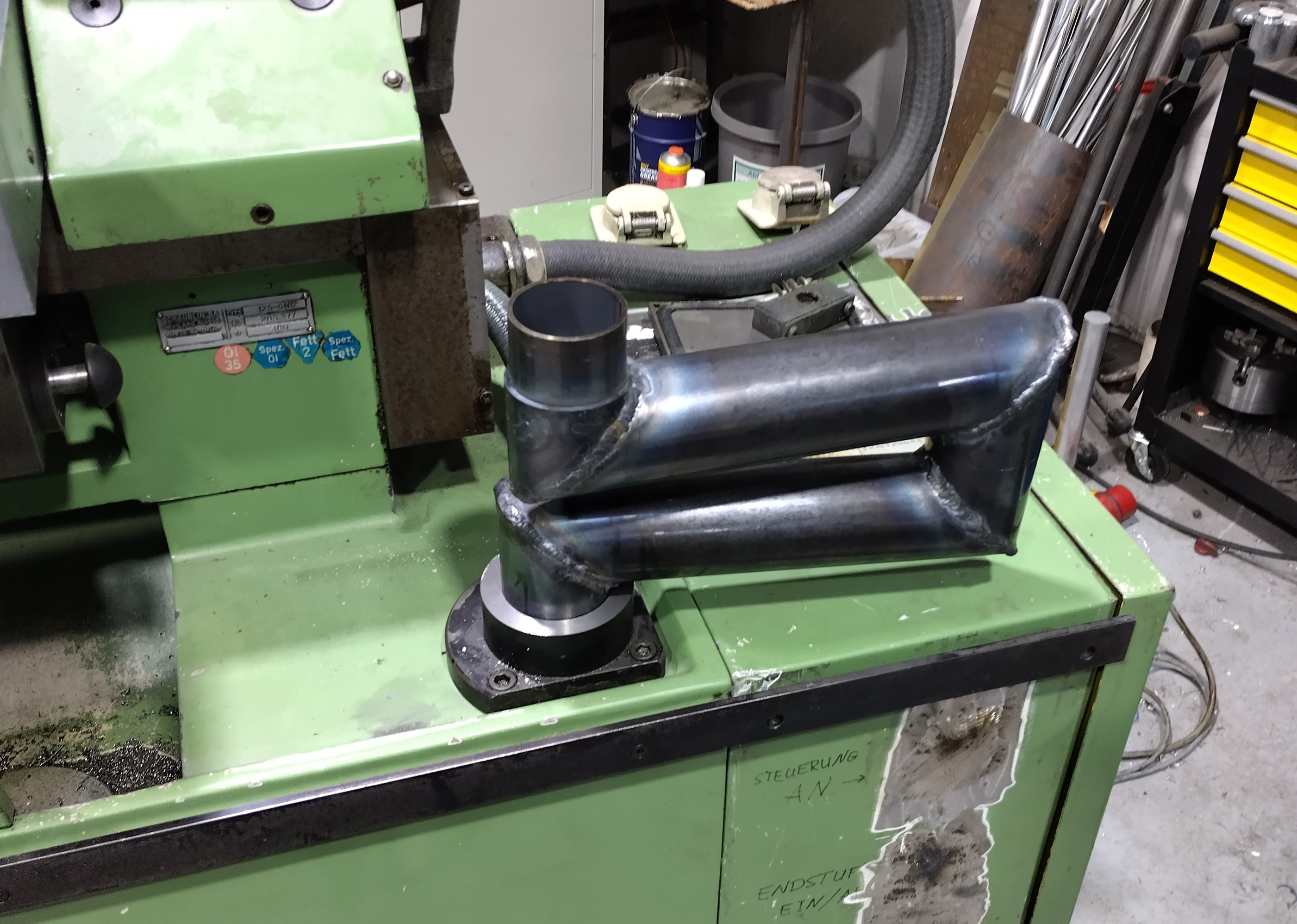

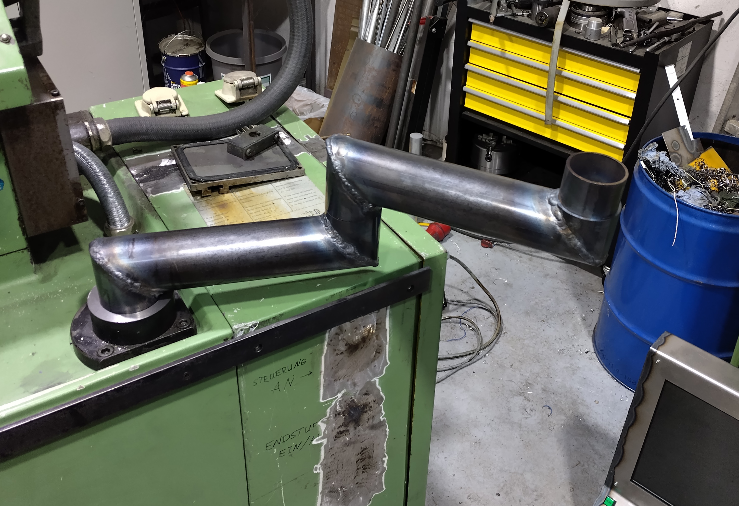

so in the last weeks it is really hard to convince myself to even go to the shop — “badly isolated to small of a heater,” you know how it is. Anyway, I still have a bit of an update.
I worked mainly on the control cabinet and its mounting. In the attachments you can see the box made from laser-cut and pre-bent steel plate, and the arm to mount the cabinet.
I decided to take it in the front of the machine. I reused the foot of the holder that mounted the original one in the back. Because the cabinet now is in the way of the tailstock, it had to be articulated twice. Simple rotation would not have worked.
It’s not quite together yet, but you may still see how it is supposed to go together.
It will be some weeks until I will be able to paint it (again, it is too cold).
I think that’s it for now.

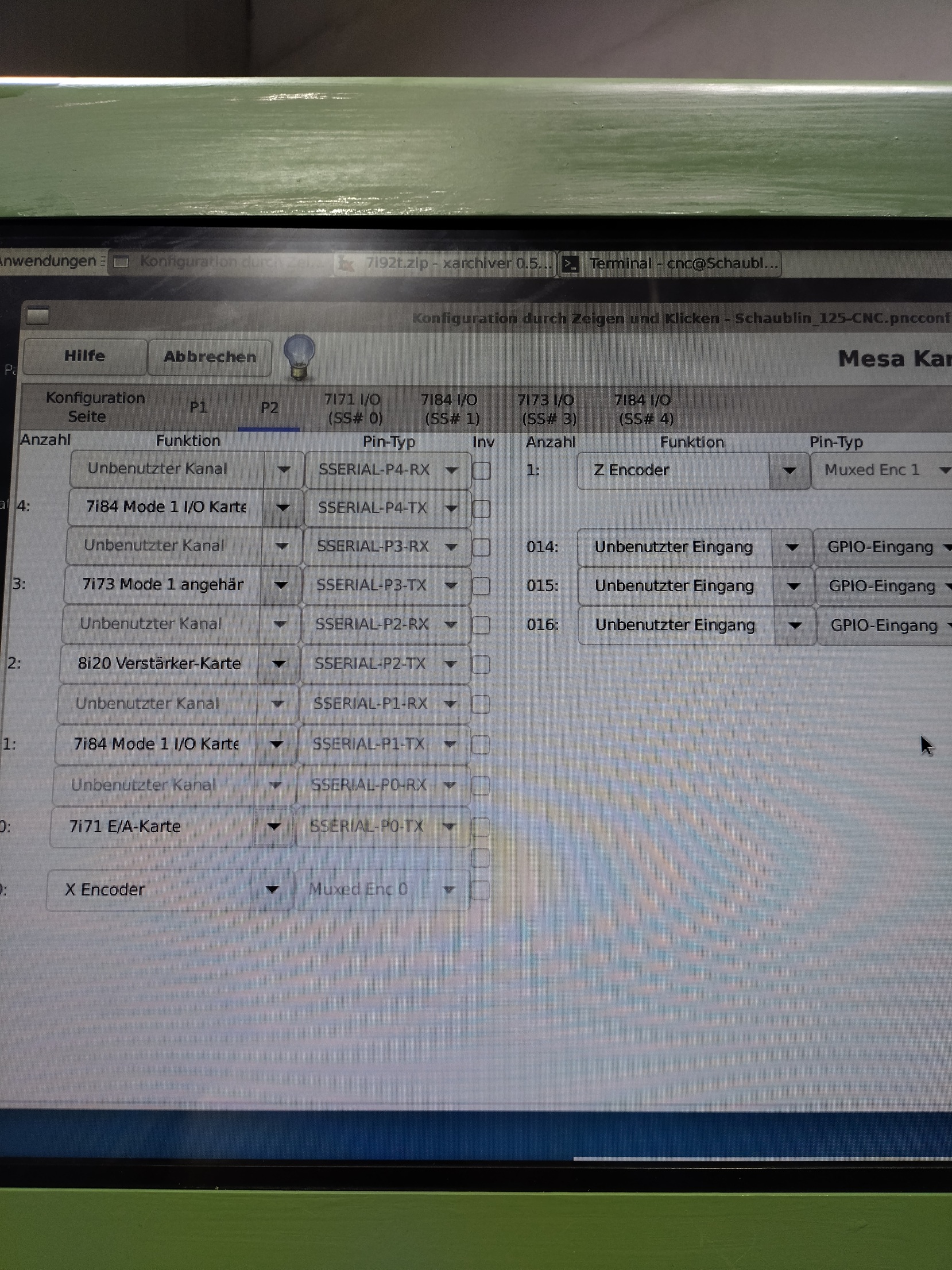

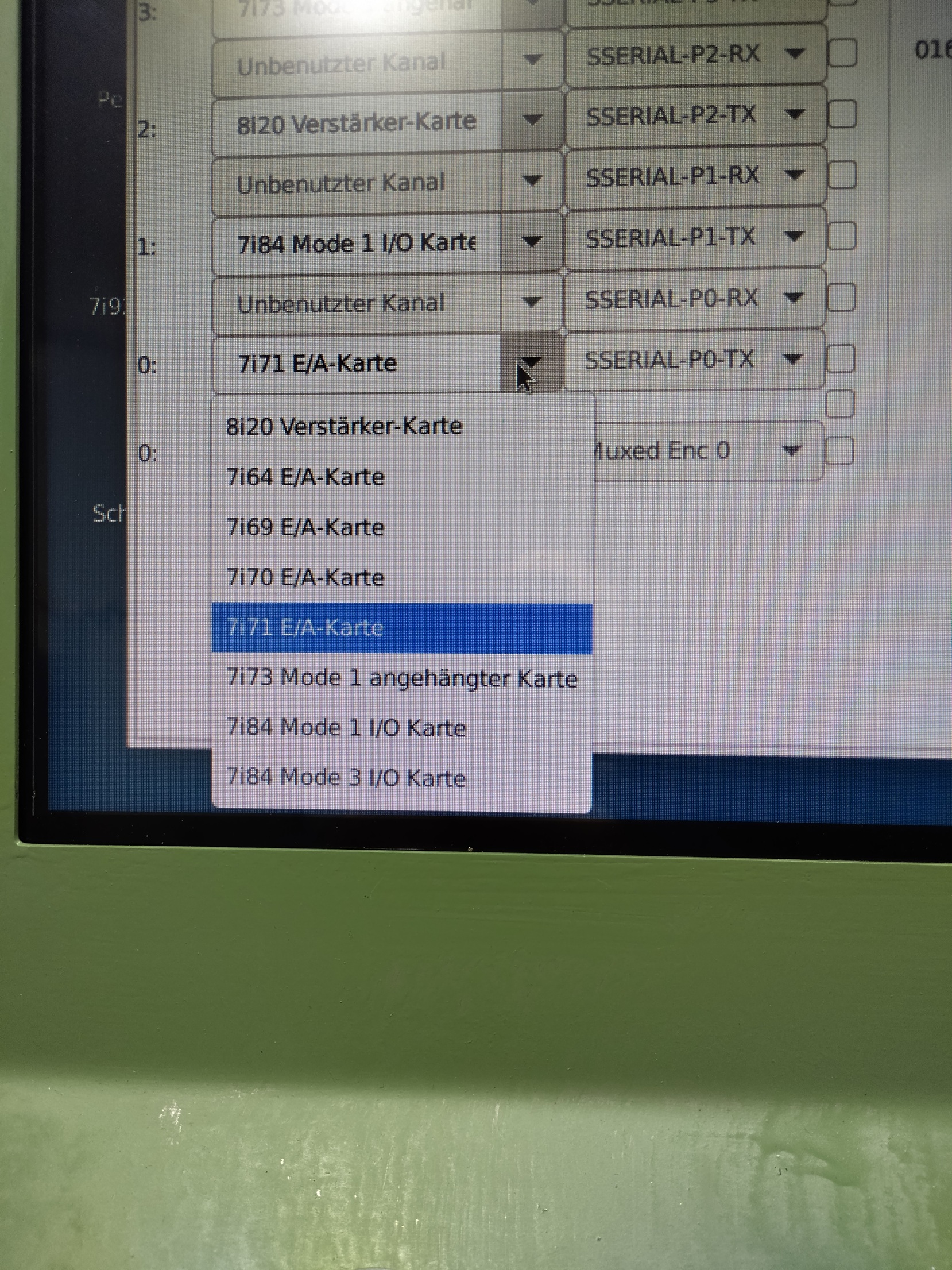

Hi, I have a bit of a problem getting my initial LinuxCNC config up and running. I’m using a 7i92T (flashed with 7i92t_7i85x2d.bin) connected to a 7i85 and multiple Smart Serial cards (one 7i83, two 7i84, and one 7i73).
I tried getting it configured with PnCconf, aided by this post concerning unlisted Mesa boards:
forum.linuxcnc.org/39-pncconf/52554-disc...ted-mesa-fpga#299687
This mostly worked as expected, but I have two problems. One is that only two of the four encoder interfaces of the 7i85 are shown (this would be okay for now), and I cannot choose the 7i83, which means I am unable to have any PWM channels.
This means I cannot configure the X and Z axes, and because of that I cannot finish the configuration.
I am definitely doing something wrong. If anyone knows what that is, I would be extremely happy if someone could tell me where I am going wrong.
I also attached some pictures of what I am seeing right now.
