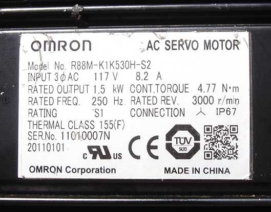

What kind of spindle motor do you have? the 8I20 is designed fro running
BLDC or PMSM servo motors, not induction motors
- KT315A
- Posts: 19
01 Aug 2013 08:12 #37316
by KT315A
It is OMRON servo motor with permanent magnets: R88M-K1K530H-S2
Replied by KT315A on topic Cannot get working 5i25 + 7i76 + 8i20
