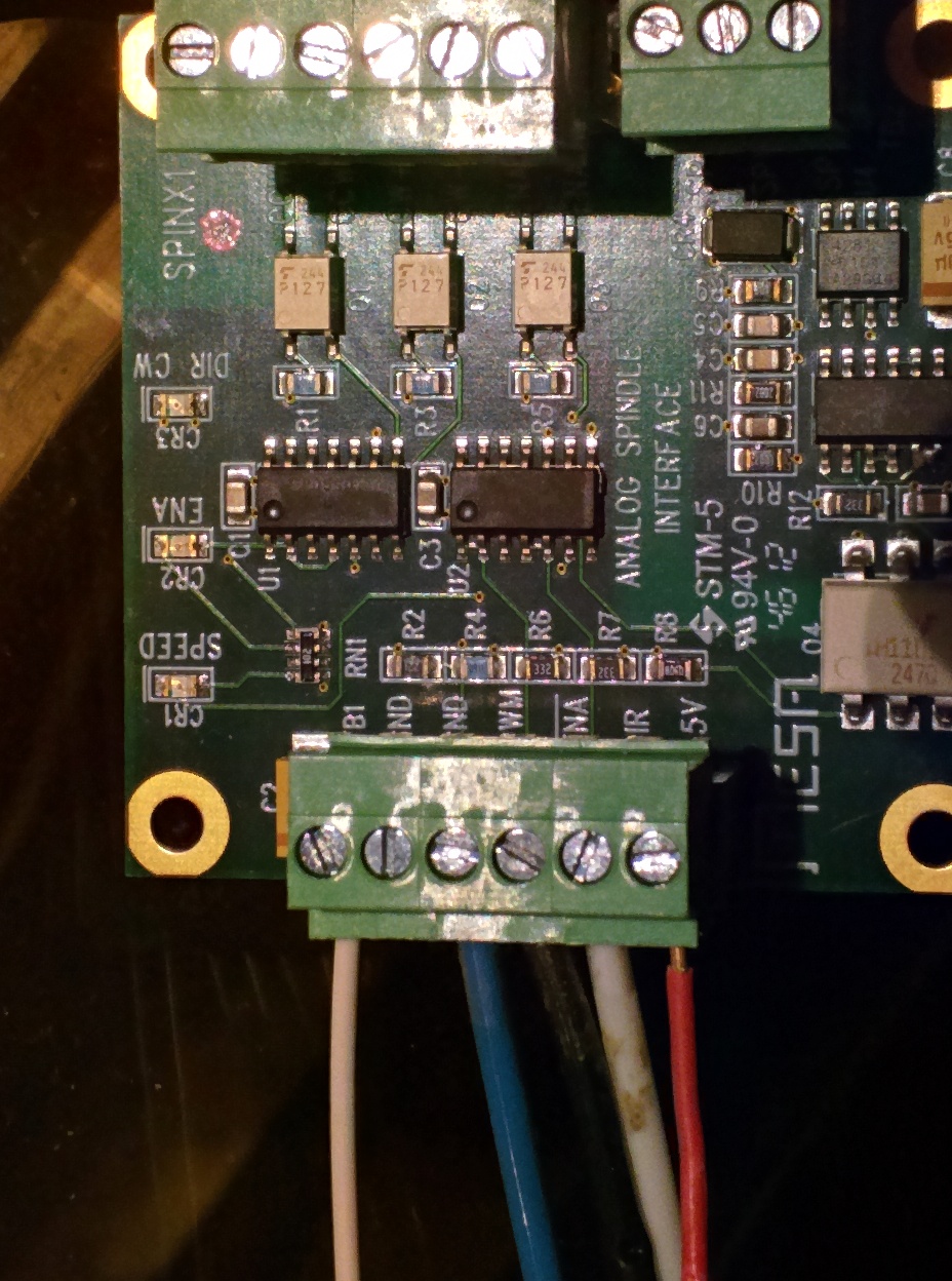

I am providing photos of my 2nd parport and Spinx1. An initial goal, if you agree, should be to get the ENABLE led to light, which as of now is not lighting. My external power to the board is 5vdc, positive wired to the Spinx1 5v terminal per the Spinx1 manual, and negative to the GND terminal. My Hal file has not been changed since my prior post.

I think you are wrong at the parport end. The "short" side of the D has the GND pins.

Andypugh your description makes sense. My wires are in the "top" part of the 'D' curve, pins 14,16, and 17. What I can not determine from the illustration you sent is whether it is for a db25 connector with visible pins or a typical parport with 25 'holes'. I think the illustration you sent is for the 25 'hole' parport.

You need to wire the gnd then. Current needs to flow from the port pin, through the spinx and back to parport gnd.
If you look carefully at the connector the numbers will be cast in the plastic.

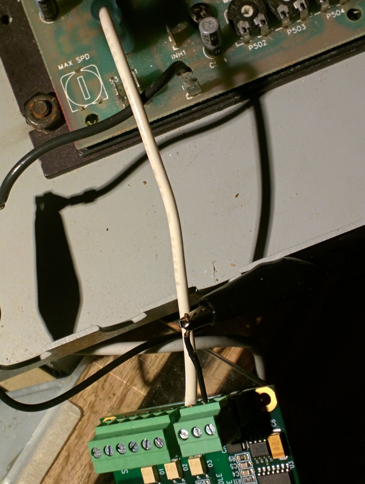

It took several different hal files to confirm, but I was able to verify all 3 LEDs light on CW, ENA, and SPEED.
Spindle not yet turning, attaching picture of current wiring. Minarik manual says S2 and INH2 required for the potentiometer, S1 and S3 not. Seems odd to only have two wires but I guess the pot should work more as a rheostat, maybe?
You can see only two pptentiometer wires are connected and the two unused side by side term posts on the left side of the Minarik board.

It helps to think about machine wiring in terms of current flows, especially as many signals will be transmitted by optocouplers which means that you actually do need a current flow (of a couple of mA) through the input LED of the optocoupler. So, current can't flow through the SPINX1 inputs unless it has a path back out through the GND terminal back to the wall-wart.
Rather than use a 5V wall-wart, consider stealing power from a USB socket on the PC. That way you are using the "same" 5V as the parallel port.
If you are using a wall-wart then you absolutely need to connect the wall-wart 0V / Gnd / negative / common / call it what you will. to at least one of the GND pins of the parallel port.
