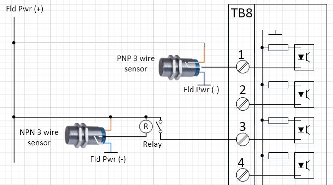

As I see here very often questions to connections of the 7i76 or 7i76e, I offer my connection sheet as supporting document.
It may be of help to others.
@PCW: could you please double check my infos and it might be good to make this sticky.

Thank you for spending the time to do this, It looks great!
I have only 2 minor niggles
1. On the VFD interface, you would not normally use the analog 10V to power the digital (enable and direction)
control inputs (there is often a 12 or 24V supply in the VFD for this)
2. Its suggested to use the 10.10.10.10 IP address for LinuxCNC so you don't end up with the
real time Ethernet IP address range overlapping a DHCP pool of local network addresses
(set W3 up instead of down to use 10.10.10.10)

- Page for jumper settings and basic information has been splited in two pages
- Added a note to change Jumper W3 to use the 10.10.10.10 IP address, the hal line is unchanged, as this way all jumpers may stay in it's default positions.
- Added a page to show how to connect inductive proximity switches NPN (with pull up resistor) and PNP without.
- Changed the VFD connections according to PCW's comments
Norbert

Norbert you have done a great job. I have attached a diagram showing PNP and NPN three wire sensors hookup to a mesa 7I77 card, I think it would be great to add someting similar to your document to help others.

Hallo Benb,
thanks for sharing that information, IMHO it is allready included in the latest version of the document.
Just as 4 wire version with one wire unconnected.
Norbert
