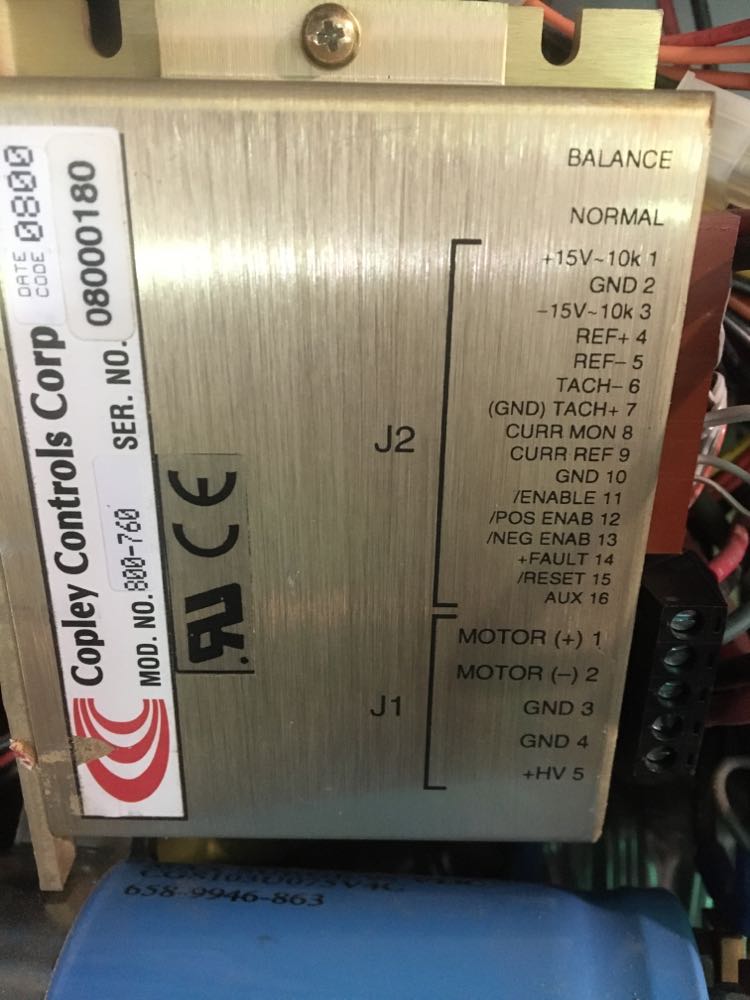

29 Apr 2021 21:23 #207409 by bevins
Replied by bevins on topic Retrofit of Precix 5x10 CNC
Hi Randy,
Look what I have, rather my customer.
Wanted to know if the encoder connections are correct in the thread.

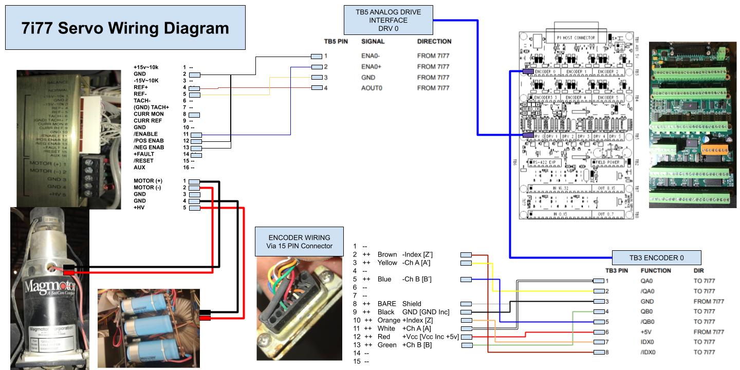

29 Apr 2021 21:25 #207410 by bevins
Does the enable woirkj the way you have it on the drawing? IT seems weird to me, nbut if you have it working like that I'll surely connect it that way.
BTW, what was the DC voltage your using for the drives/motors?

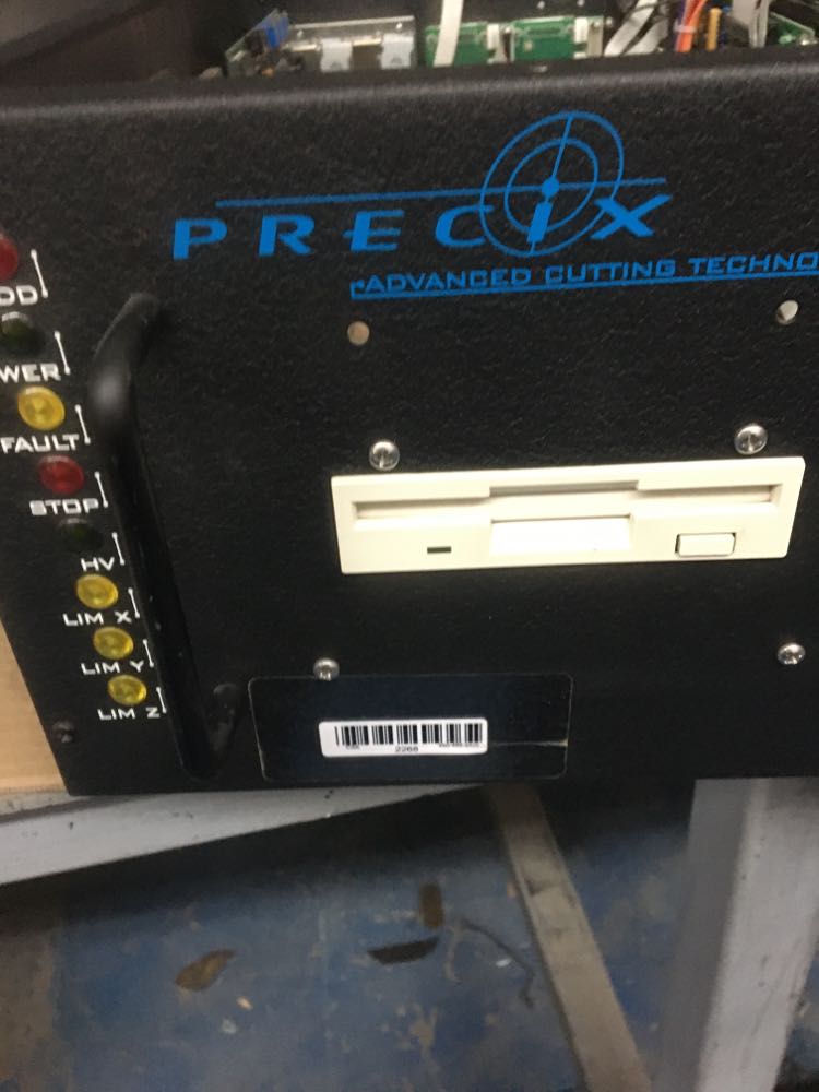

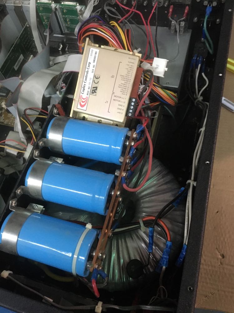

Sorry for all the questions, I have to quote this retrofit.
Did you use the csame cabinet for the computer power supply and mesa boards?

29 Apr 2021 22:05 #207416 by randypetersen
Replied by randypetersen on topic Retrofit of Precix 5x10 CNC
Yes, that looks just like what I got.
I am still using those amplifiers, I asked COPLEY about a replacement and they said:
The base model 4122CE is obsolete and there is no pin for pin replacement. I do not know who owns Precix Advanced cutting but they stopped buying Copley 10 years ago.
800-760
Any, was Precix Advanced Cutting Technology
4122CE
For Astromec T31-9, Torque Mode, L 4, R 0.7, Ic 8.7
www.copleycontrols.com/wp-content/upload...asheet-Datasheet.pdf
That is how I connected my setup... right or wrong, but it's working. I bought a new MAGMOTOR that I am going to install soon.
My power supply going to the amplifiers is about 50 or 51volts, I am guessing it's a 48 volt power supply.
I got my MESA boards in the same box as the power supply. So I took out the other motherboard/boards from the old setup. Took out the floppy drive. Stripped it to just the power supply and the connections to the sensors/motors. Then wired in the mesa boards there.
Just got a nothing special old PC powering LinuxCNC with 2 network boards - 1 going to MESA and 1 going to NETWORK.
Glad to help however I can, forum folks have helped me so much :)
