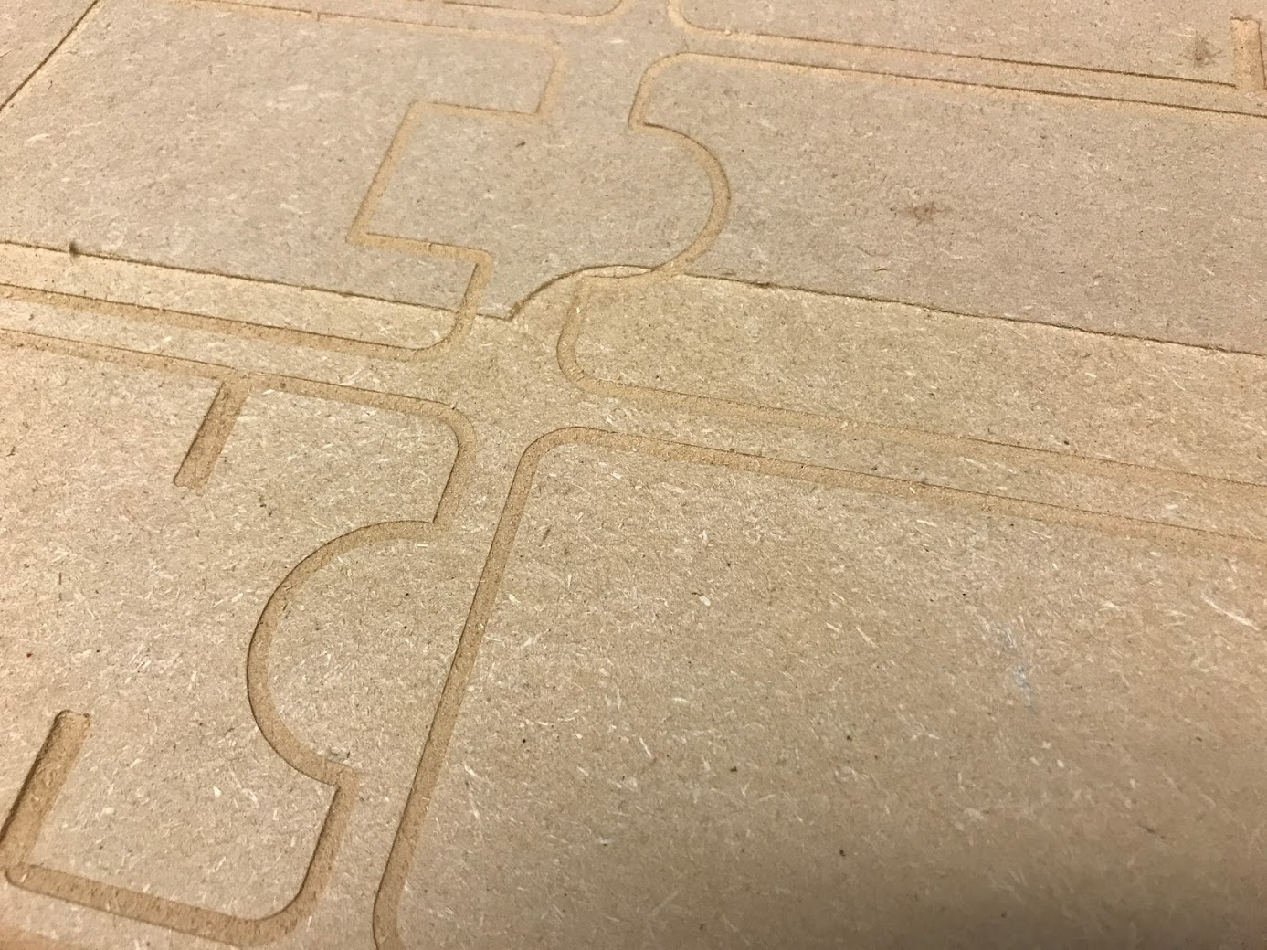

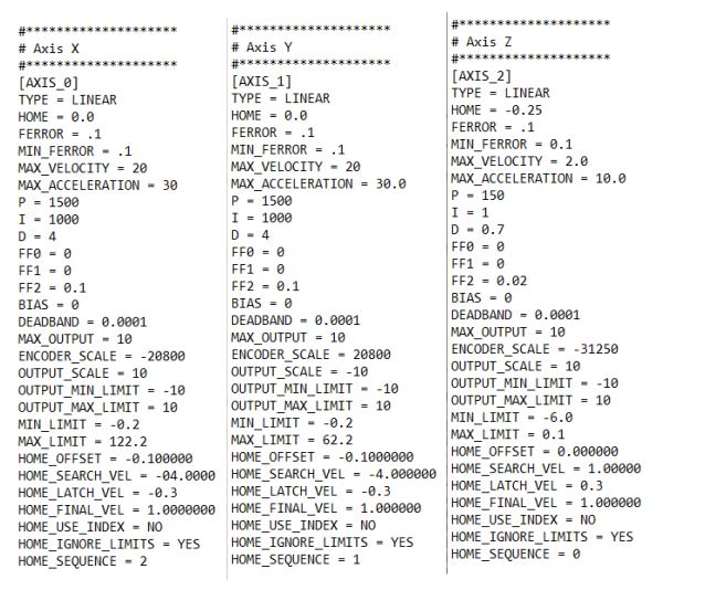

Since I have brand new encoder cables I am thinking it's the motor or tuning. Odd since this machine was behaving up until today. This motor is pretty ancient. It could be the power supply failing I suppose.

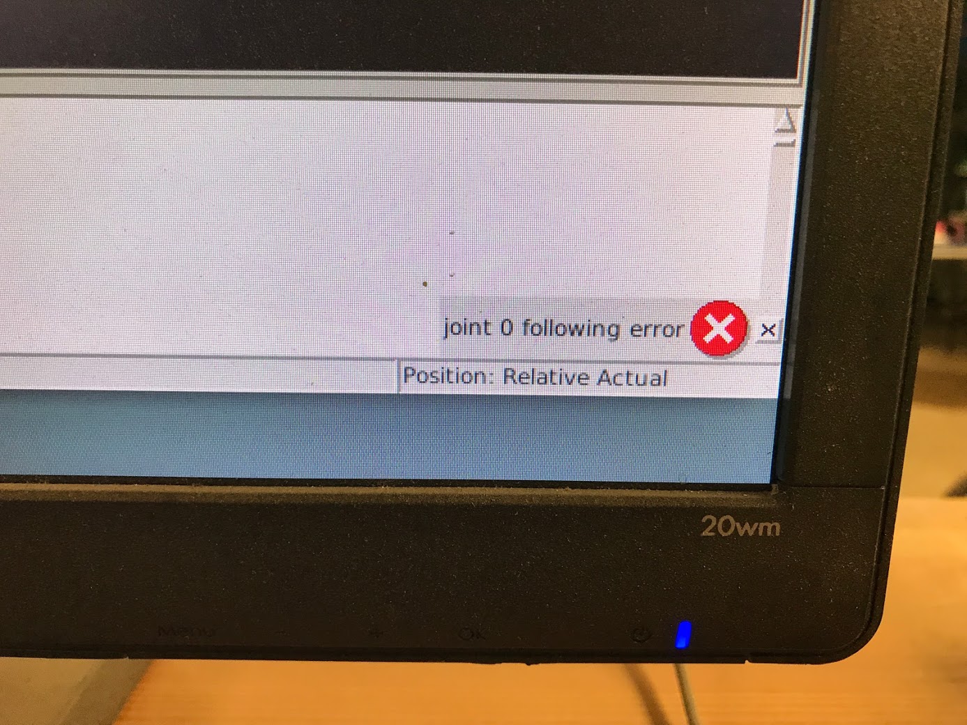

Anyone have any input on why I'd be getting joint 0 following errors all of a sudden?
Debating on getting 3 new NEMA 34 servos/driver/power supplies, one for each axis. Looks like you can get a set for around $800. Wefixprecix had motor/encoder assembly for $550.00 a year ago, not sure if he still has any available.
I notice my PID numbers look way off compared to most posts where I read about PID tuning for SERVO motors.
Think I need to start from scratch. Odd I haven't touched my setting in months. Although the last thing I did to was lower the ferror, I was told it was too high.
error, which I am sure everyone has seen
where it stopped the 1st time, 2nd time didn't get even that far..

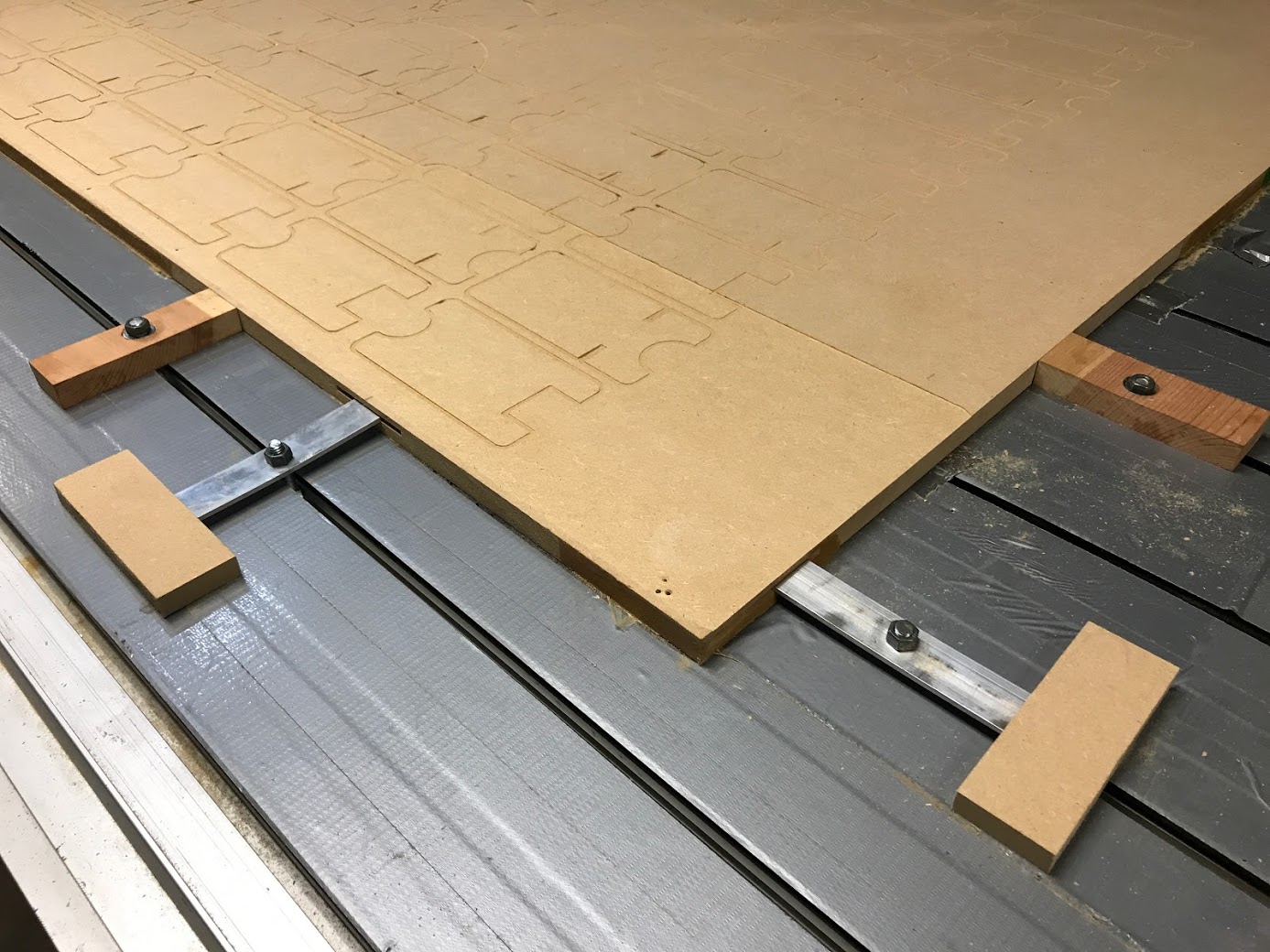

my crappy way of holding down my spoilboard - biscuit slots & aluminum flat stock holding it down to table/t-track
Thanks for any input!

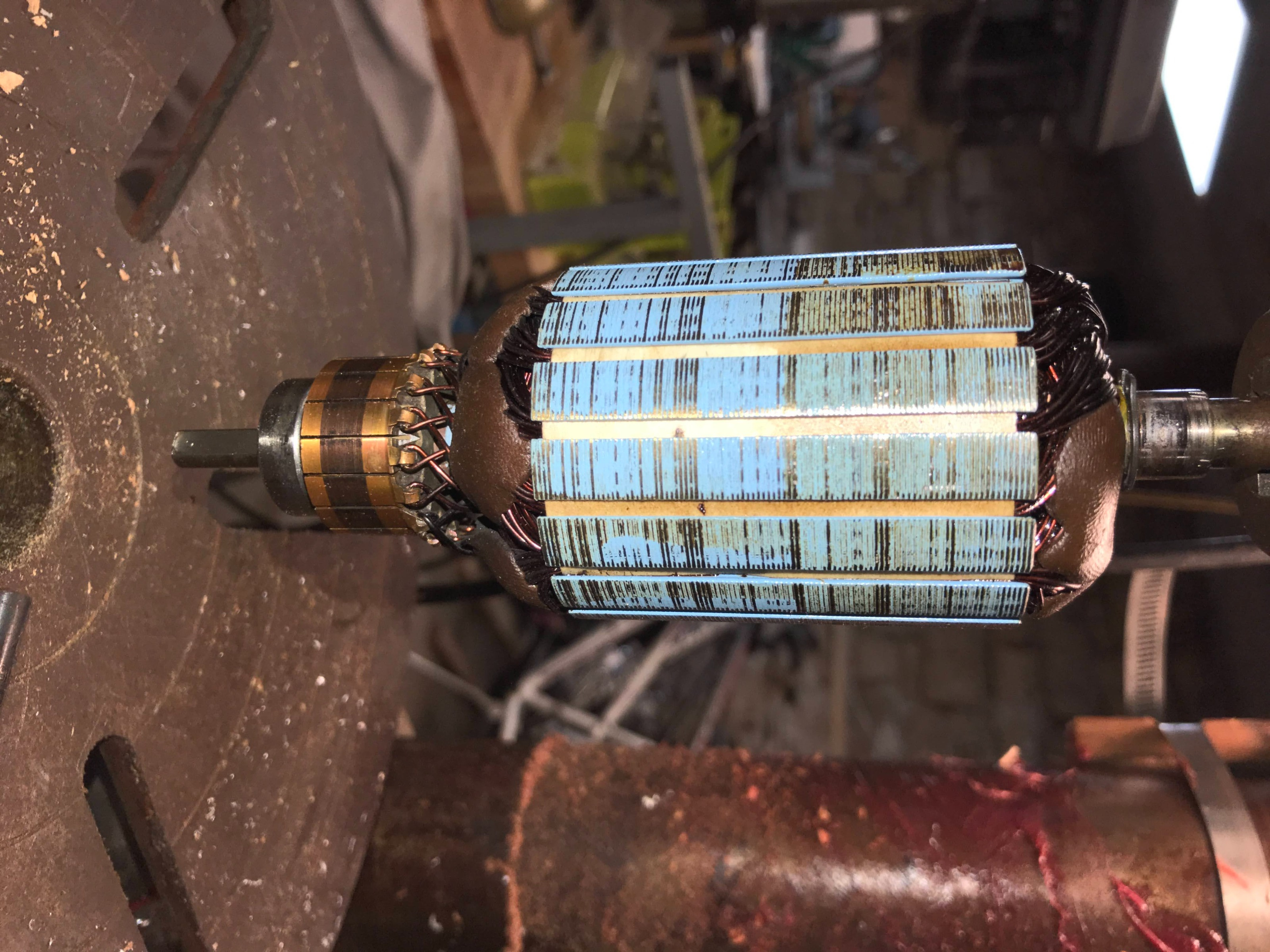

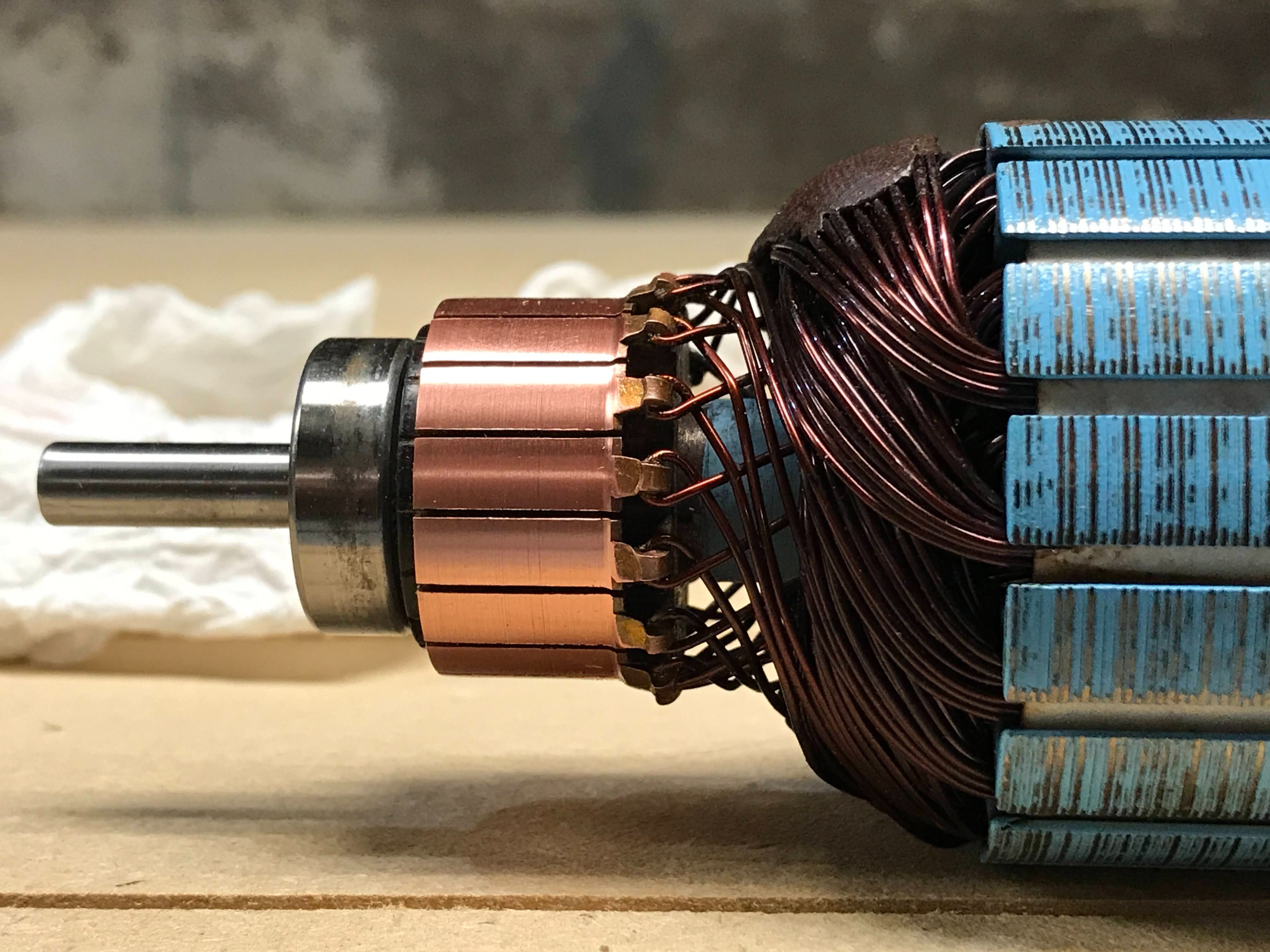

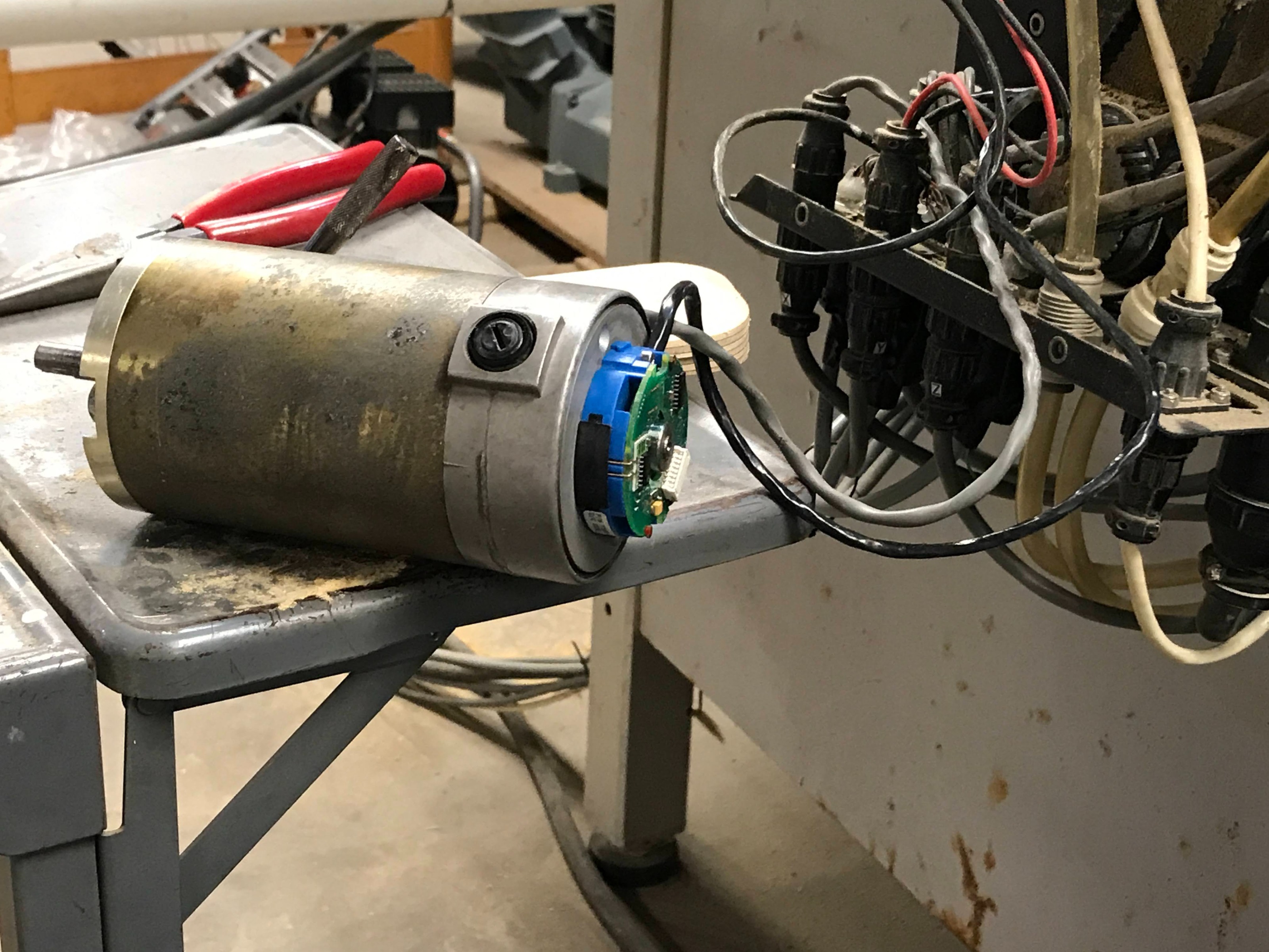

Are these settings AFTER you reduced the error limits? Are you running with inch units or mm? If inches, then 0.1 is allowing an errot tolerance of 1/10 of an inch, which is a lot. On X and Y, that is 2080 encoder counts. You need to fire up Halscope and see what the actual error is, and what it looks like in the time domain. If your amps are running out of headroom, you will see a slowly accumulating error. If there is a bad connection (cables, worn brushes, etc.) then there will be a sudden increase in error.
I'd pull the brushes out of the suspect motor and inspect the commutator. Either brushes or commutator could have developed wear, or the commutator slots are filled with copper dust, shorting out the armature.
Jon

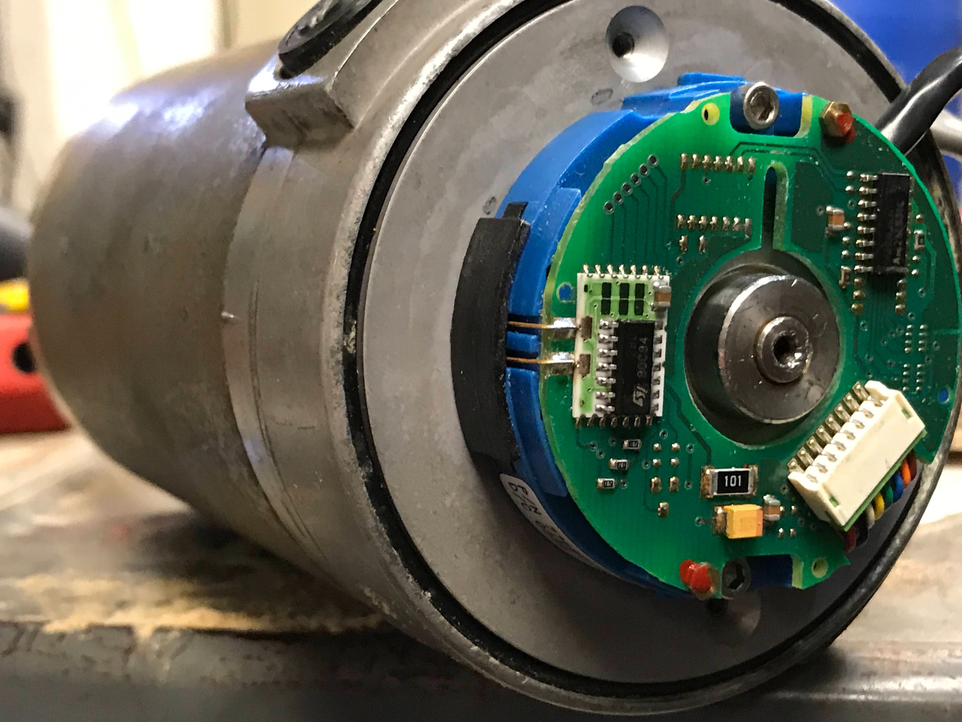

Replied by randypetersen on topic Retrofit of Precix 5x10 CNC
Thanks jmelson!
I took the servo motor apart.
Cleaned it up, but it didn't look terrible.
Putting it back together and the encoder was really hit and miss.
Then I moved the stop just a tiny amount and it was behaving much better. The encoder does seem somewhat sensitive.
I think this unit started off with some older motors, and the Y and Z axis were replaced with the magmotor units. I am thinking I could either replace the X with a magmotor or replace all the motors with some more modern units.
I have yet to connect the motor with the gears yet, hoping to test it a bit more.
Thanks again for the help!

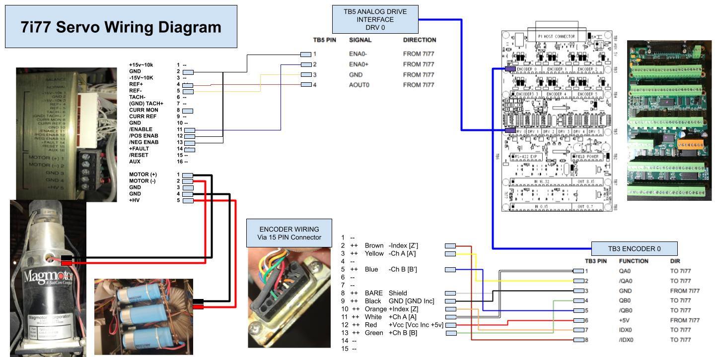

This is what I had for wiring my motors,
Which motor(s) are you using?
Magmotor was nice for sending me wiring info. I am thinking about buying a replacement MAGMOTOR for my X axis. They are $625 from them, but there was a pretty long wait, like 6-8weeks. wefixprecix has a direct replacement motor/encoder for $550 which is tested on a precix. Seems like you can get a servo nema34 motor and driver with slightly more torque for around $200 off amazon/ebay.
From my recent experience cleaning my servo motor, I found the encoder positioning on shaft is critical.

I had to rewire my encoder, how do you have things connected to a MESA product? These guys on this forum are really intelligent people, but if we don't do our part and layout exactly the problem then they can't do much to help. I have to run now, but I will re-read your post and it seems that the problem followed your cabling right? So it's not a motor problem? When you changed the motor, did you change your encoder as well?
