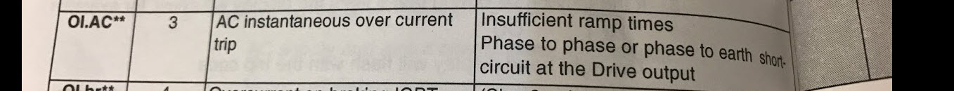

Long story short, found a spark on board of VFD, attempted solder repair, VFD turns on and was responding normally. Who knows for how long. So excited to see the spindle spin, was exhilarating...
Connected it to MESA 7i77 5th PWM connection per previous post.
Ran through PNCCONF just to see if would fire up, and enabled spindle and changed speed, it was spinning!!!
Upped speed, went fast, all good!
Upped speed again, got a trip error on VFD.
AC instantaneous over currnet trip - Insufficient ramp times / phase to phase or phase to earth short circuit at the drive output
I am hoping it's just because I was screwing with it and didn't have parameters correct on control side.
Going to look into setting up the spindle properly in INI/HAL now.
Just wanted to keep you posted, thanks for all the help!!!
Still planning on replacing VFD when I get some funds available.

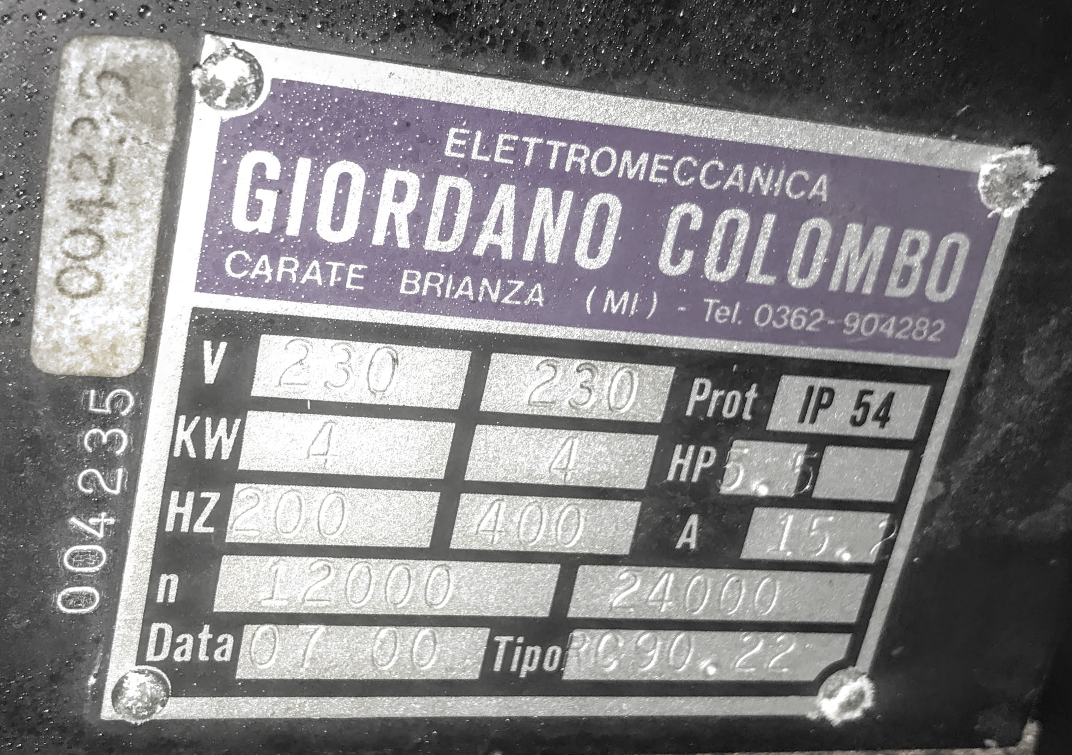

16 Aug 2019 20:11 #142336
by randypetersen
Replied by randypetersen on topic Retrofit of Precix 5x10 CNC
Thanks Todd/PCW,
As far as the VFD setting go, I didn't change anything. I did go through them to make sure they weren't defaults. Everything appears to be set for the spindle I have. The items I could see matched the nameplate on the spindle.
I didn't get any paperwork with the spindle, and having difficulty finding a manual.
Colombo Site
That's similar, but this one is 220V RC90.22 I believe,.
I have yet to contact them.
Do you think my problem is with the VFD settings?

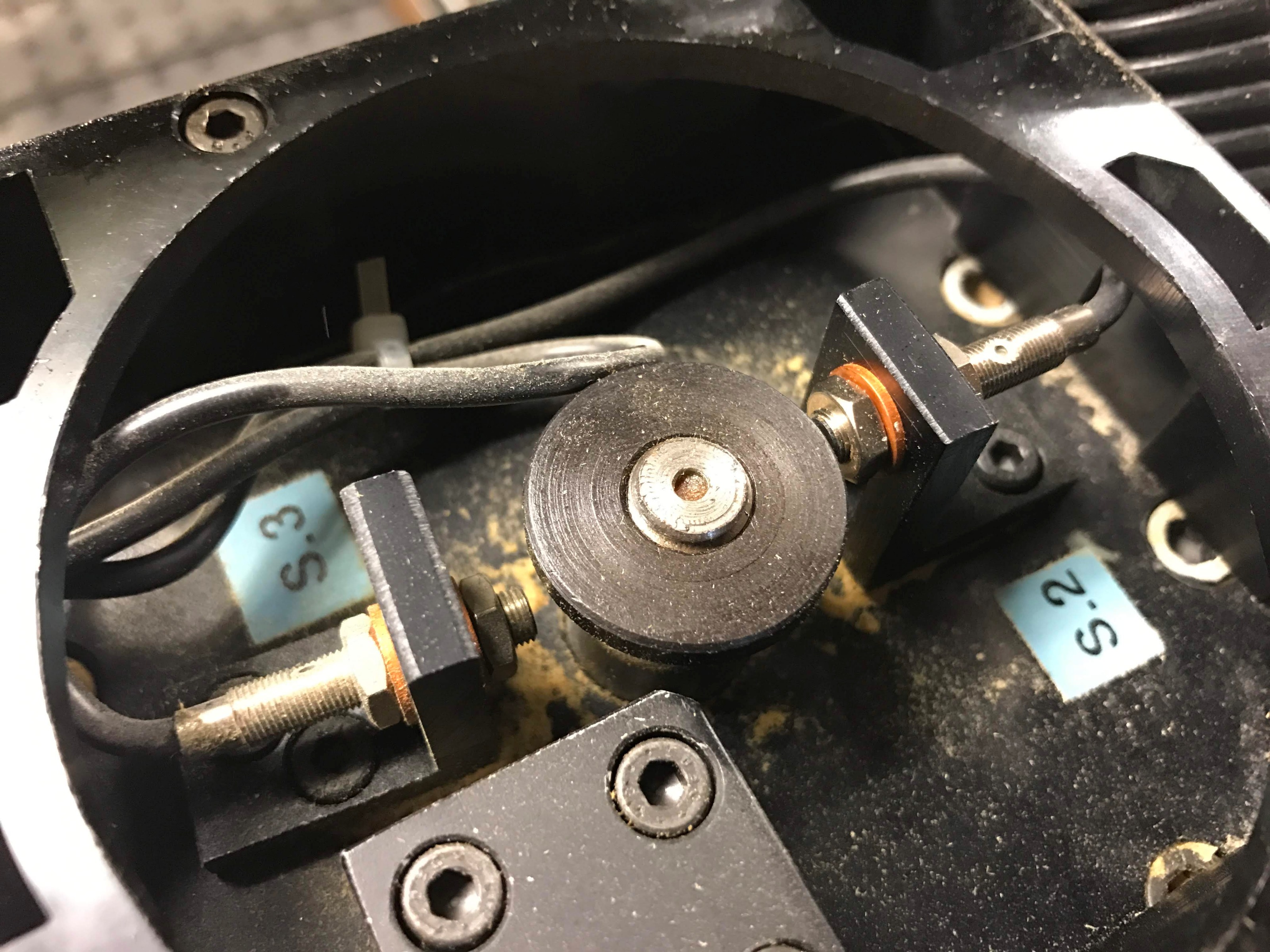

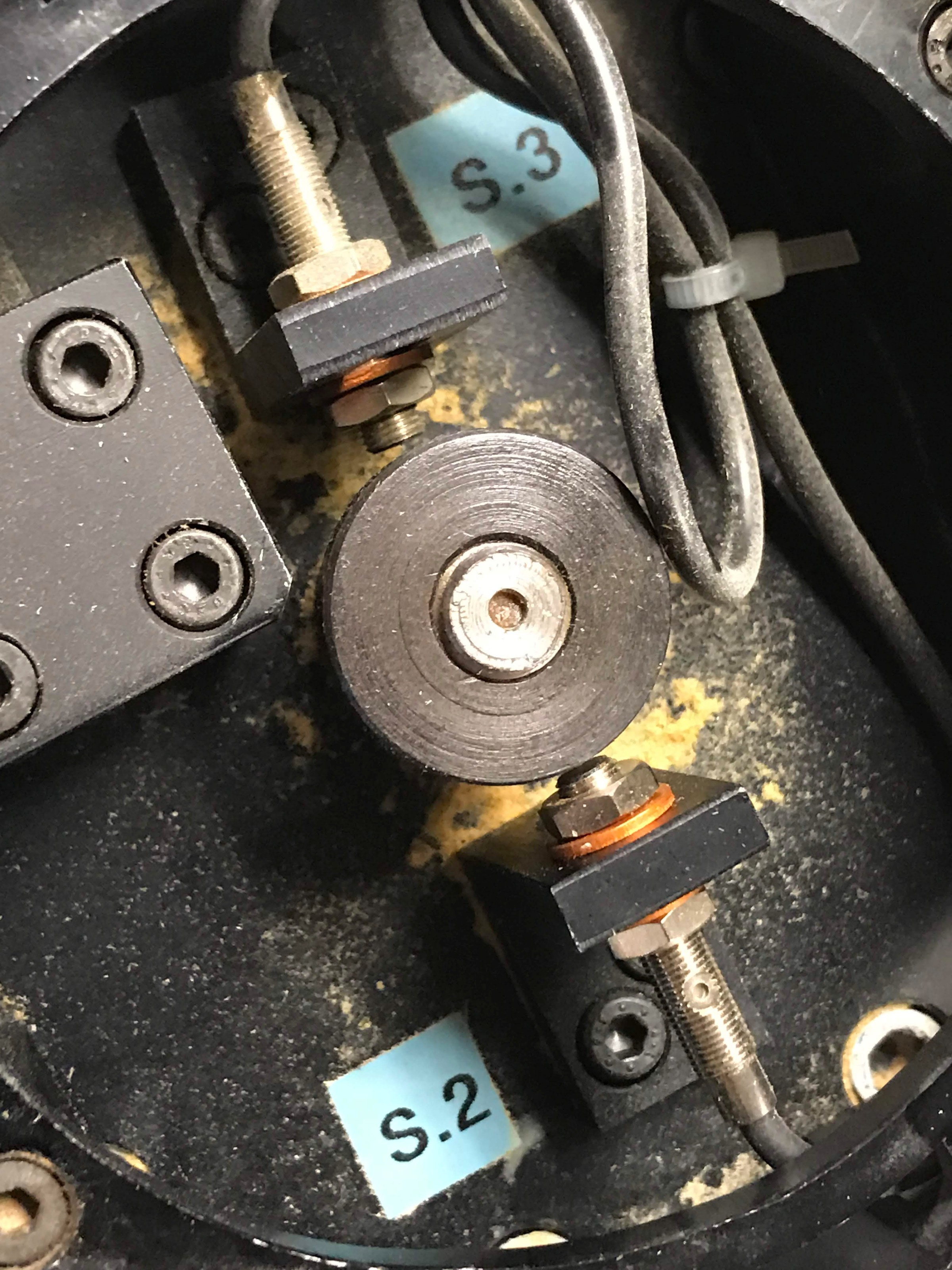

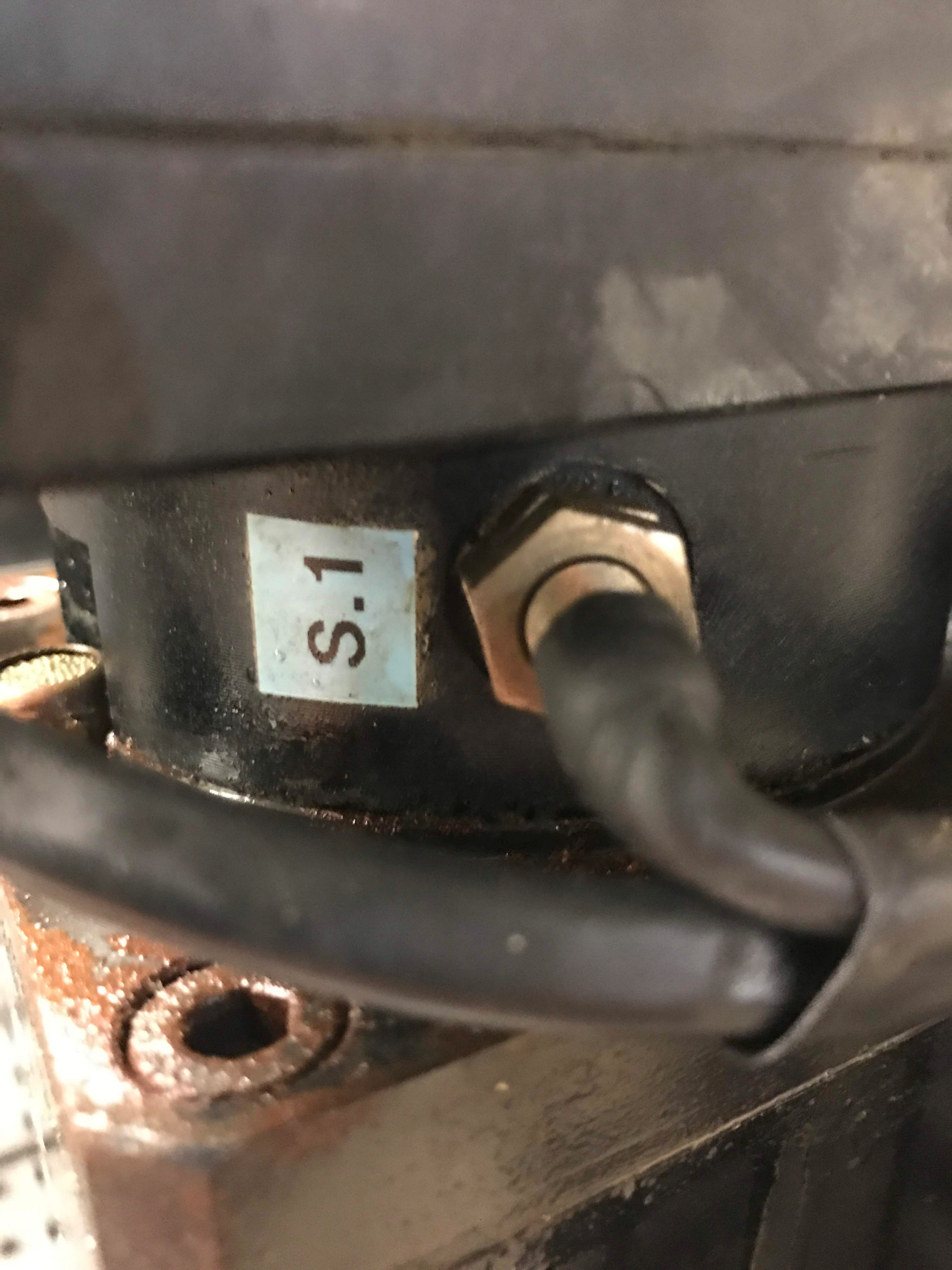

As always thanks for all the help from the forum, clearly I couldn't have done this without you guys.
Been reading about Tool Changers on the forum and the various ways to accomplish this.
Sounds like G-code remap is the easiest method for using a tool changer with a rack system?
I checked out this demo:
sim->axis->remap->racktoolchanger
Would I be able to check my sensors with this method?
Here is some psuedo code I came up when I first started thinking about a tool changer:
probably not even close to the correct ideology.
Couldn't find much info on these proximity sensors, I am guessing I would apply my 12V field power to one leg and would normally closed, open when it was active? Anyone got any experience with these colombo sensors. Also having a hard time tracking down the wires, since they appear to be sealed and then shrink tubed so I might have to remove some of the insulation to track down the wire going into my controller.
photos.app.goo.gl/KLZ2nPuCTjw1sw4r9
photos.app.goo.gl/owjzTMWsv3HBuu6U9
**place tool**
z up to high position (max) - clear work piece/table
x-y to proper position in front of rack (in line of clamps)
z down to proper height in front of rack clamp
make sure spindle is stopped sensor 1
x into tool clamp - sliding tool holder into clamp
solenoid on to release tool holder
make sure S3 active S2 not active
z up to clear tool tool holders
solenoid off
make sure S2 active S3 not active
x back to front of rack
**pickup tool**
x over tool holder
z down to place tool
solenoid off
x back to front of rack sliding tool off clamp
z up to high positionprobably not even close to the correct ideology.
