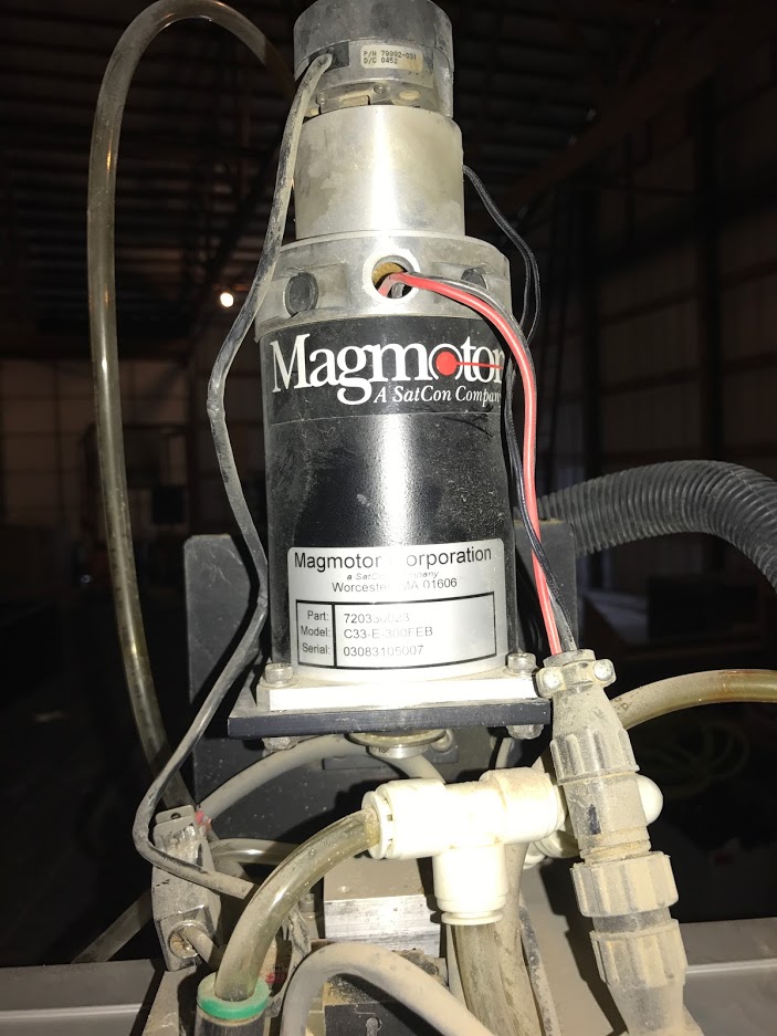

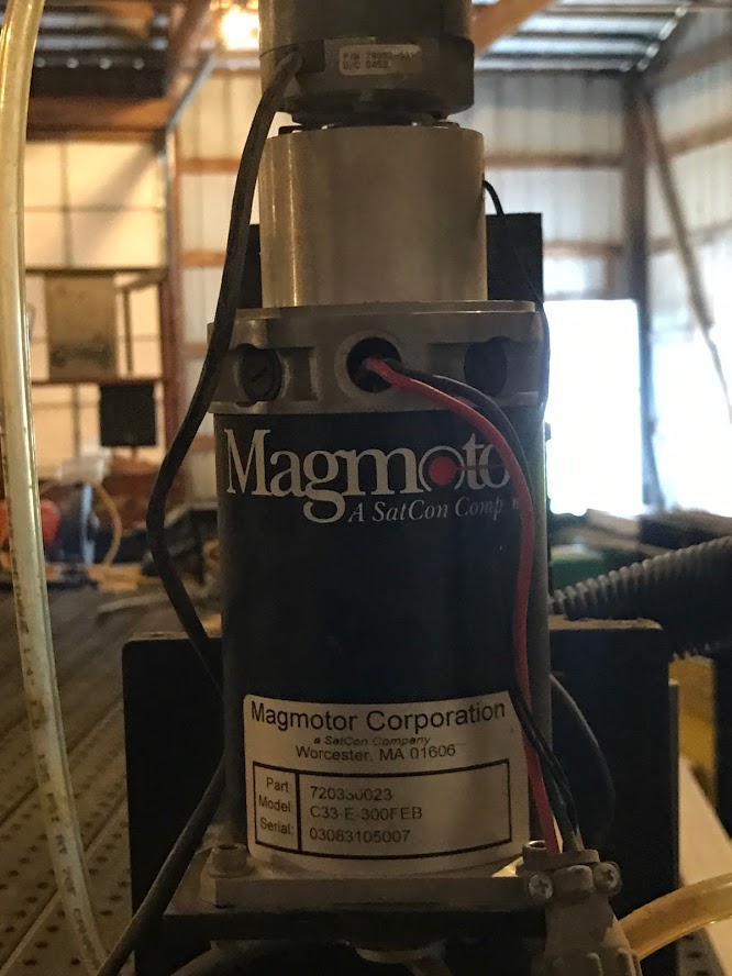

14 May 2019 12:59 - 01 Mar 2020 22:00 #133739
by randypetersen
Replied by randypetersen on topic Retrofit of Precix 5x10 CNC
Last edit: 01 Mar 2020 22:00 by randypetersen.

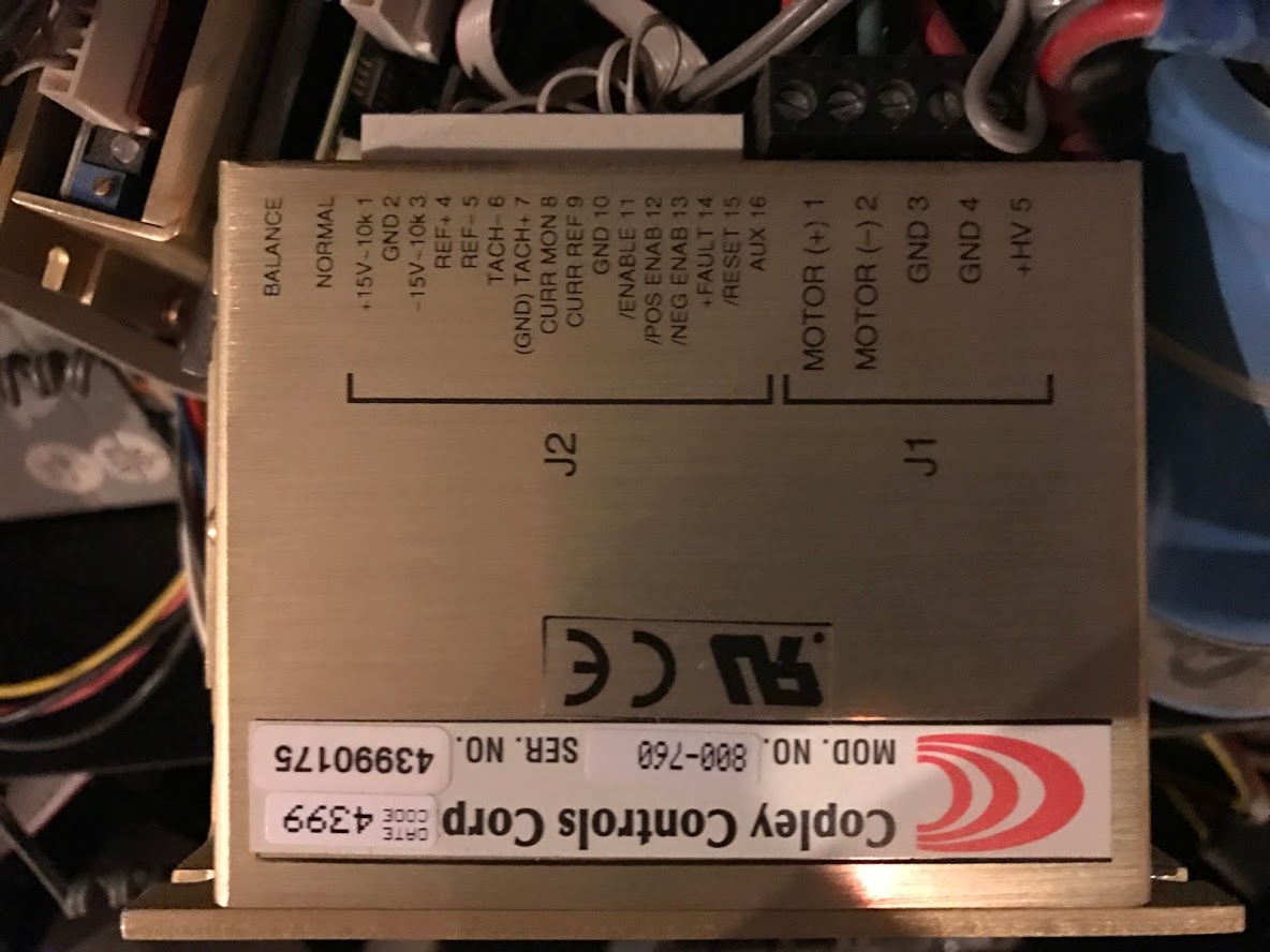

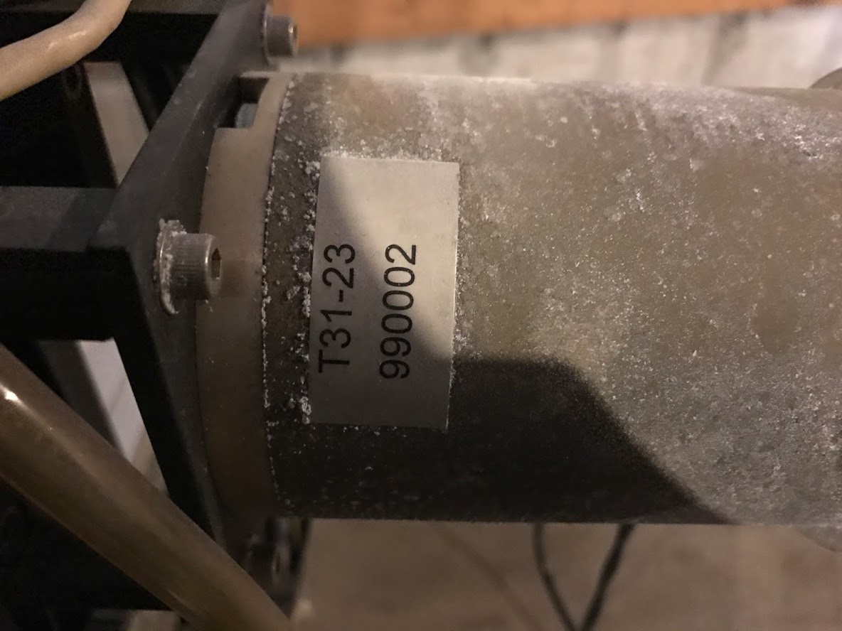

14 May 2019 13:01 #133740
by randypetersen

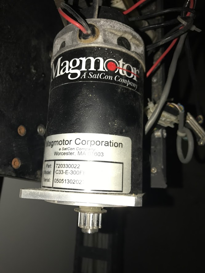

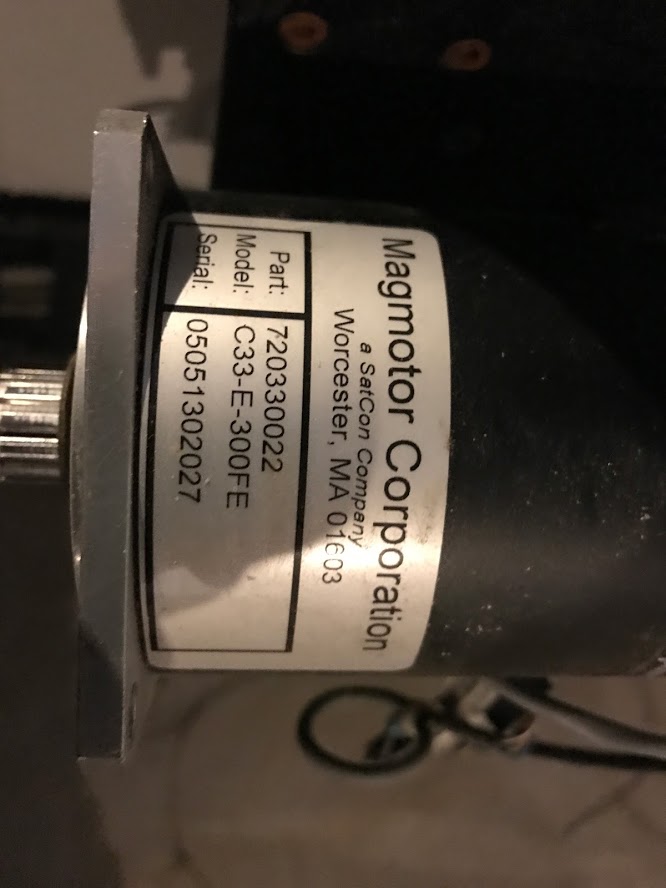

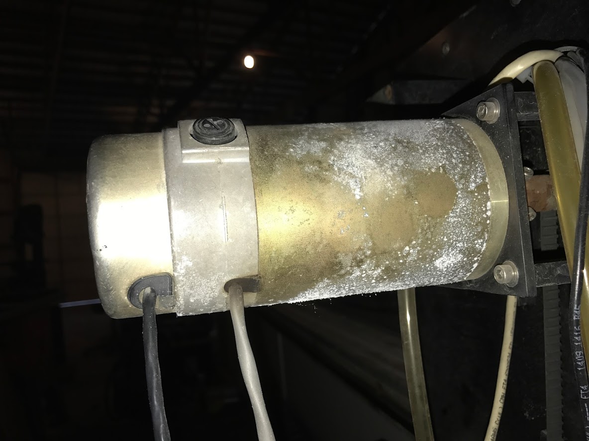

14 May 2019 13:21 - 14 May 2019 13:49 #133744
by randypetersen

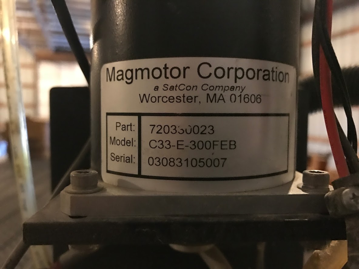

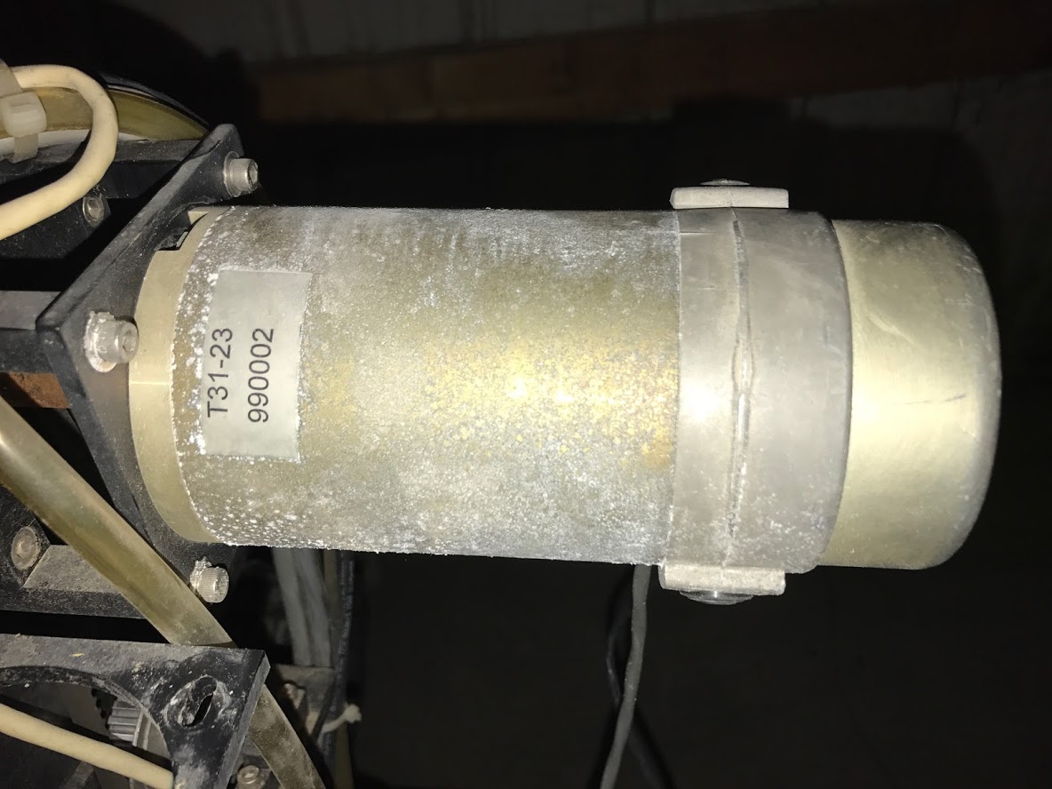

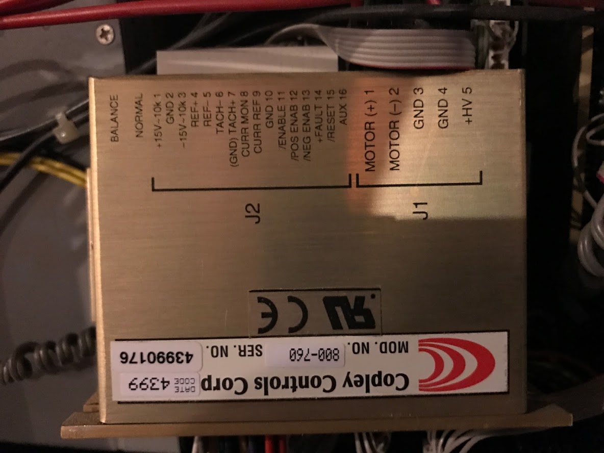

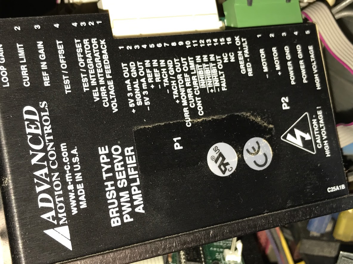

So my question now is, should I try to use these driver boards or should I change them up? Should I try to use these motors or change them up. If one of these motors dies (or is already dead afaik) would it be easy to find a replacement to use with this setup?
I couldn't seem to find an exact match for these motors online, so I would have to find a compatible motor. I guess what I am saying is, it would be nice to be able to order a replacement piece (motor/driver/controller) without having to change out anything else in the future.
PCW, do you think the 7I92 + 7i77 setup will work with this equipment?
Thanks for all the help thus far and thanks in advance for any info, I really appreciate this community for helping me get this machine up and running!
Last edit: 14 May 2019 13:49 by randypetersen. Reason: poor spelling/grammar.
- Posts: 18109
- Thank you received: 5329
14 May 2019 14:11 #133751
Replied by PCW on topic Retrofit of Precix 5x10 CNC
OK , those are standard analog drives as suspected, so a 7I77 should work fine
I would test the motors before making any judgements
(disconnect motors from drives and linear axis and apply say 5V to the MOTOR+ and MOTOR- leads)
