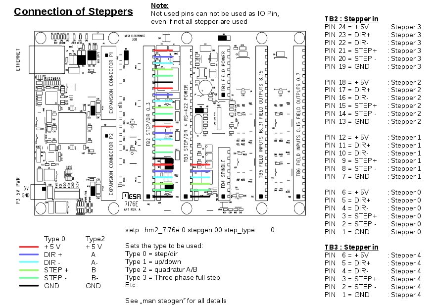

Ive hooked the steppers up according to a diagram Norbert posted in this thread, extract posted below to make it easier to see for this case. forum.linuxcnc.org/27-driver-boards/3191...ection-sheet?start=0 . My previous stepper wiring had 5v connected to ena+ dir+ and step+ permanently but I wanted ena to be under the control of the card rather than hardwired as previous as 7i76 has facility for this. When I power up the 70v dc rail for my steppers, they lock (as they should), so I think that indicates that the power side is wired and ok.
attached a tar of my config directory, currently I can see the limit switches wiring on the 7i76 pins and in the gui (and it stops when estop or a limit switch is it, home responds to home etc). The mpg I have wired in to the first encoder as I currently have no spindle encoder, and when its moved I see signals jitter on pins (but the axis doesn't move, last digit of axis position display jitters when mpg rotated & something sets the position back to the original value when its jogged via mpg and no movement of the stepper happens, mentioning this in case its related). I haven't done spindle setup yet.
I've tried massive values in DIRSETUP, DIRHOLD, STEPLEN and STEPSPACE in the ini file after some suggestions on irc, but apart from triggering a warning when starting Axis gui that I'd exceeded max values and they had been set to maximum values possible, no change. The files were originally created with pncconf but I'm quite happy to hand edit things to tweak.
My 7i76 setup is I have a external 24v psu feeding the field power, and use 5v pass through from the 5i25. Both the power leds are lit on the 7i76. I've verified that 5v is at the en+ referenced to the gnd when the axis is enabled.
Any ideas? I've been going round in circles trying to work this out for myself already, I can move/jog/home a machine axis in the gui, but although the values change, it never actually physically moves.

1. The maximum velocities are _really_ tiny (X is 0.29 mm/second max)
is it possibly moving and not noticed?
2. Are you certain about how enable works?
3. Did you try single ended drive?

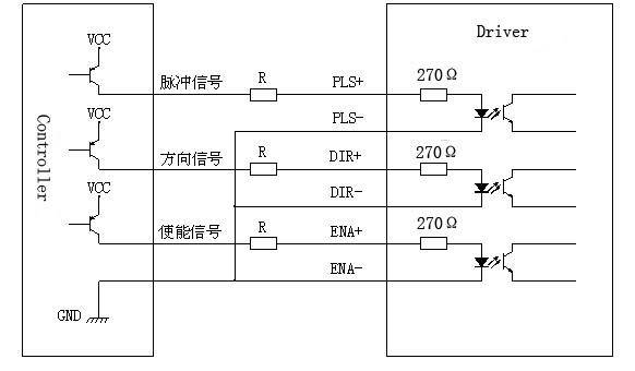

3) With parallel ports config, I had the following line setting them to step_type=0 :-
loadrt stepgen step_type=0,0,0,0,0 ctrl_type=p,p,p,p,v
longs documentation says this :-
PUL +,PUL- Pulse signal, PUL+ is the positive end of pulses input pinPUL- is the negative end of pulse input pin
DIR+,DIR- DIR signal: DIR+ is the positive end of direction input pinDIR- is the negative end of direction input pin

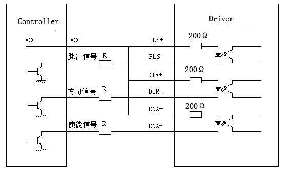

but then they show two diagrams, this one which I followed with parport setup because I switched the -ve with the pin :-
And below this one.
Right now, I have neither of these pins wired together, I've just followed the schema posted above, direct wire terminal on dm860a to wire terminal on 7i76. Should I try common'ing these pins together again?

Single ended mode refers to wiring:
single ended mode:
Also note that in almost every step motor drive I have seen, applying 5V to "ENA"
disables the drive
single ended mode:
DRIVE +PUL 7I76 +5.
DRIVE -PUL 7I76 -STEP
DRIVE +DIR 7I76 +5
DRIVE -DIR 7I76 -DIRAlso note that in almost every step motor drive I have seen, applying 5V to "ENA"
disables the drive

Well posting my hal did clear up some confusion, mine!
I've pulled the 5v connection from the ena pin on the driver and wired the 5v to +PUL and +DIR to make it single ended, and now I hear it microstepping (really slowly, as you previously suggested it would be). Thanks.
I can hammer/tune things in my config out now it actually does things.
