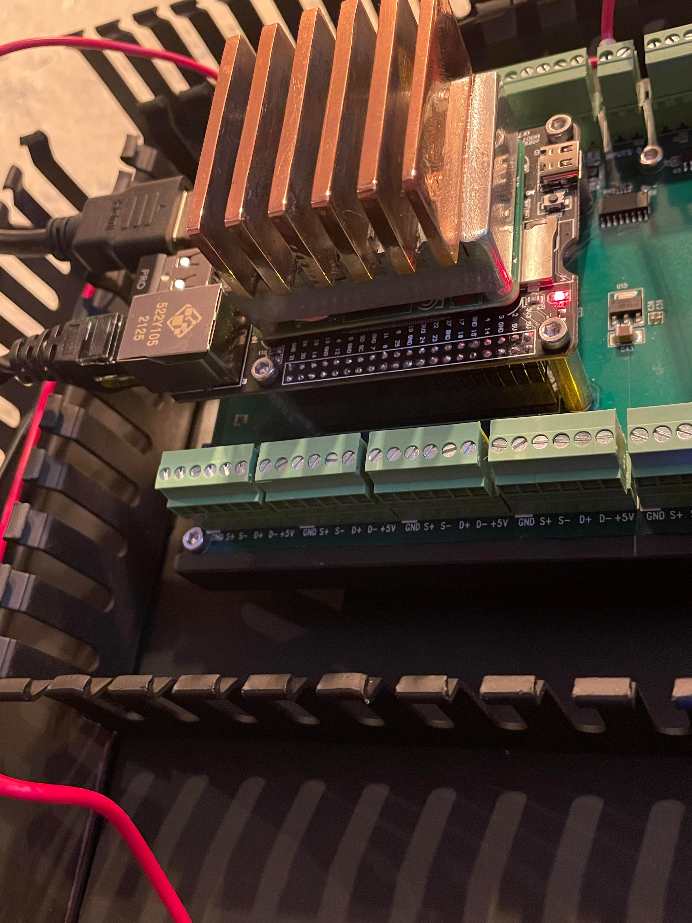

I unsoldered the male pins and solder a female header under a pitray compute module 4 carryer board at $ 20. Now the HDMI output is in the right place

03 Jan 2022 18:47 #230669
by strahlensauger
Replied by strahlensauger on topic 7c80 install on rpi 4
Do you habe a photo?
Sounds promising.
Sounds promising.

03 Jan 2022 21:52 #230687
by PHILCOAST
Replied by PHILCOAST on topic 7c80 install on rpi 4
The following user(s) said Thank You: strahlensauger
