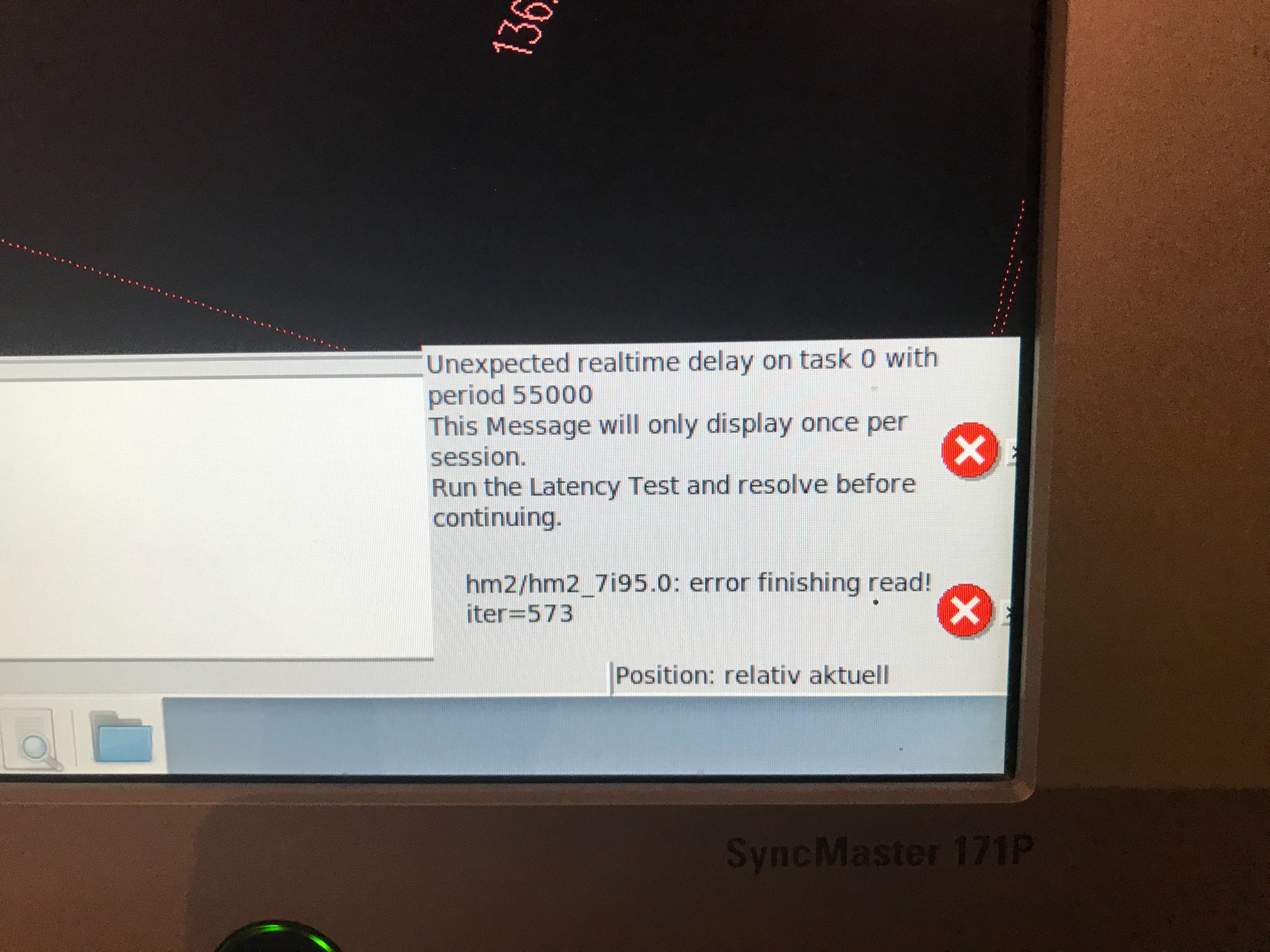

o.k. the the CR19 lights RED (on) .
Whats happens ? What mußt i do?
- Posts: 18122
- Thank you received: 5337
19 Nov 2020 15:57 #189821
Replied by PCW on topic 7i95 installing
That is expected if linuxcnc was running and has exited (it indicates a watchdog bite)

- Achim1966
- Posts: 10
19 Nov 2020 16:27 #189827
by Achim1966
Replied by Achim1966 on topic 7i95 installing
- Posts: 18122
19 Nov 2020 16:32 #189829
The servo thread period should be left at its default 1000000 ns

19 Nov 2020 16:42 #189830
by Achim1966
OK . how and where can I change that? You cannot use the pncconf wizard. which crashes
- 0x2102
- Posts: 223
- Thank you received: 88
19 Nov 2020 16:50 #189831
by 0x2102
Replied by 0x2102 on topic 7i95 installing
In your machine.ini
[EMCMOT]
SERVO_PERIOD = 1000000
[EMCMOT]
