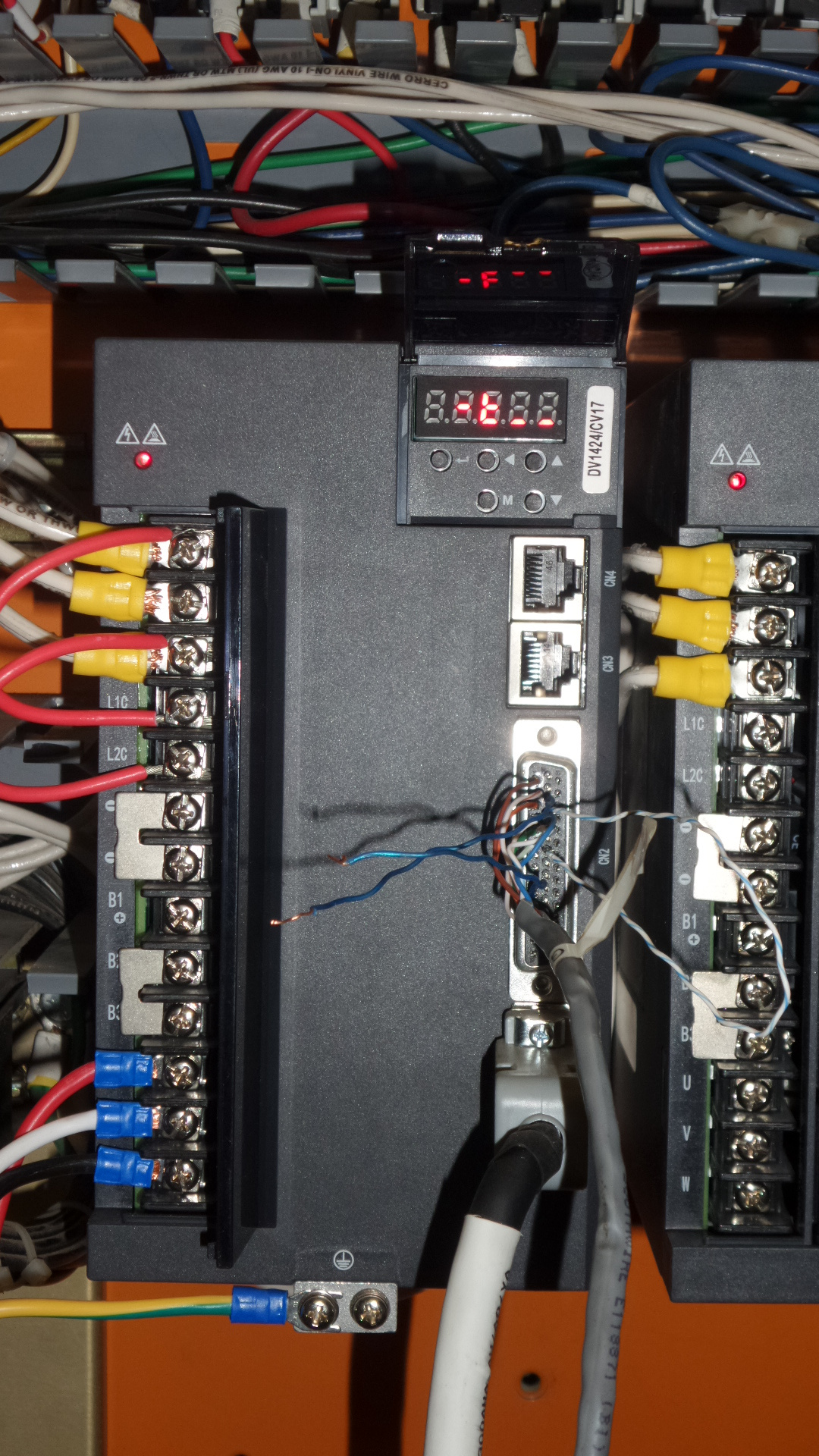

Also I am attaching a pic of the Fn-26 Status state. If you look at the last digit the bar is low instead of high indicating the drive is disabled. I was only able to get it to enable once fooling with the P0-06 settings but it soon reverted for some reason.

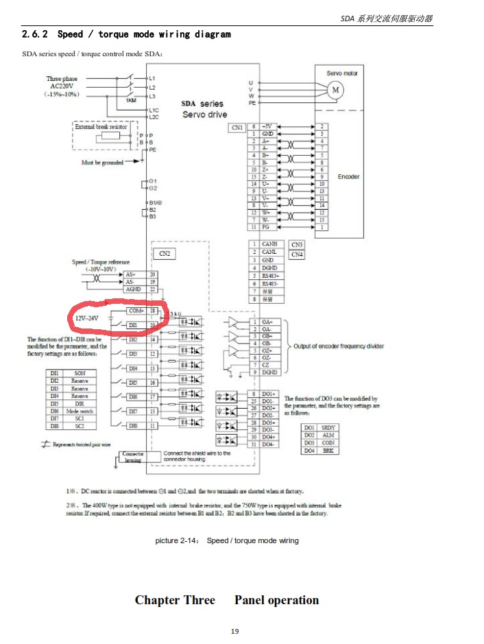

So, you have an external 24V power supply with the +24V connected to terminal 18 and the 0V to terminal 10?

first digit on the display is "-" so there seems to be no active alarm.

I have tried it with or without DI1 being high or low. I am connecting DI1(terminal number 10) to COM+(terminal number 18) to accomplish this.See pic

That is not correct. There needs to be a power supply (12-24V) between DI1 and COM1 with the positive connection to COM+ and the negative to DI1 as indicated on the schematic.
Replied by Aciera on topic Need Help! New Chinese AC Servo Drive SDA-No movement with+-10VDC Dif Analog In

I supplied 24VDC from an external power supply to terminals 10 and 18 and changed P0-06 to H000 and walla the drive is enabled.
