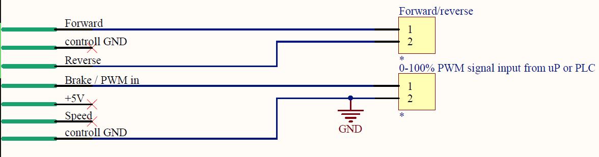

Hello
I have installed xilinx ise 14.7 and i want a PIN file for 7i80hd + 7i33 + 7i37 + 7i84
For 7i33 the pwm output must be like this in the photo because dc motor driver accepts that type of pwm
My problem is that i want 2 outputs for direction forward & reverse not only 1 direction.
Also for connecting 7i84 to 7i80hd i have this adapter www.aliexpress.com/item/4000542156362.html
Can someone help me with pin file ?
I have this pin file but does not outputs the forward-reverse signals in the form shown in the photo

I think that pwmgen only knows how to output PWM, DIR and ENA
github.com/LinuxCNC/linuxcnc/blob/master...hostmot2/pins.c#L108
If you need FWD REV outputs then I think that you will need to do that in HAL.
What I would suggest is setting the 82 and 83 pins in your VHDL to nulltag. I _think_ that will then leave them as GPIO pins, physically on the PWM header, and you can then drive then as FWD REV using HAL logic.

If you want FWD and REV PWM, that would be PWM mode 2
In mode 2 the PWM magnitude signal is directed to the OUT1 pin for positive values
and the OUT2 pin for negative values.

I think that he wants a single PWM pin and separate FWD and REV pins?
(And, presumably, neither set for off?)

OK in that case GPIO would be the way to go for FWD/REV

I want 1 pin for pwm 1 pin for forward and 1 pin for reverse.
How can i do that in 7i80 + 7i33 ?
Some solution with 7400 series chips to modify the output of 7i33 ?

The 7I33 is an analog servo interface, it's not suitable for PWM output
What is the PWM frequency?

The pdf is the datasheet of dc motor driver
Except from pwm driving this driver has an other mode where
0V input is full rpm reverse 5V is full rpm forward 2.5V is 0 rpm and so on..
Can make a config 7i33 to output in that way voltages not -10 to 10 but 0 to 5 or make an external circuit to do that ?
Can i use this mode ?
Brake/PWM input:
• Potentiometer or throttle mode: brake switch input.
• PWM mode1: 0-100% PWM: You can use your own PWM control signal from your PLC or
microprocessor. The minimum controll PWM frequency is 100Hz. The step resolution 1us. The
acceptable voltage level: 3,3-10V.
• PWM mode2: RC wirelles receiver input 1,5msec pulse for the 0% duty cycle and 2,5msec pulse for
the 97% duty cycle.
• PWM, logical and pulse counter input in USART mode
Last edit: 09 Jul 2021 23:59 by vre.
Yes, you could use the offset PWM mode and bound the PID output to 2.5

how to do that setting?
setp [HMOT](CARD0).pwmgen.00.offset-mode 1
setp pid.x.maxoutput 5.0
For pid tuning brushed dc motor that parameters of pid need tuning ?
