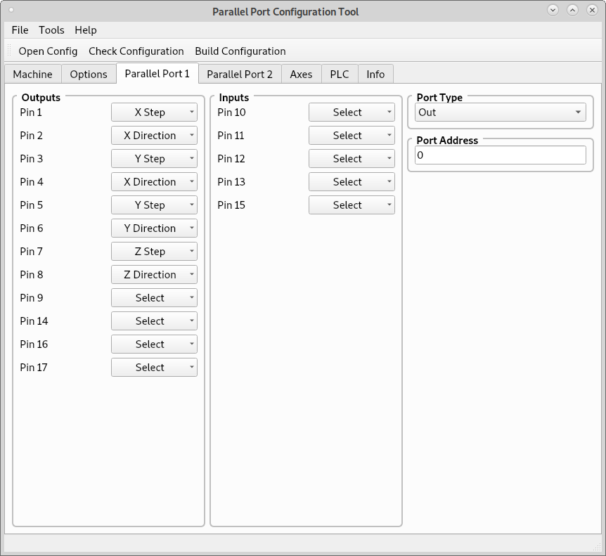

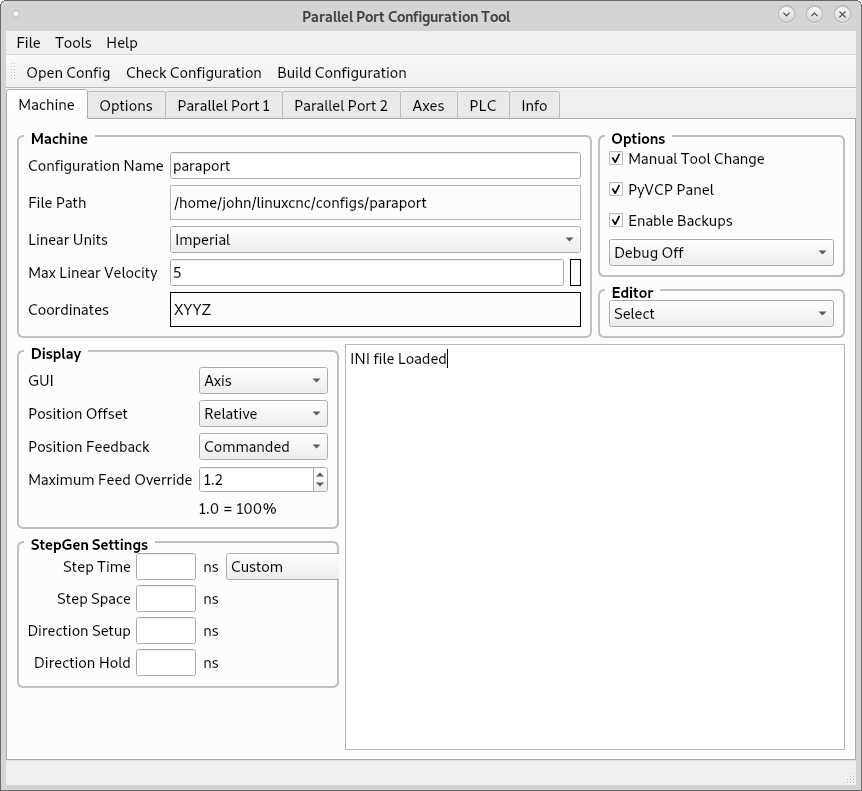

I'm at the very beginning of coding the Parallel Port Configuration tool and looking for feedback on the basic interface. I've worked out some new Python and PyQt5 code to make the interface slicker and easier to use. If you want a sneak peek and have a few minutes to try the various things... note it does not make a configuration yet, still working on the basic GUI design.
gnipsel.com/mesa/paraport/
JT
JT

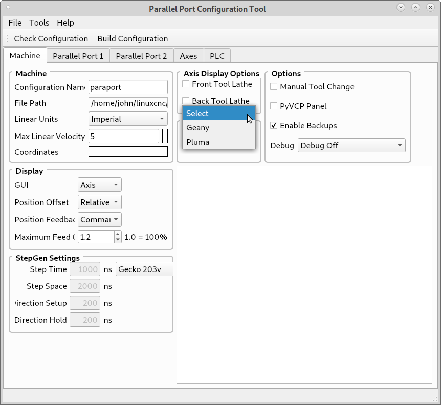

I noticed that stepconf adds gedit as the editor even if it is not installed which silently fails. So what I did was to check to see what editors are installed and give the user a choice of editor.
If I missed any please let me know so I can add them to the list.
JT
editors = {'Gedit':'gedit', 'Geany':'geany', 'Pyroom':'pyroom',
'Pluma':'pluma', 'Scite':'scite', 'Kwrite':'kwrite',
'Kate':'kate', 'Mousepad':'mousepad', 'Jedit':'jedit'}If I missed any please let me know so I can add them to the list.
JT

Replied by tommylight on topic Parallel Port Configuration Tool
XED on Mint Mate.

Thanks, I'll add that to the dictionary, I assume the command is xed?
JT

Yes it is.

-Missing "amplifier enable" from the outputs/IO control menu.
-Axis setup empty after setting axis pins.

Thanks, I'll add amplifier enable to the outputs. I've not started on the axes tabs yet.
Thanks for testing.
