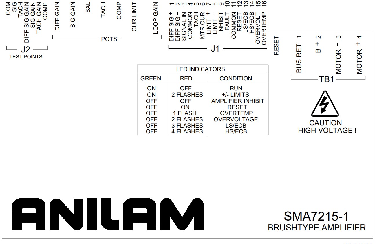

Do you know what the pin was on yours that you had to enable?

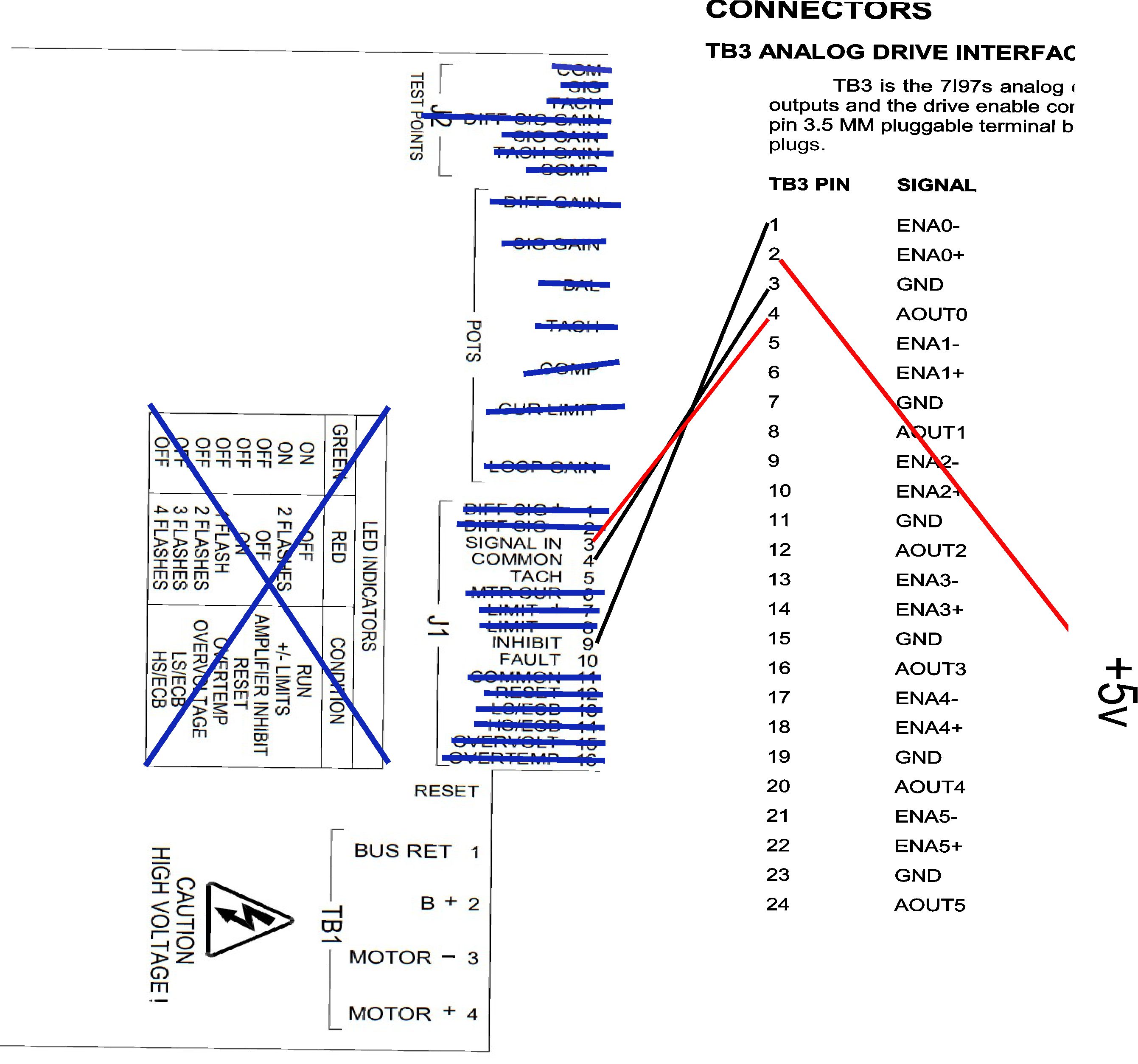

My guess is pin 9 on J1, do you have a photo of your drive?

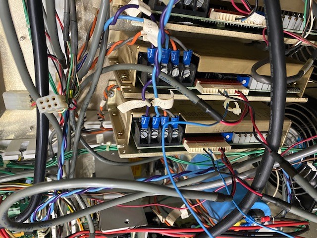

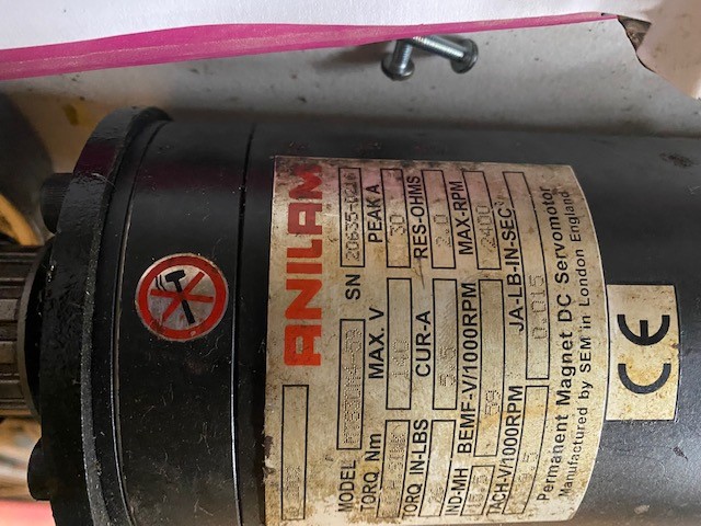

By drive do you mean my amplifier?

- BigJohnT
- Posts: 3981
- Thank you received: 994
05 Feb 2022 07:04 - 05 Feb 2022 07:06 #234020
by BigJohnT
Replied by BigJohnT on topic Anilam with 7i97
Those are different servo drives than mine. The inhibit pin sounds like it inhibits the drive not enables the drive.

oh, well I guess I was assuming the inhibit was just another word for enable. Im guessing that inhibit is something that has to happen along with enabling maybe? Also I have my encoders set up single and because I thought that is how the amplifier had it but I read that my amp can be used for differential as well. Do you suppose that it matters much whether I run my stuff single or differential ended?

Differential is the best for electrical noise for sure.
If you disconnect the inhibit does the drive take control of the servo?
