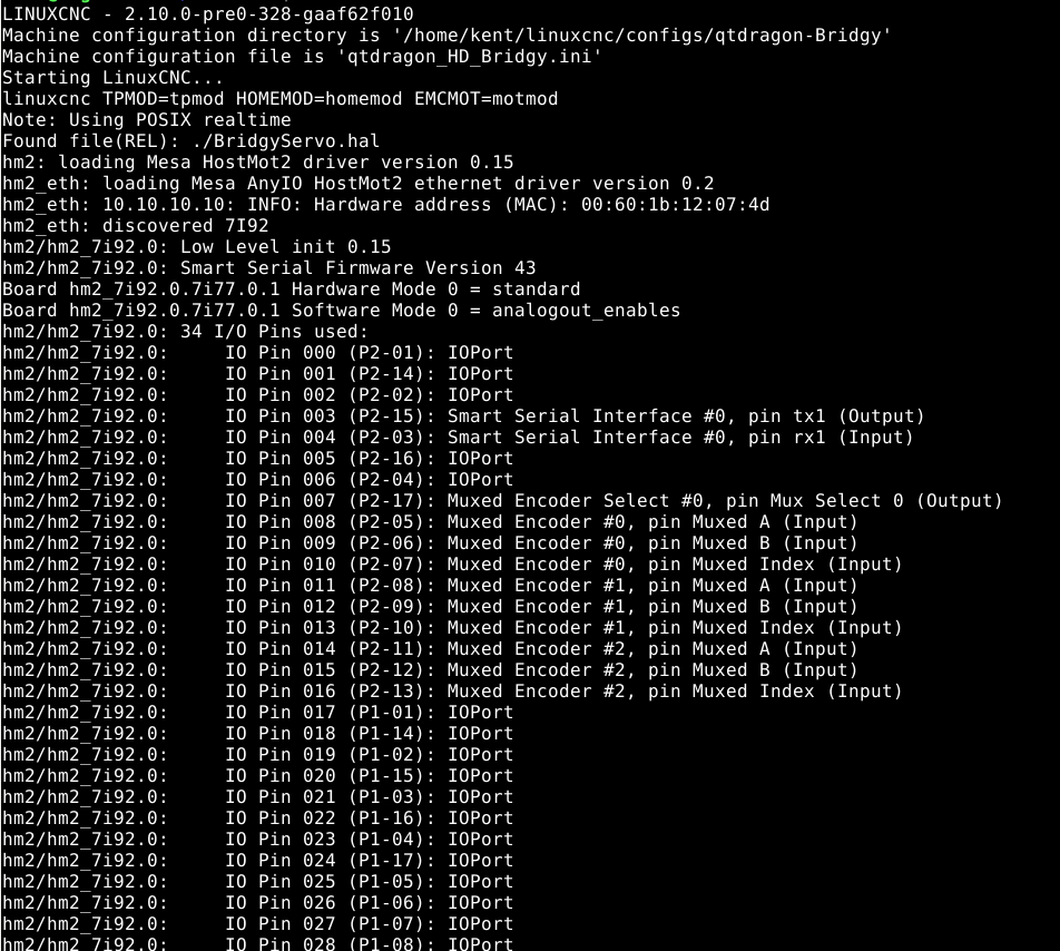

21 Dec 2022 21:59 - 21 Dec 2022 22:04 #260040
by turbostew
Replied by turbostew on topic 7i77 Mode 3 coding in HAL file
I am also having issues with this 7i92-7i77. I do not see the hm2_7i92.0.7i77.0.0.enc0/hm2_7i92.0.7i77.0.0.enc1 signals in mode 3. I see no difference in halcmd show between "port_0=000xxx" and "port_0=200xxx and port_0=300xxx.
I enabled like this:
loadrt hm2_eth board_ip="10.10.10.10" config=" num_encoders=6 num_pwmgens=0 num_stepgens=0 sserial_port_0=300xxx"
I loaded most recent 7i92_7i77x2.bit into 7i92.
BTW, what is "7i92_7i77x1pktd.bit" for?
Ideas?????
Ideas?????

- Posts: 18103
- Thank you received: 5326
21 Dec 2022 23:47 - 21 Dec 2022 23:49 #260051
Replied by PCW on topic 7i77 Mode 3 coding in HAL file
Yep, only the analog side is working because there's no field power
With field power, you should get something like this on startup:
Last edit: 21 Dec 2022 23:49 by PCW.

21 Dec 2022 23:47 #260052
by turbostew
Thanks Peter! All is right with the world now....
