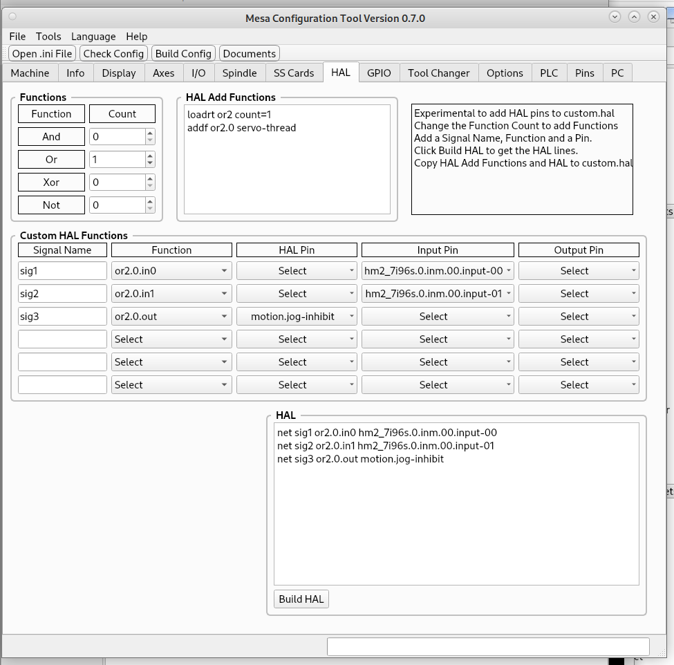

I'm working on adding a way to build custom HAL code. It's a WIP...
