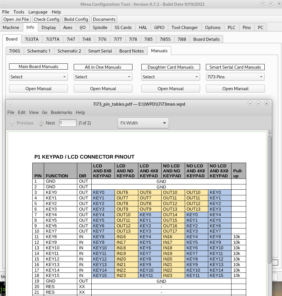

Sorry to drift a bit away from the original topic, but this fits here also I think.
I made an overview of the pin names in the different modes and I would like to include it somewhere in the LinuxCNC docs.
Peter, can you have a quick look at this if it looks reasonable for you? Thanks!
I'd like to add this to the Mesa Configuration Tool.

Yes that will be great!

Ok here one version coloured and one in b/w.
