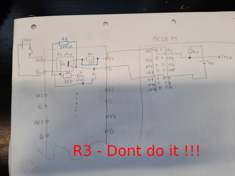

I have problem. I made breaking for P1 EXPANSION CONNECTOR. I need only inputs.
This is schema:
This dont working. First problem was rezistor R2. I clamped it. But after that it still didn't work well. So I increased the current for the diode on the optocoupler. After that it started working properly.
When I showed off these modifications on the CZ discussion forum, I was warned that something was wrong when I needed such a large current in the optocoupler.
forum.strojirenstvi.cz/viewtopic.php?t=42356
So I disconnected the optocoupler and tried connecting pin P1 to ground via an ammeter. There should be a 4k7 Pull up resistor, so I should measure about 1 milliamp. However, I measured 15 milliamps!!!

 Can't think of what could be wrong?
20 Sep 2022 18:12 #252421 by PCW
If the 7I96S GPIO on P1 are not all high when unconnected
and with default firmware, you likely have damaged I/O pins.

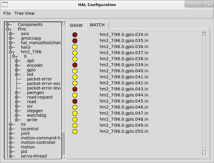

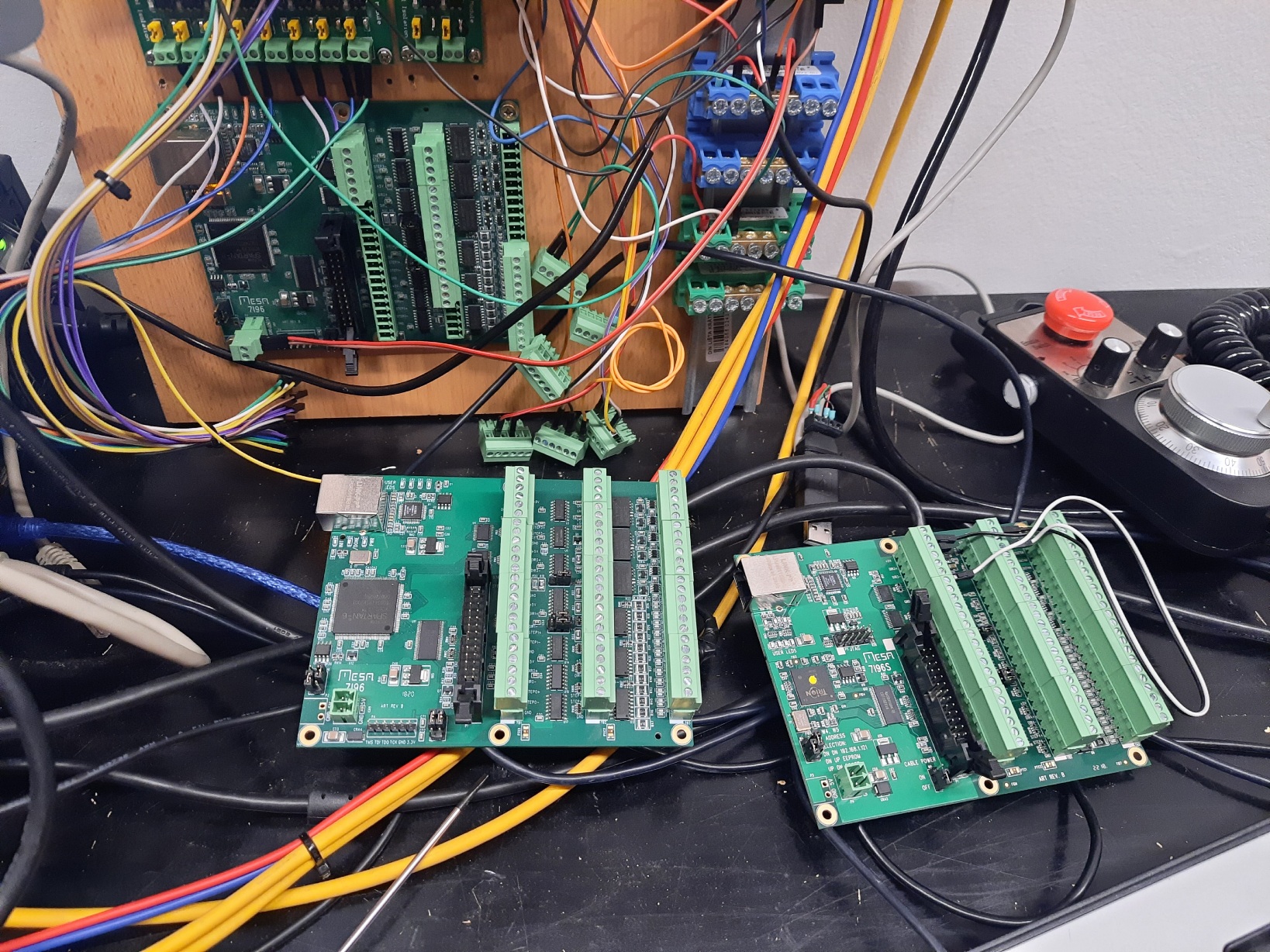

20 Sep 2022 18:21 #252423 by zz912
I have problem with old 7i96. I have all pins HIGH in defalut. All working (in picture is not default state), but I must sink it by 15 mA. I tried change firmware, and this not help.

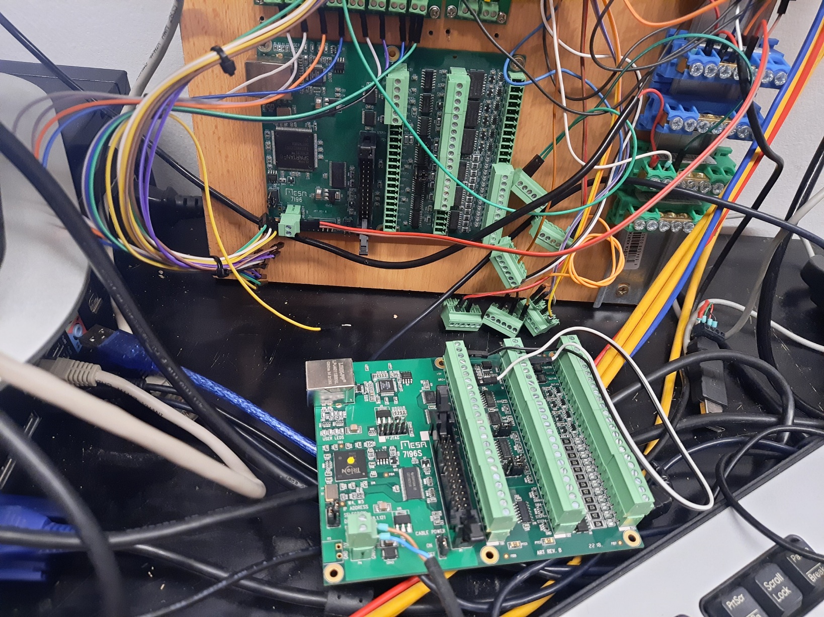

20 Sep 2022 18:32 #252424 by zz912
Sinking old 7i96 is needed 15mA.Sinking new 7i96S is needed 1mA.I measured with only connected power.
20 Sep 2022 18:33 #252425 by PCW
Pretty strange, does sound like damage.
Do all pins have 15 mA sink current?
  • zz912
  • zz912's Avatar Topic Author
  • Offline
  • Platinum Member
  • Platinum Member
20 Sep 2022 18:47 #252429 by zz912
I thought all the pins were the same. So I did all the measurements on the IO50 pin on the 7i96 card. I have now taken measurements on all pins on both mesa.
All pins need 1mA for sink, only pin IO50 on mesa 7i96 needs 15mA. Pin IO50 on the 7i96S needs 1mA.
  • zz912
  • Offline
  • Platinum Member
  • Platinum Member
20 Sep 2022 18:57 #252430 by zz912
I found another old 7i96 and it need 16mA for sinking IO50.
20 Sep 2022 18:59 - 20 Sep 2022 19:01 #252431 by PCW
Might be an assembly error on some 7I96's (pullups on 34..49 are done with resistor networks but I/O50s pullup is a separate resistor)
Last edit: 20 Sep 2022 19:01 by PCW.
